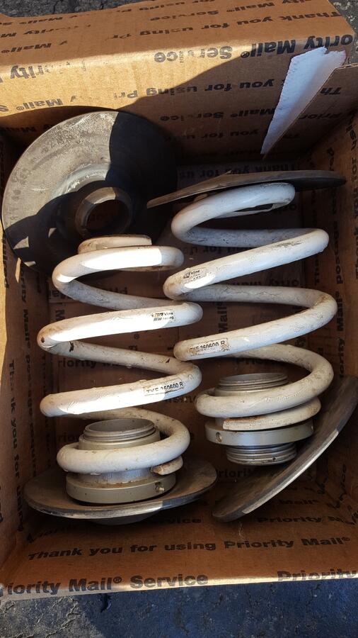

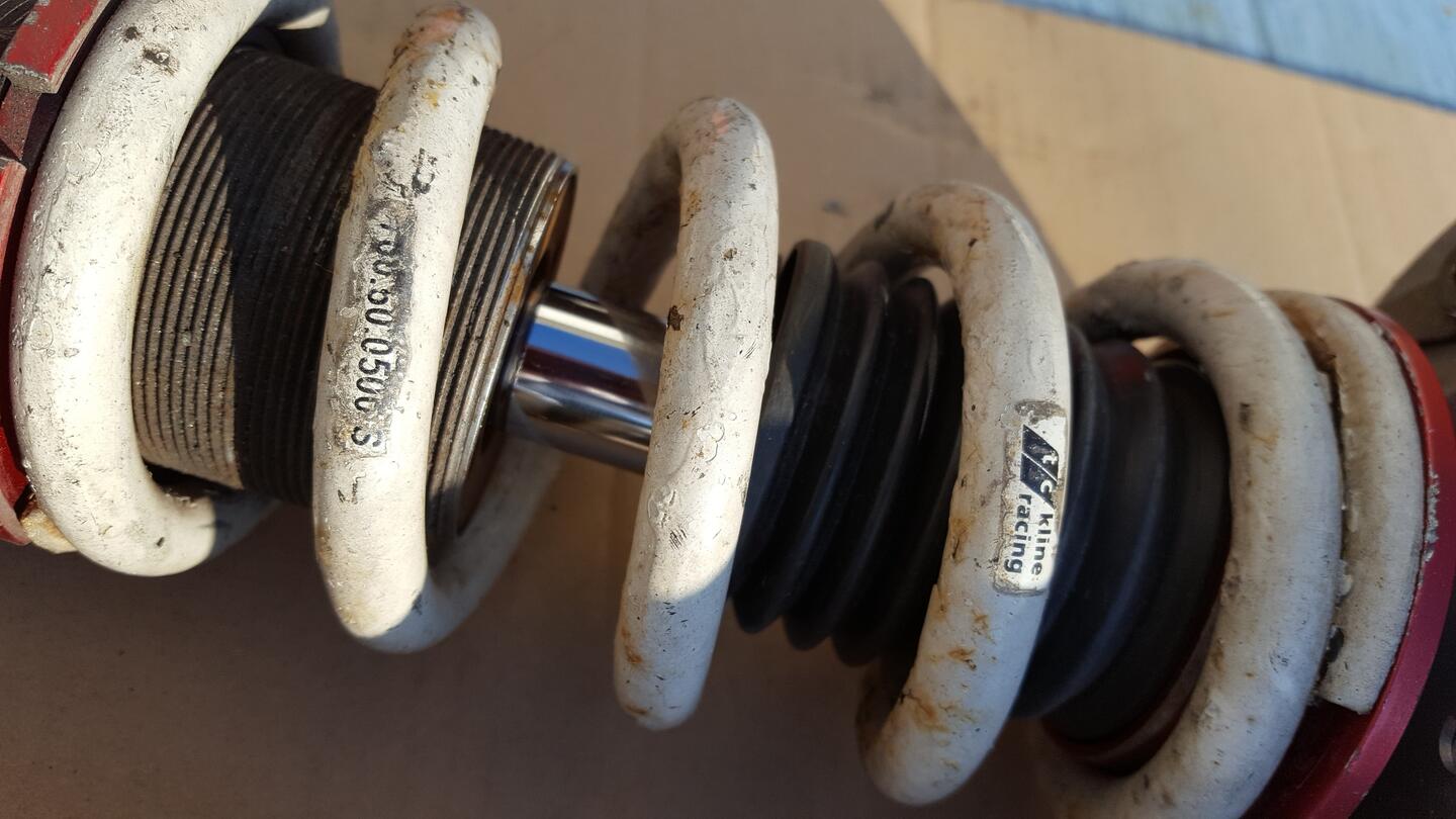

    I had TCK and their springs rust out and look like crap. I switched to Eibach, much better powder coating. I have H&R on my 911 and happy with them too. I don't think you can go wrong with either Eibach or H&R.
      Can somebody confirm the spring sizes for front and rear for my TCK SA setup should I look for 60mm fronts and 2.5” rears?
      Also l, do rears need to be barrel shaped or are straight type okay?
        I don't have the sizes as I sold my TCK but you can call them for info. The barrel shaped springs are progressive rate where the rate increases or decreases with compression.
        The cylindrical shaped springs have rates which are linear throughout their range. The front TCK were linear and the rears progressive, weird!Click image for larger version  Name:	20190204_151128_resized.jpg Views:	0 Size:	119.6 KB ID:	18312 Click image for larger version  Name:	20190204_152021_resized.jpg Views:	0 Size:	72.3 KB ID:	18313
