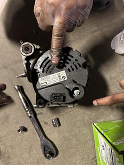

  • whoissuprme
    replied

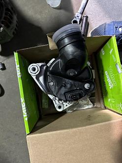

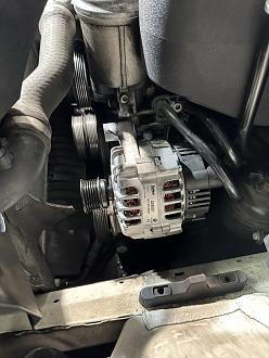

    So finally was able to tackle the x5 140a alternator install tonight with some help from a couple of buddies. Great news... It bolts right up! All you have to do is swap the back covers and you are good to go!! this seems like a great alternative.
    bigjae46
    0-60motorsports
    PSUEng
    D-O
    Here are some pictures
    This is the new 140a X5 alternator. As you can see there is a port for cooling
    Back of the OEM 120a alternator
    X5 alternator inside the engine bay with the e46 rear cover on.

  • sapote
    replied
    Originally posted by old///MFanatic View Post
    It would not be similar enough to use a 323it as a basis for average mileage was the point.
    Sorry, yes you can remove and inspect the brushes. But brushes are only one of several things that can be reason for an alternator to fail.
    OK, we're on the same page now.
    I still think short worn brushes is the root cause of most alternator failure after 100K miles. Most people just replaced the failed alternator instead of investigate the root cause. I have not seen any reports of either spun bearings, seized bearing, burnt rotor/stator coil, damaged brush slip rings, or damaged rectifier diode bridge.
