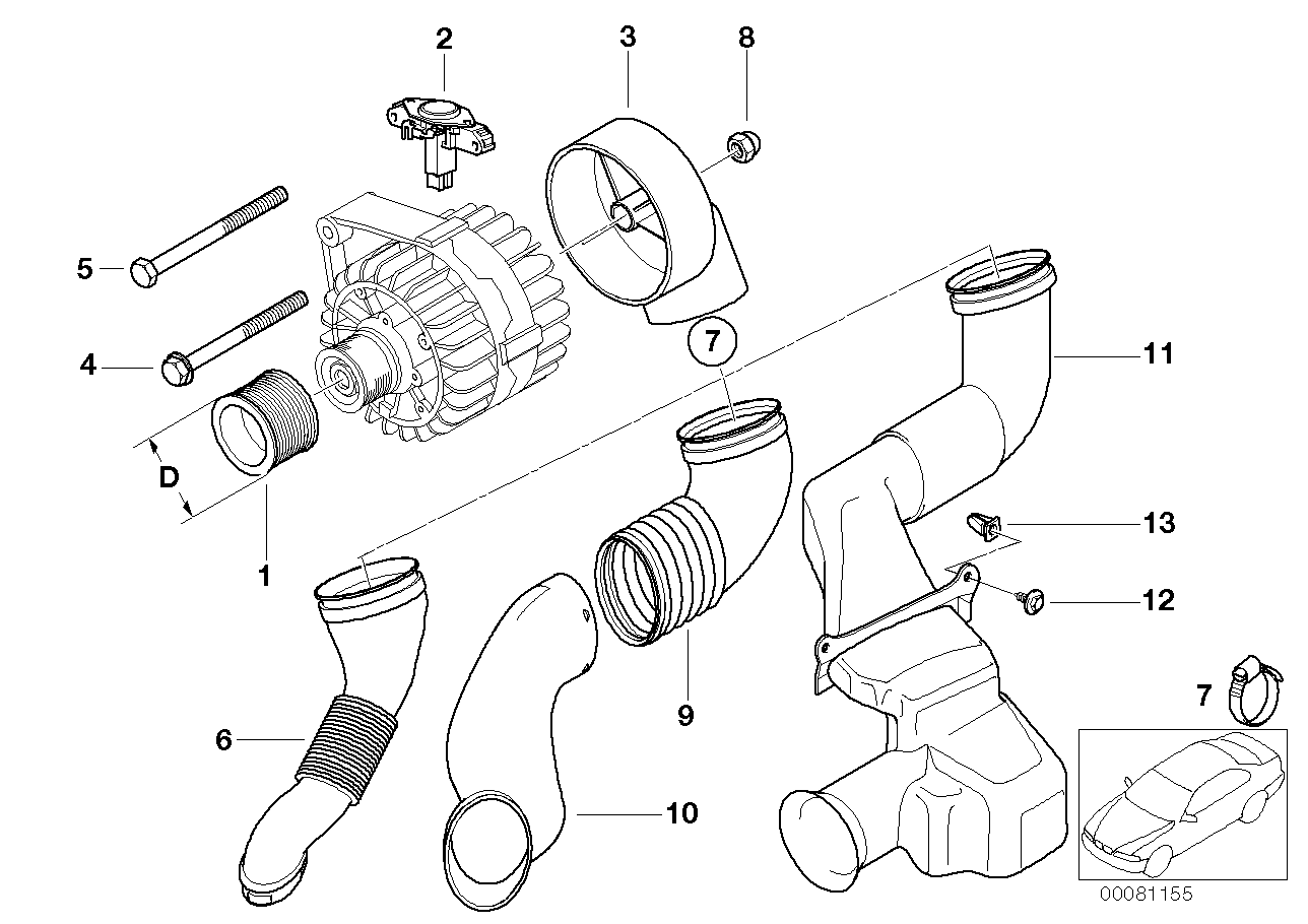

    Funny enough, the M3 has a molded intake port on the brake duct that has been blocked off. That could have been for alternator ducting.
    That’s exactly what it’s for.

    The problem might be the oil cooler lines it might interfere with the duction maybe not.

    ...That might actually be that mystery solved. I always wondered what that was for. Sure looks like the alternator ducting would fit there

    It's clearly there for making your own DIY brake ducts
    For only the driver's side? lol
    Click image for larger version  Name:	Screen Shot 2023-06-18 at 10.48.26 PM.png Views:	0 Size:	637.2 KB ID:	222386
    Leave a comment:
  • heinzboehmer
    replied
