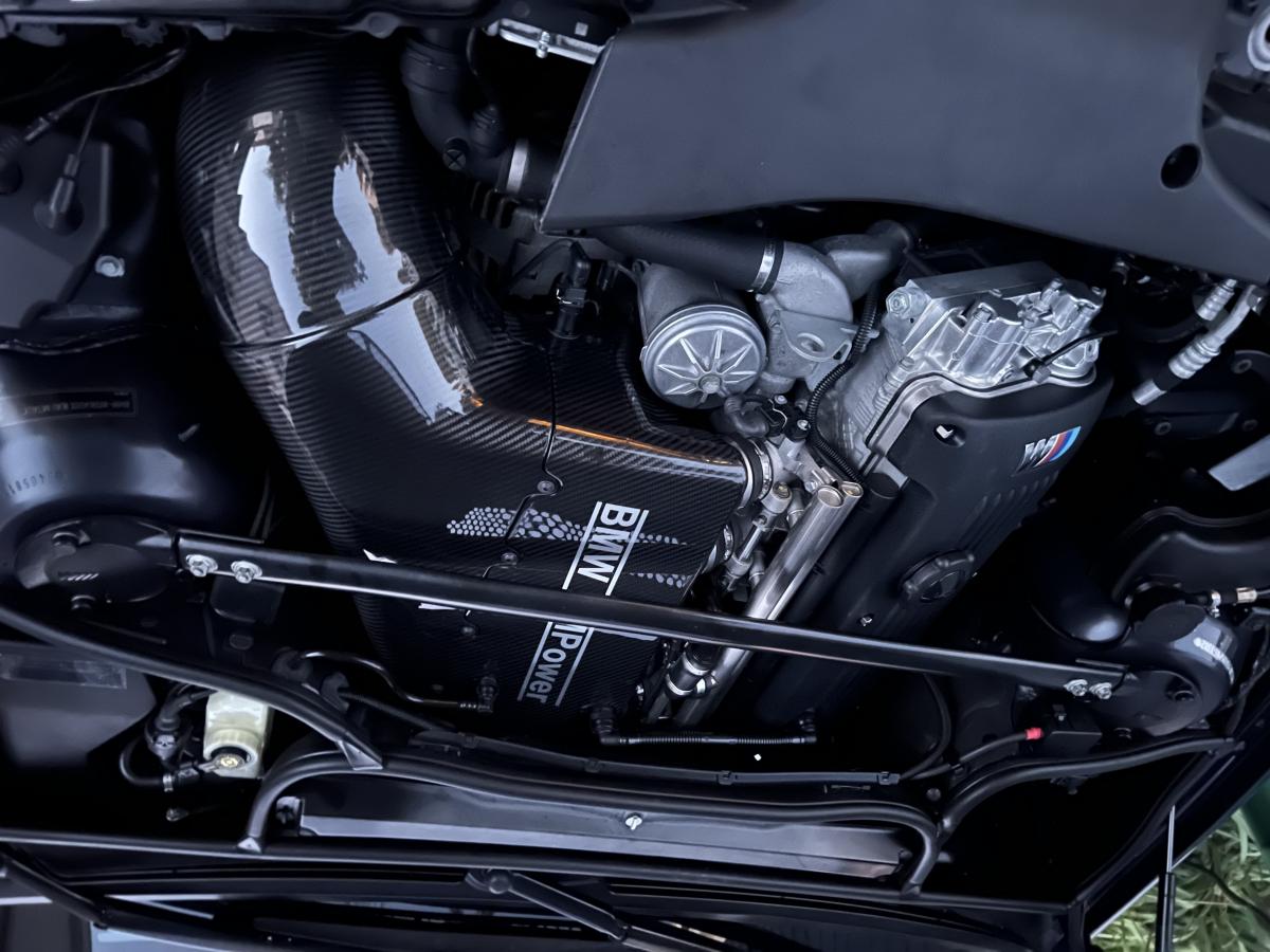

    Forgot to confirm that this latest batch of Race boxes DONT have the oval hole underneath for csl ducting.
    Feels good to be rid of it.
    edit: forum picture rotation … 🙄🙄🙄🙄🙄

            It's so perfect I couldn't get over it compared to the evolve which already was high quality.
            Good to know. Been on the fence about ordering the race vs. OEM style.
            Since I have a Vorsteiner CSL bumper waiting for install, I'm curious which option would be better? Or is trying to feed the cool air more effort than it's worth?
              Correct. Or large award of internet points for CSL authenticity.
