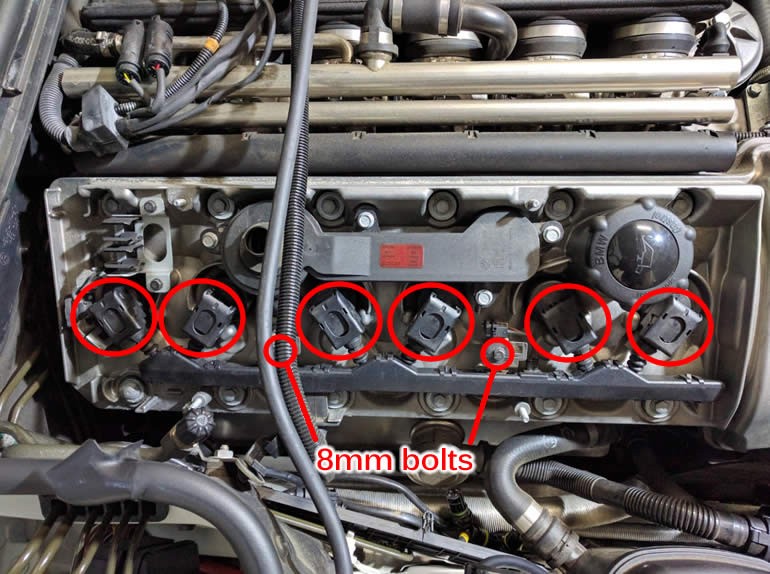

Help me identify this bolt on the S54.
    Lost one of the 8mm bolts, Have been searching REALoem for 2 hours and cant find the part number. Anyone help?

    RealOEM does not have those labeled for the harness, but they are possibly the same as the ones that hold the O2 sensor clip on the top left corner of the valve cover - 07119904442. You could check it with the one you still have.
      Concur this would also be my best guess. I think the bolts are the same.
        I could not find it either in a quick look.
        If no one else comes up with the info, I wonder if #20 is the same size. You could try it from the other spot and see if it infact fits. If so you then have the part number. Good luck.
