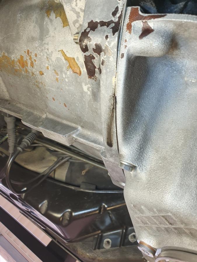

                        is this what a front seal leak looks like ?
                        i looked inside the holes with a borescope and the flywheel looks dry
                          I removed the filler plug today and no oil flowed out after changing the LT2 a month ago ( 1.7 Litres . I managed to get another 250 ML in,so i am quite certain it's the front seal now, Just looking at the TIS on smg removal , does anyone skip the intake manifold off step? Anyone got a list of parts needed, common breakages
                          Also what time frame should i aim at?. Looking at parts to replace once out before hand to save down time

                            It calls for 1.8L not 1.7 iirc, fyi.
                            Yes remove the manifold - don't you need to get to the starter? At least the torx heads, though you go from below too ofc.
                              BMW aren’t even sure themselves. I have seen both figures listed in different places.
