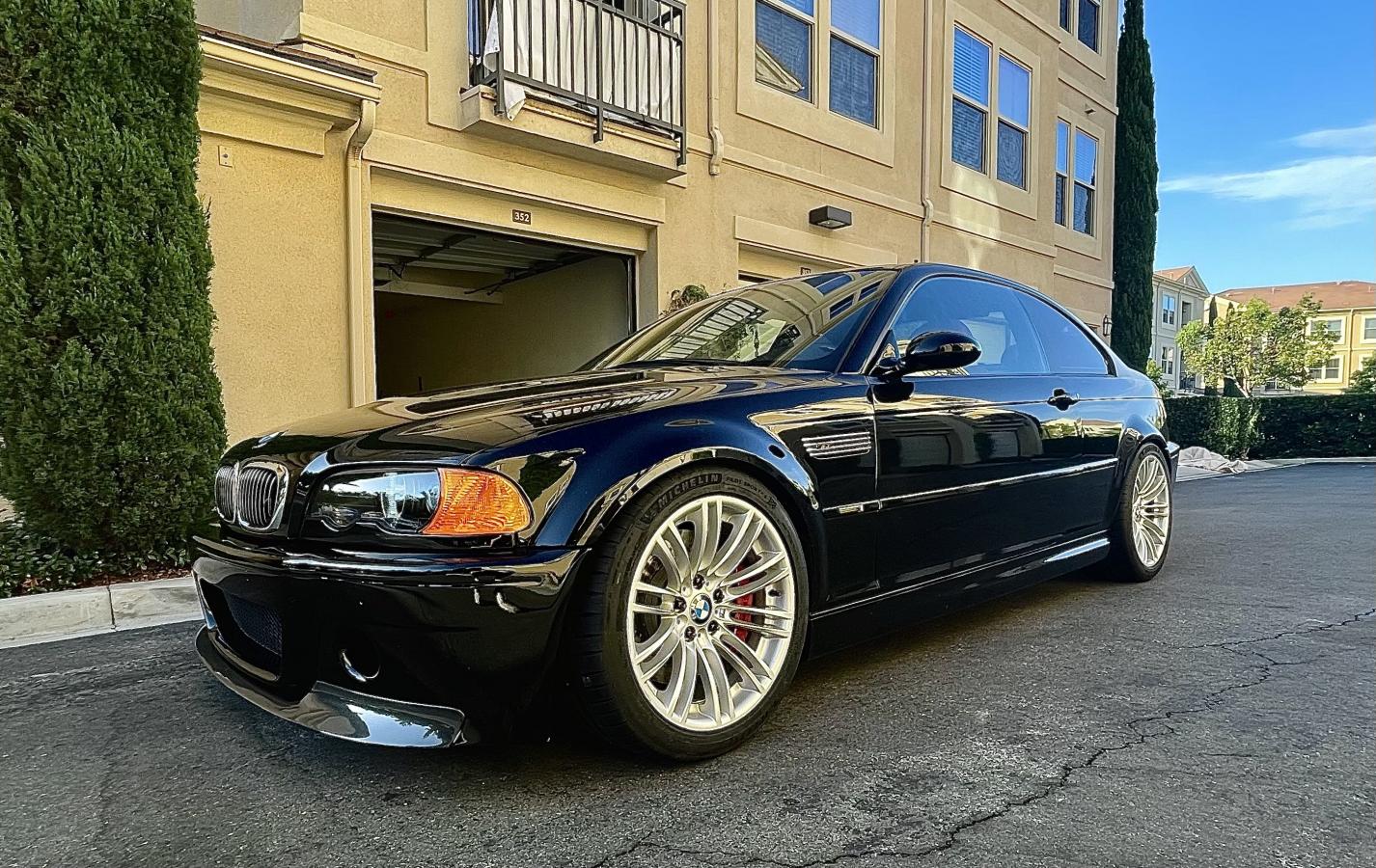

ID:	180583Im running the 996 BBK with a 5mm spacer up front and none at the rear. Check out post #554 from “Porsche Brembo 996 BBK Conversion” thread! Tbone says, No spacers required at all!

                  245/40/18 & 275/35/18 MPS4S!
