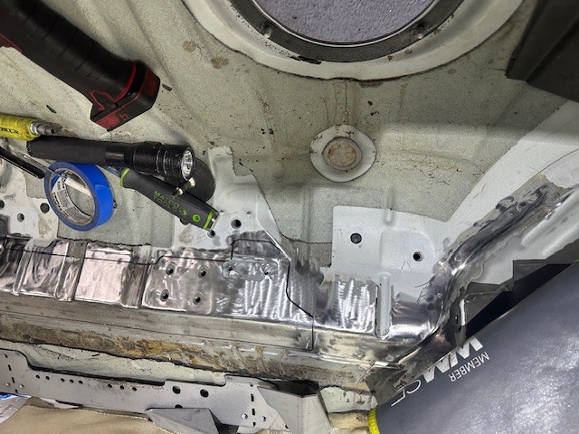

    wanted to bring this back to life to see if anyone has done the Stage 2 & stage 3 front weld in and bolt in RACP?
    I saw the front Bolt in RACP in an IG video and was intrigued.

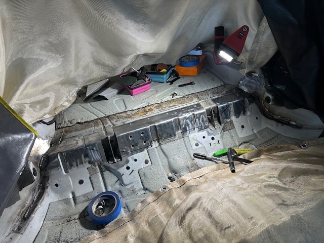

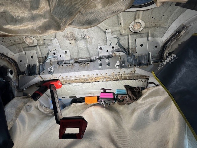

      Yes.
      Sorry no matter matter what I do the forum flips these pics upside down.​

        I did it in a friend M3 a month ago.

                  Yes.
                  Was stage 2 really necessary for Stage 3 when i already have the VINCEBAR done?
                  when you did the front stage 2 &3, was Stage 2 necessary to install Stage 3?

                      when you did the front stage 2 &3, was Stage 2 necessary to install Stage 3?​
                      Yes cause there are threaded inserts in front topside and also rear topside stage 2 so you need them to do stage 3.
                      IMO doing CMP stage 1, 1.5, 2, 3 and subframe raising bushings make the car super stiff/no more flex and RACP bulletproof!
