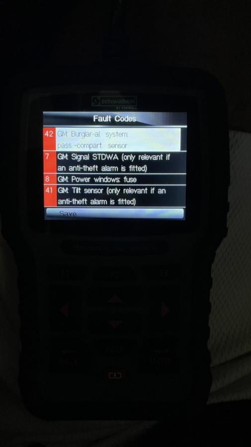

            So it sound like you have INPA, so read the fault codes in the GM5 module and post them here.
            Otherwise you can unplug the siren behind the cabin filter housing and the alarm will stop making noise till you figure this out.

              This is what my Schwaben tool read. Interestingly, if I unplug the tilt sensor, the alarm will go off randomly when parked and locked or when I’m driving. I have a spare tilt sensor I’ll swap in, then install a new cabin ultrasonic sensor. If that doesn’t help, I’m gonna see if unplugging the Avin headunit helps. The windows are working fine, so idk what the fuse issue is.
