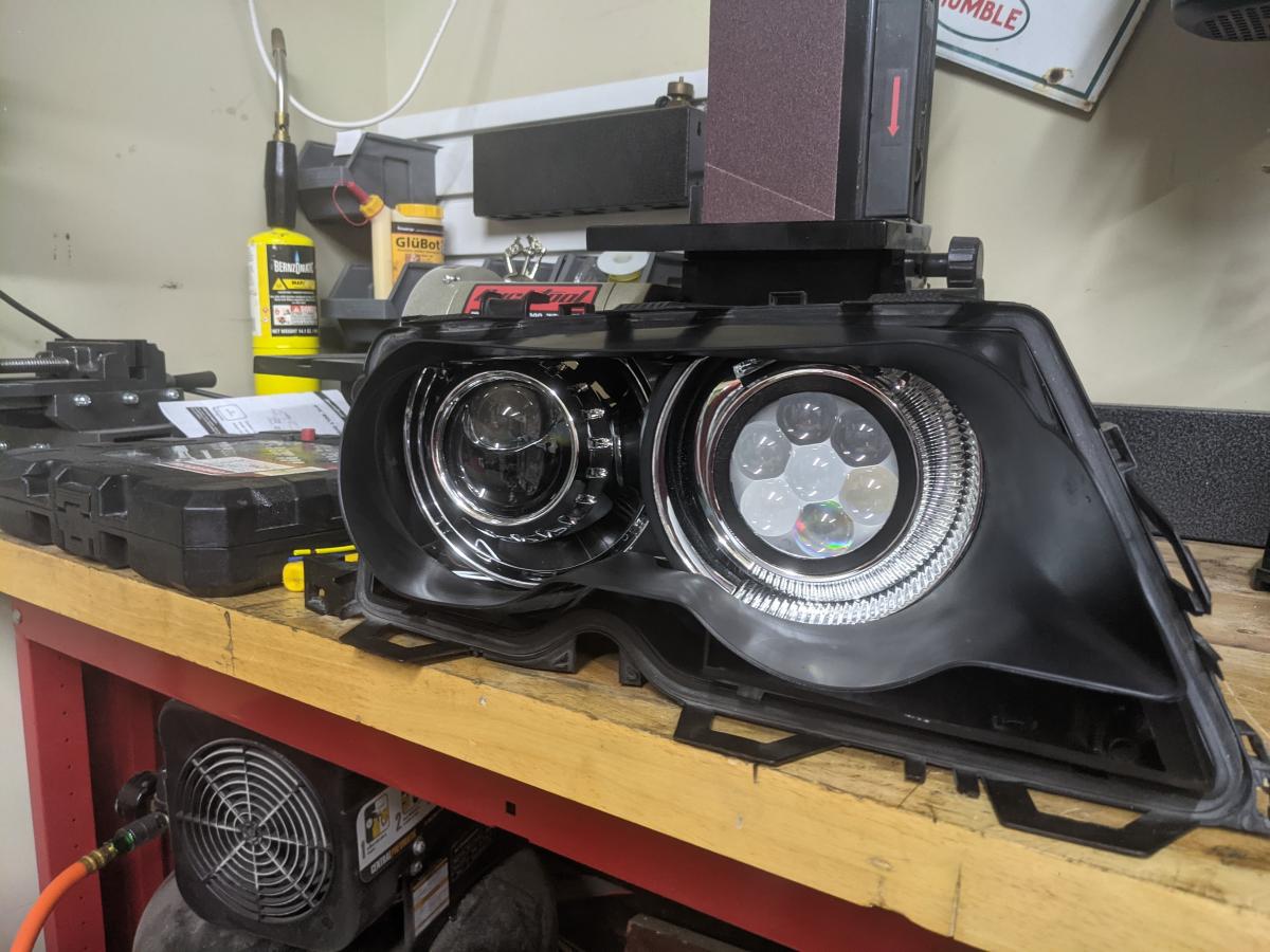

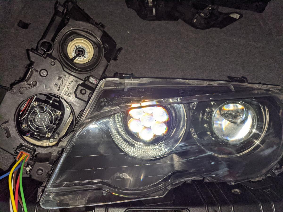

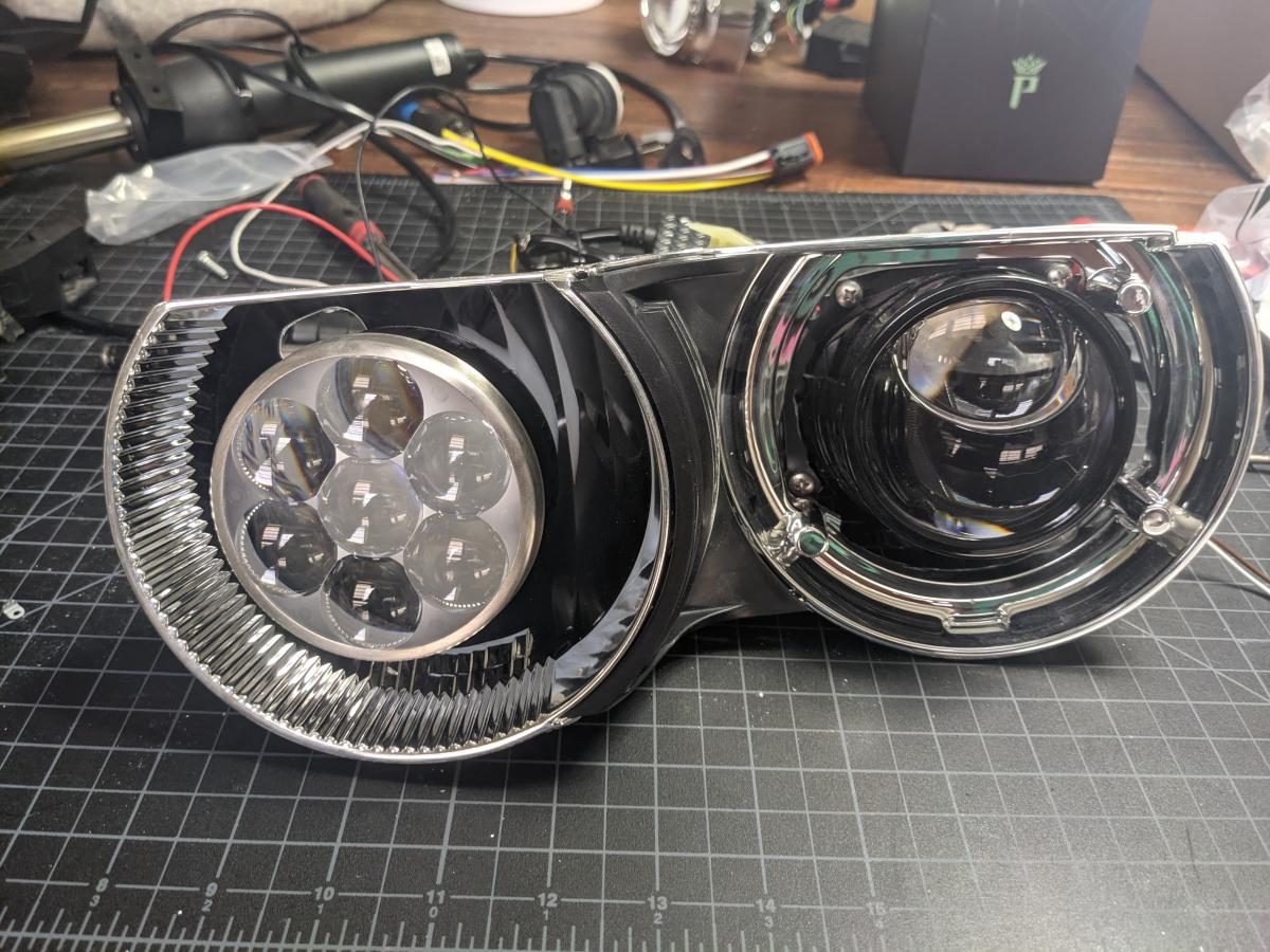

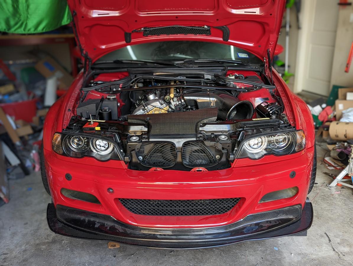

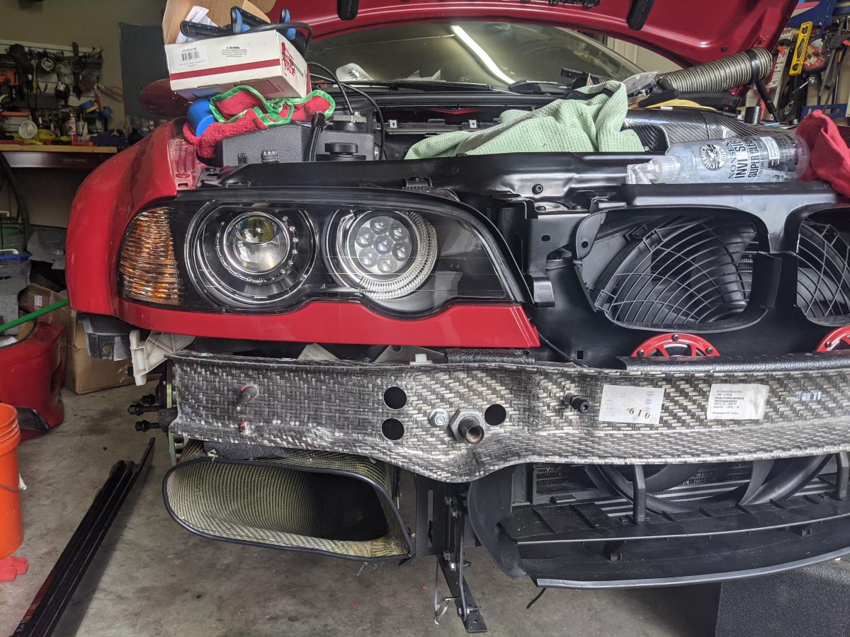

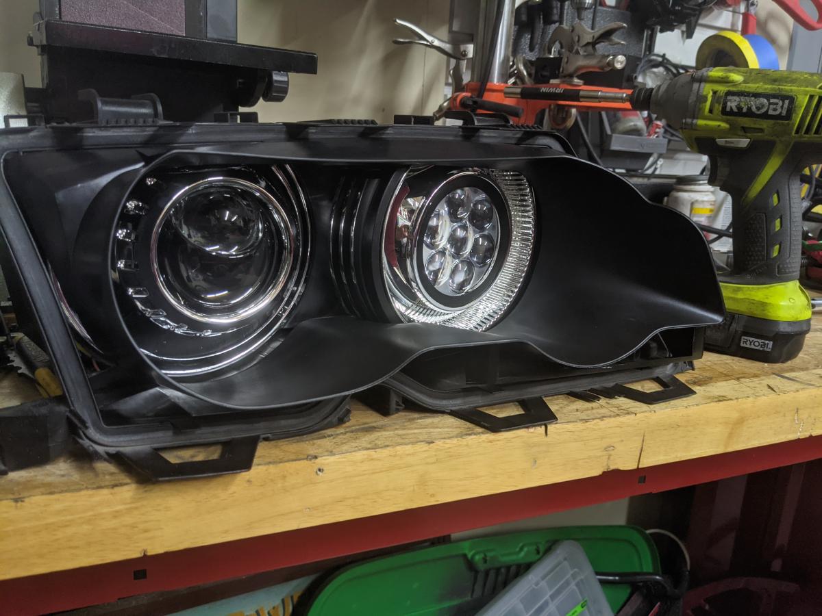

        I did a retrofit a few years ago on mine using items from retrofit source, ups low (bi-led with laser fog light) and high side is a morimoto led high beam. Wiring was run to a 12 pin Deutsch bulkhead fitting. Saved a few lbs and freed up some space that was needed for other items. Unfortunately I haven't actually tried them yet build may have snow balled a little, hopefully soon.
        Few pics from the build.
