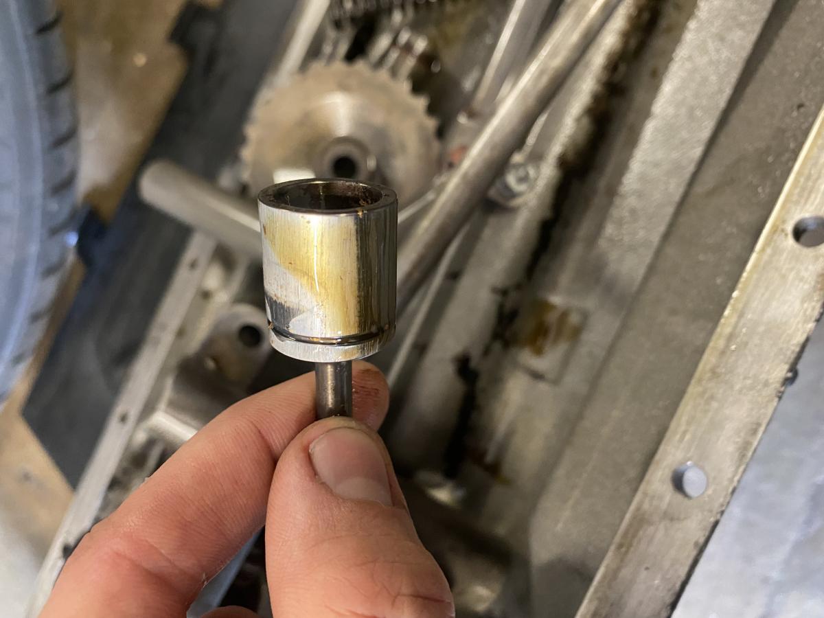

    Beside much brand new engine parts, I found the reason for the previous rod bearing failure (and the next was not far away).

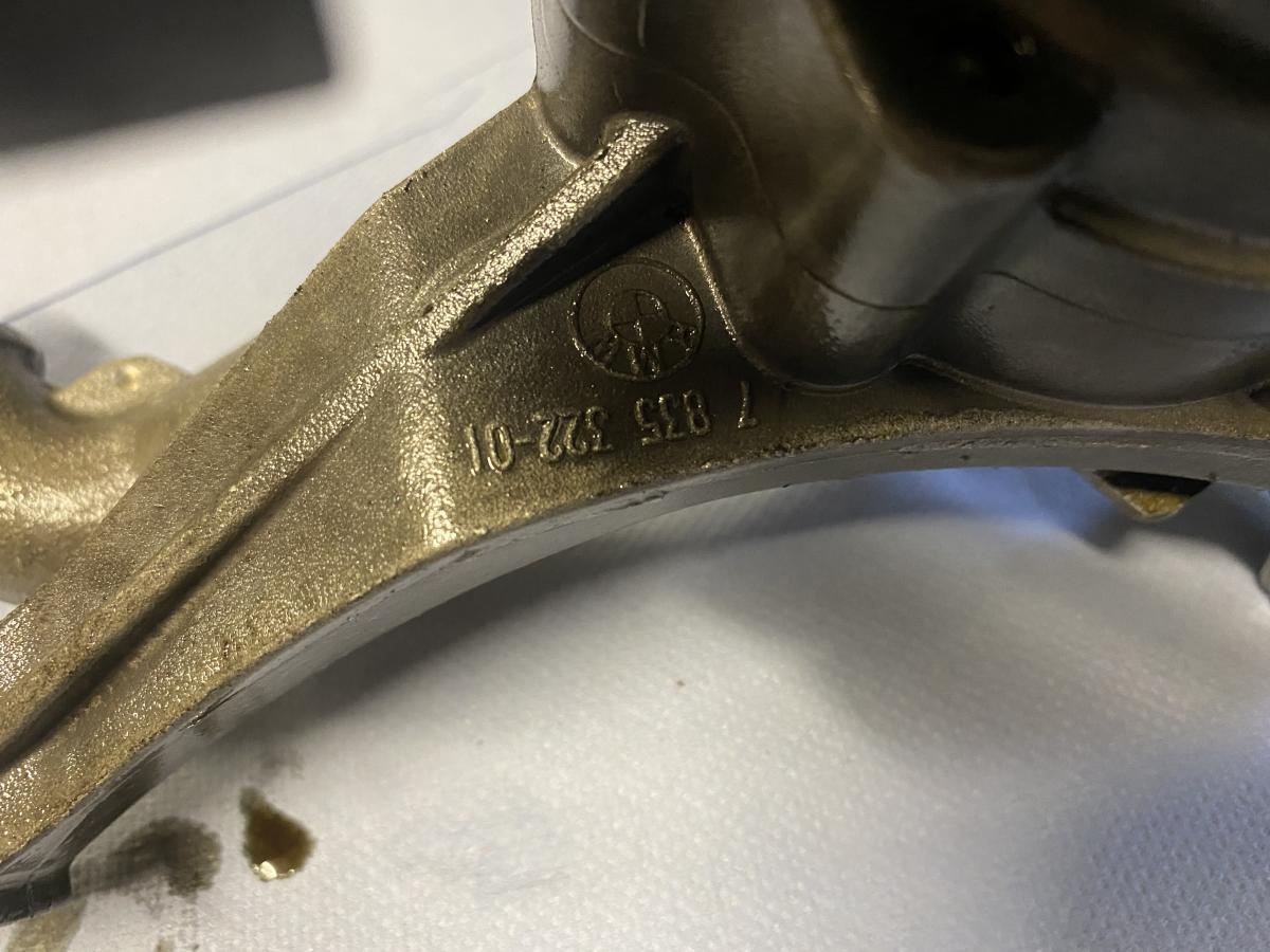

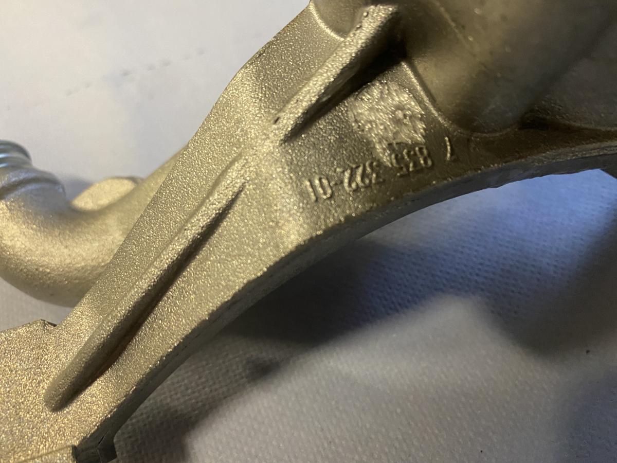

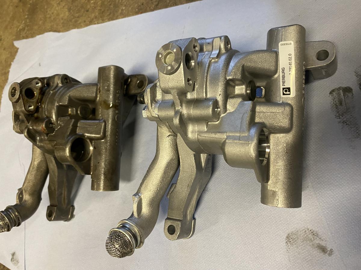

    So i ordered a Pierburg aftermarket pump and this arrived:

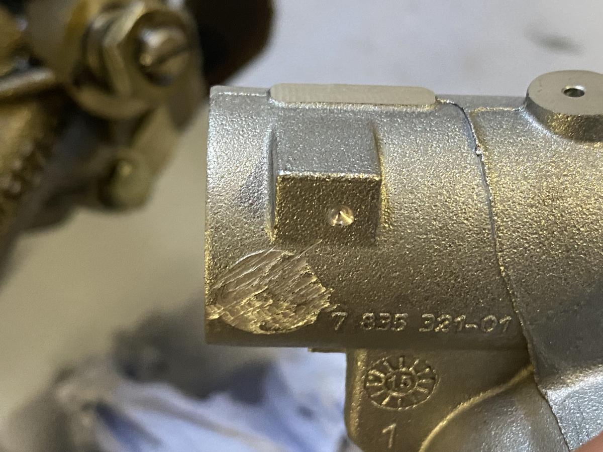

    Like new OEM Pumps, it had a sharp edge inside the bore from the piston. Exactly where the old piston failed. I know some engine builders, that smooth these edges. I did this also with a very small diamond file.

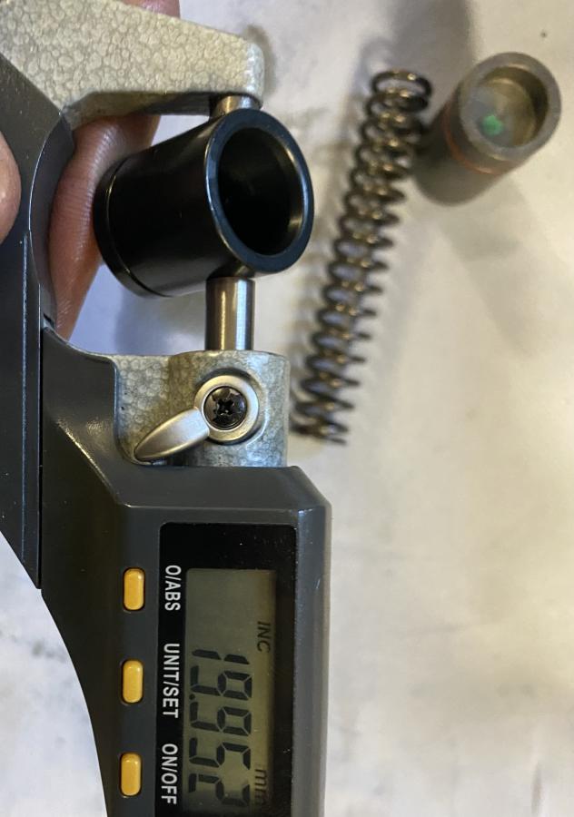

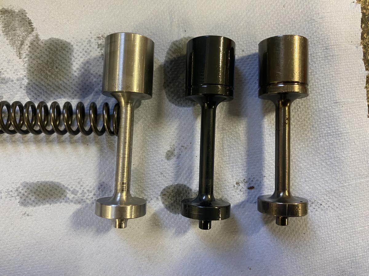

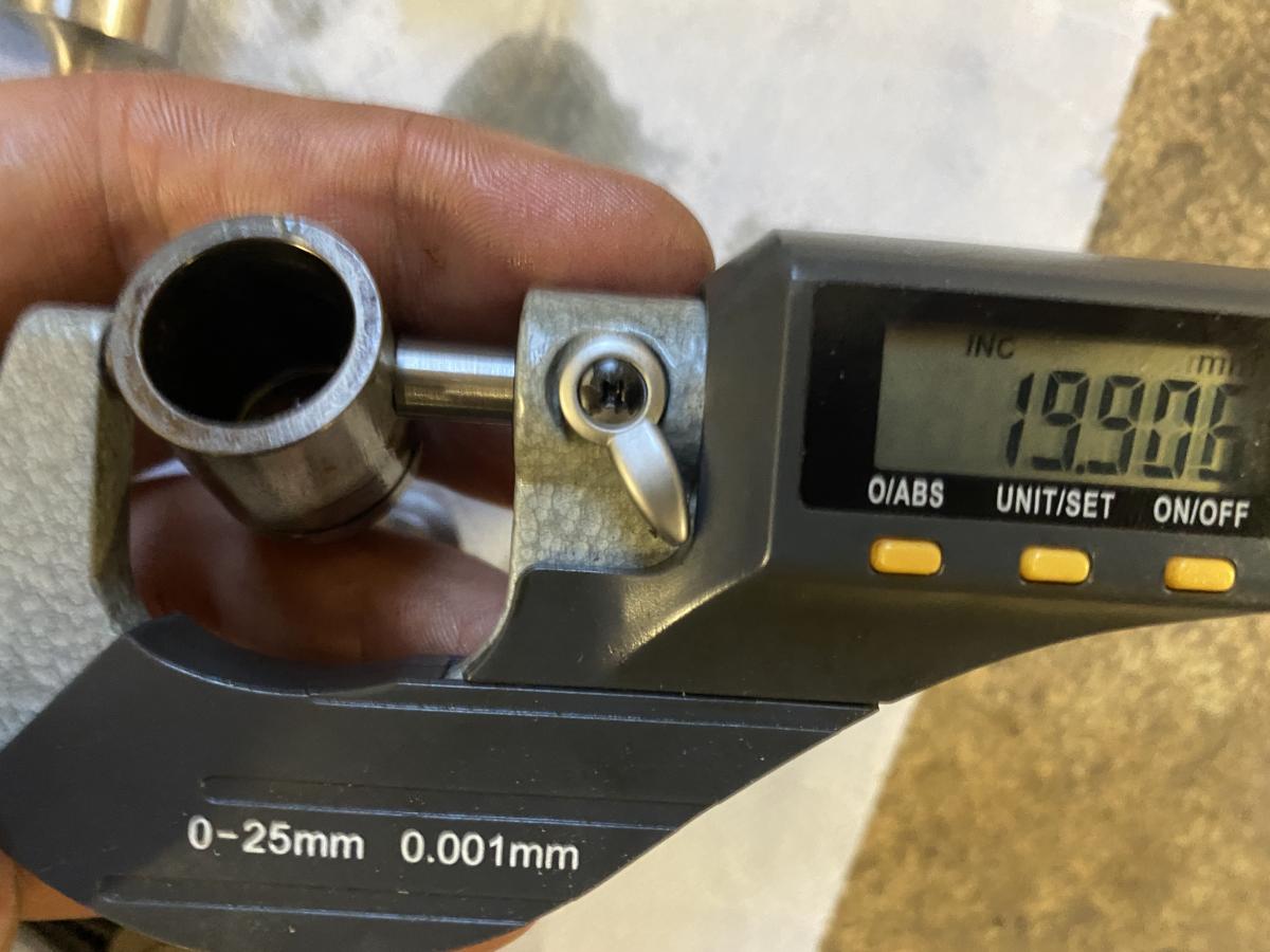

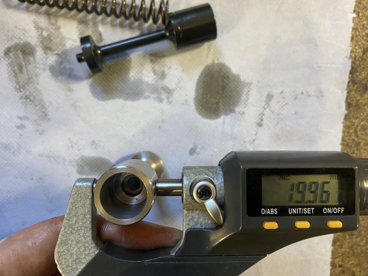

    Just for interest, I measured the new piston that is made from aluminum like the old one but is now black hard anodized, the old worn piston and the S50 stainless piston that many people use with success. The stainless piston fitted very nice into the old worn pump, but had little to no play in the new pump. So I decided to not use it, to avoid that it get stuck.

      No, sadly not. But judging on the cam condition, I would say it was a slow dead for the engine with low oil pressure and could be avoided if someone looked up for the reason why the cams did get that bad with time. It has yearly stamps at bmw dealer for oil change, so they used 100% correct oil. And the owner tell me the engine died on the autobahn at full throttle.
      I tried to move the old piston in the bore with my finger up and down and sometimes it get stucked on the edge that worn the piston down. And if that happens at 7k+…
          Piston stuck at which end -- compressed spring end or expanded spring end? Former would cause low oil pressure, latter caused high pressure.

              I am not sure about a stainless steel piston, the OE one I understand is aluminum, so this DLC coated may be harder, but now may wear out the pump casting?
                My 1966 Porsche 912 has the steel piston in aluminum bore, and the original parts cause no oil pressure issue. The piston is in oil so I don't think bore wear is the issue even with SS piston. Stock aluminum was used maybe due to having the same thermal expansion with the bore, to be safe.
