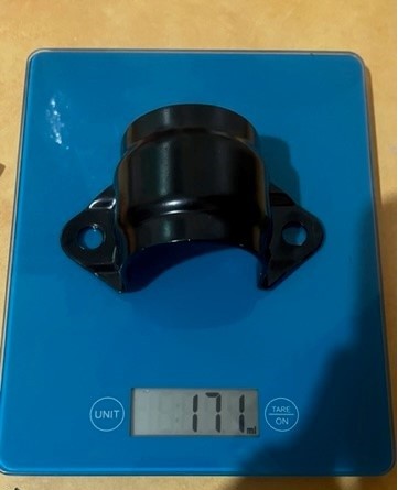

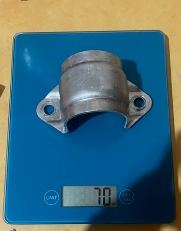

    I also bought the brackets, and to my surprise, the CSL brackets are steel whereas the Z4M are aluminum. I also weighed both brackets and they are 100g different in weight for a total of 200g for both brackets. Not a save in my application as I will keep the aluminum items original to my car.
    I would not know if the regular M3 items are aluminum or steel. The brackets are identical except for the material, and though I think the steel brackets would take more load, I do not track my car so I shall be fine.

    Thanks for weighing them .. felt substantially lighter to me and good to see it is. The regular M3 has the aluminum brackets. I replaced mine with steel because I do track the car and thought maybe it’d help keep my sway bar mounts intact.
      Now you are making me think twice if I should use steel, 200g more is not much, lol.

          I would stay with the aluminum sway bar brackets. Our front sway bar mounting points tend to rip out under load. I would rather have the bracket deform than the mount rip out.

              Good and interesting point. I agree, as the brackets are cheap

                  Agreed its a safety concern. Which is why if you don’t have the reinforcement the aluminum is a better choice to put less strain on the mount. Id rather forces go into aluminum bracket versus weak mount.
