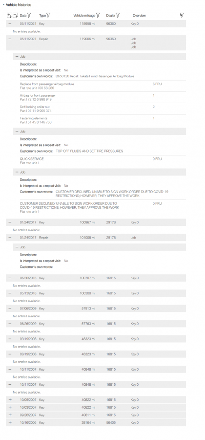

                    WBSBL93433JR20148

                          TIS doesn't show any repair history besides airbag recall.
Name:	myair-bdr.bmwgroup.com_air_faces_xhtml_fahrzeug_FahrzeugSingleView.xhtml_vin=WBSBL93433JR20148.png

                            I would strongly advise against moving forward with this one without a PPI by a mechanic experienced in this era of BMWs. If the previous owners couldnt be bothered to get a critical no-cost recall done to the car, who knows what else they've neglected...
                              I'm not sure I follow here. It doesn't appear to have any open recalls at the moment. Airbag recall was done 5/11/2021 and TIS isn't saying there's any active recalls.
