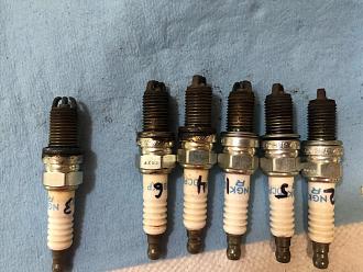

    In the middle of replacing my rod bearings so i pulled the spark plugs. All 6 plugs look pretty bad. black/dry ie. Indications of a rich burn. 6K miles on both OEM coils and NGK plugs. I would say 3K of which are hard HPDE miles.
    149K miles on car. Engine all stock. I did hook up a catch can around time when i installed plugs. I maintain this car better than most/ie early oil changes etc..
    No issues/check engine lights etc. Car pulls strong. Suggestions here for why my car is running rich or how I can trouble shoot ? thanks in advance.

          Picture is too small and low resolution, so almost useless to see in more detail. I'd like to see the color of the tip and ceramic area.
          Yes, get OBD reader and read the fuel trim, MAF in g/second, engine temp, pre and post O2 sensors, at warm engine idle.

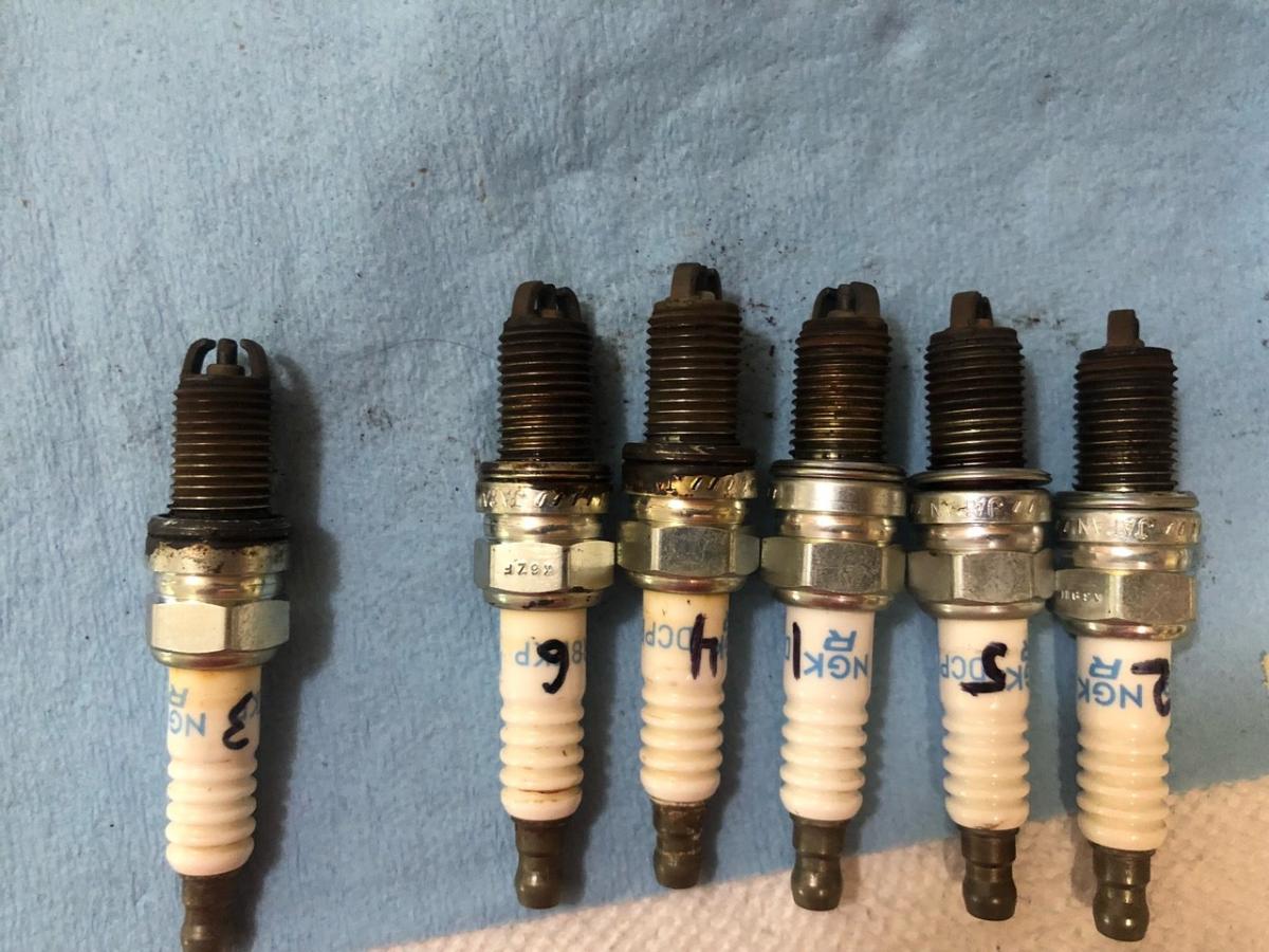

            it will be a few weeks for OBD data as car is up on jack stands in the middle of rod bearing r/r. Maybe this is a clearer/higher resolution picture

              A little darker than tan, but not too rich and it might be normal if you floored the pedal often. OBD data can tell more about it.
