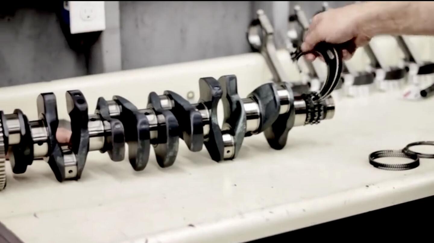

        This HPF video starts crankshaft discussion briefly at 5 min 30 sec and provides some good information starting at 7 min 30 sec in. There is a series of four videos total; watch all of them if you have the time; a fella can glean a pointer now and again from the videos.
