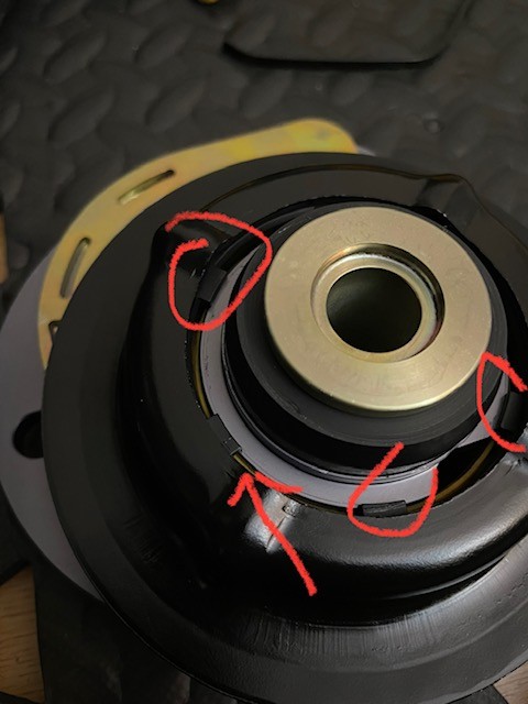

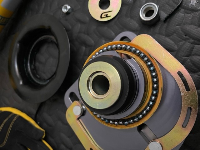

    • The plates arrived with a bearing open and the balls falling off in the package. I had to gather the balls and put them back, and re-clip it back together:
    Click image for larger version  Name:	image0.jpg Views:	0 Size:	66.0 KB ID:	188847
    • There seems to be tiny tabs containing all the energy of the spring and I can't trust these (see my photo with the arrow and circles)
    • The adjustment nuts that comes with it are not the same as the stock bolts for cars with a strut brace, and I am not sure the plates can be used with the stock strut brace without camber adjustment coming off.
    • To adjust camber, I would have to unbolt my strut brace every time (contrary to designs with an Allen bolt in the center for adjustment, the GC street rely solely on the mounting nuts)
    TL;DR : I don’t trust the design yet.
    Small tabs holding the strength of the spring:
    Click image for larger version  Name:	image1.jpg Views:	0 Size:	56.7 KB ID:	188848
    Also their website is glitchy, and there's no installation instruction or adjustment manual anywhere. This was not going to hold me back but the sum of all the factors mentioned above plus this, makes this GC thing look like a school project more than anything serious to me...

          My main concern is these plastic tabs (second photo) which I can’t figure out if that’s how they’re supposed to be. I’m not putting these on my car until I can figure that out.

            I'm currently using GC Street camber plates, albeit with coilover springs. Your camber plate is currently setup for use with OE springs, based on the black metal upper spring perch you have in your photos.
            • The black plastic tabs are part of the thrust bearing. The bearing is the part that is supporting the load, not the plastic tabs. I'm not sure what the tabs are used for but they do not support the load.
            • Re-use your OE strut mount nuts. They have the proper length to thread onto the studs.
            • You do not need to remove the nuts to adjust them. Jack the car off the ground, loosen the plates, and the plate will slide for adjustment. It's not as nice as having the separate adjustment but it works.
            Let me know if you have any questions. I've had these plates for a few years now and feel confident with them. I daily drive and track on mine and the alignment has not shifted.

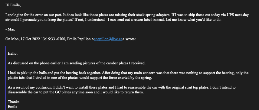

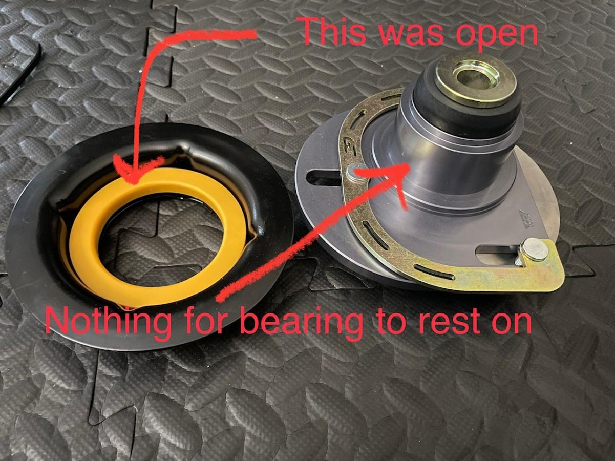

              Well... I think the plastic tabs would have definitely supported the spring's load had I installed them without the right support. I think it's not clear from my previous photos, though. So here is one more.
              Click image for larger version  Name:	Capture d’écran 12.png Views:	0 Size:	68.8 KB ID:	189034Click image for larger version
                It looks like they sent you the wrong camber plates, or they were manufactured wrong. The GC bearings are similar to stock bearings. Those tabs don't really support anything.
