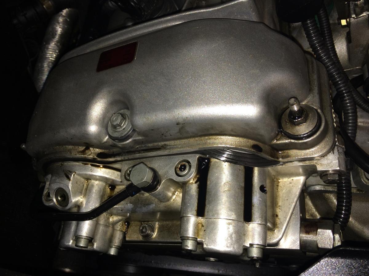

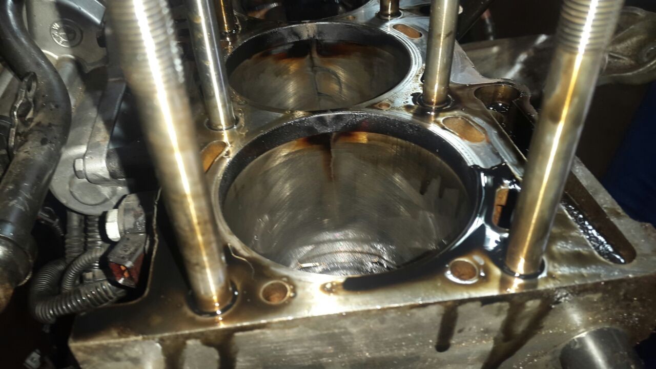

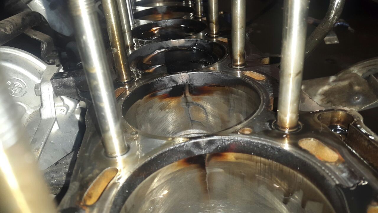

          Thanks! That engine from 2012/13 was supercharged... Unfortunately it didn't even last a year. The car was strong, boosting 9psi with a VF engineering kit, but the cylinder walls cracked.
          The engineer / engine builder of that build thought using 1mm sleeves would be suffice. I cannot recall if I mentioned it in those videos, but the block had scoring, so the engineer & Engine builder believed it was better to overbore by 1mm and drop in some no name sleeves. We live, we learn. Apart from that massive oversight, the engine was put together very well and most of what I know was absorbed by the engine builder, but unfortunately the oversight from him and the engineer about the 1mm sleeve is what cost me the engine in the end. I had an in depth email chat with Tony from Vac Motorsports about the failure and he mentioned that one must use 3mm sleeves minimum. He also believed that whether the engine was NA or supercharged made little difference as the end result would have been the same, that being that the 1mm sleeves would have failed.
          I then elected to go back to NA. Sold the supercharge kit to fund the next rebuild and I then sent the engine to another engine builder. At the time I was swamped with work and also somewhat tired of the constant engine builds, so I never filmed the build nor did I ever go see the progress. Turns out I've just had rotten luck. But it gets better... I also discovered certain parts missing from my engine during this most recent disassembly, hence my decision to build this myself. The next few episodes will go into the parts that suddenly went missing...
          Some pics from the 2013 rebuild failure
