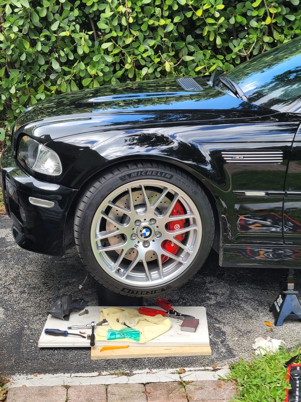

        I recently ordered the kit for c63 amg caliper swap. Fitment seems perfect but i had to shave a bit off the bracket for the pad I chose. Havent gotten the car back yet frol other work so idk if it works well, but it looks good.

          That D977 pad has 66mm of swept area height, which is ~4-5mm more than the ZCP rotor has to offer... is the pad hanging over the edges?
                  No, not at all, seems to be perfect. Oh btw, i am using the 360mm rotor from the e9x m3.

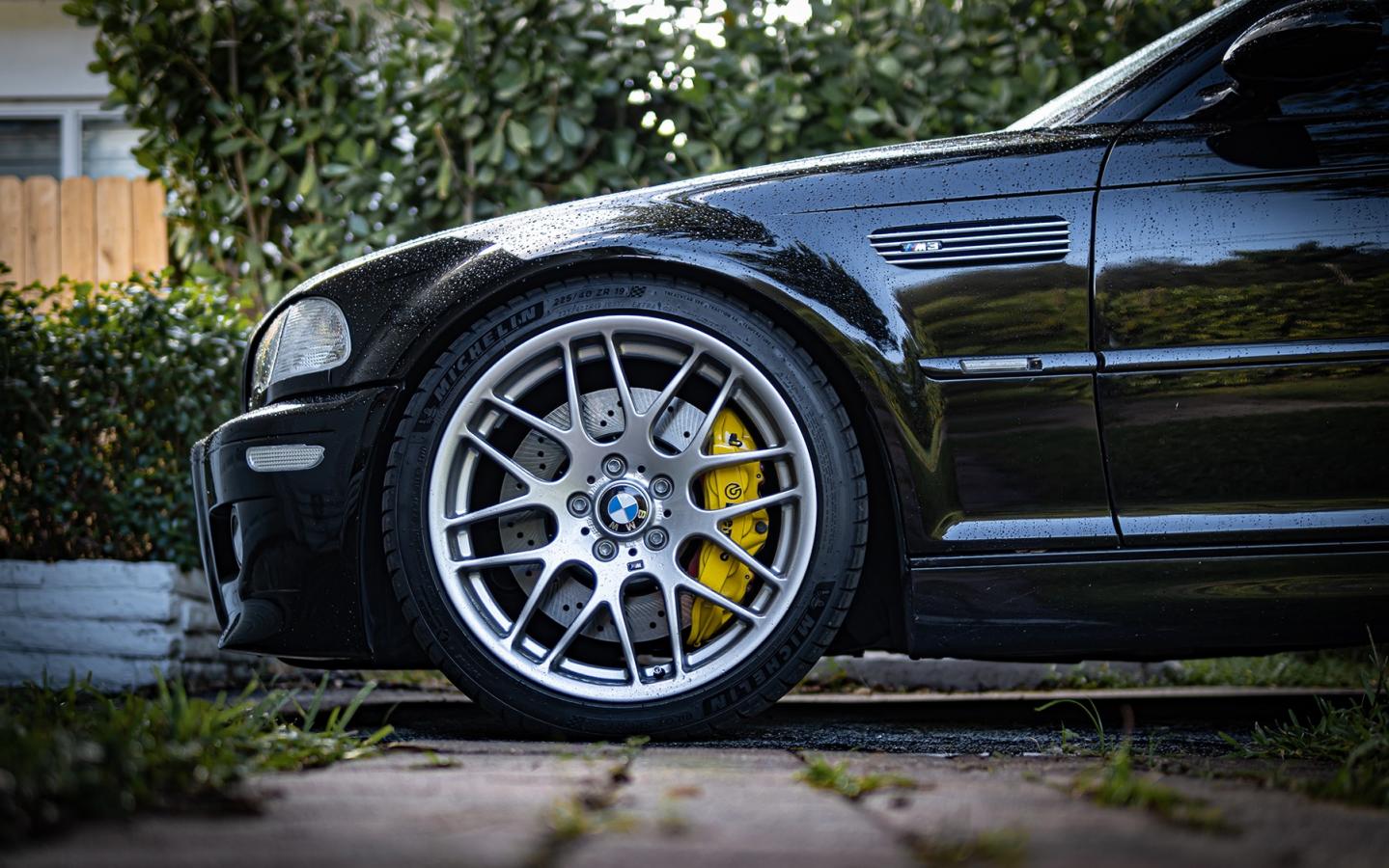

                        Just got the car back from the shop with the new brakes installed. Decided to paint them yellow at the last moment.
                        So the specs are:
                        - Front calipers off a w204 c63 amg
                        - 360mm rotors off a e9x m3
                        - Pads are ebc redstuff made for c63 amg.
                        - 15mm spacers at minimum to clear...I have maybe 2 or 3mm of clearance right now.
                        - Rear calipers off a 996
                        - csl rotors in the back
                        As you can see the sweep is very good. I maybe should have gone with the 380mm in the front but since i was doing 996 conversion in the back i thought the disparity in sizes would've been too drastic.
                        Honestly if the guy who previously posted that this was the worst retrofit in terms of pedal feel i would not have noticed anything....Feels almost stockish...if you twisted my arm i might say that the pedal travel is a bit further but when you get there it grips like hell. Overall very happy with the early impressions.

                          These options all look interesting until you start looking at the details. For anyone street driving, what I say can probably be disregarded. Let's all just accept that 99+% of the folks looking at 6pot, or other 4pot "upgrades" are doing it for looks. Nothing wrong with that.
                          I am semi happy with 996 kit for street and track. Read, this is where the bias and feel and power actually come into play, when you are hauling 130 mph down a straight and need to nail down a turn slowing down at the limit to around 45 mph to navigate a corner to stay on track and not eat gravel for lunch.
                          Can all these sellers make any caliper fit onto any rotor. Sure. Make a bracket with the right offset to center around whatever common size E46 rotor being used CSL 345x28 or e9x 360x30. Should we put those kits onto our cars. I'm not sure.
                          Most of these options will put brake bias to around or even over 70% (assuming paired with popular e46 rear options of stock/CSL/996). Does it matter for street driving? Not so much. In an emergency when you slam the brakes, you will stop, ABS/DSC will save you. For those trying to drive at the limit, that bias is not ideal as that affects all aspects of handling when working the car on entry, and makes a difference whether you stay on track or plow into a wall.
                          Most of these kits come from much heavier cars, and have to put out a lot of stopping power via 3x smaller pistons (6pot) or 2x larger (4pot), but where they are appropriately paired with their rear brakes on those cars. Putting these front only options on our cars makes them suboptimal.
                          Touareg option uses 2x 46mm pistons. That is a lot of volume to pump to front brakes. You will get longer pedal travel with our MC. As an example of more proper piston and power sizing, take ST40 kit which uses 42/38 pistons on 355 rotor, 996 uses 40/36 on 345 rotor (a bit underpowered on its own).
                          Using same piston sizes from trailing and leading on front of the car when performance driving is very suboptimal, as the pad starts tapering and you get poor pedal feel (proper sizing is to have larger piston trailing). I think same size piston is also the problem with Megane caliper (and maybe the DB9, although this specific one I don't remember). So some of these options are not meant for proper performance driving and track use.
                          ZL1 uses 38/34/30 pistons, AMG uses 38/36/34. Also more total volume of fluid, longer pedal travel and more clamping front bias around 70%. My rough calc is ZL1 69% bias and AMG is closer to 72%.
                          Another problem is that most of these calipers on these donor cars come with x32 or x34 or even x36 mm wide rotors. Can these sellers find the midpoint for how to fit calipers on E46 with the right mounting bracket/adapter? Sure, that's why they are selling it. They heard the forum/Facebook/Insta hype and craze of putting Brembros on E46, so they are filling the gap in the market. Do I want to run any of those options on a x28 CSL rotor or even a x30 E9x rotor. Probably not. I don't want to have the pistons protruding halfway out with brand new pads and then run the risk of popping them on track when my pads run to the backing plate. Unless these guys pair these kits with proper thickness pads (much thicker than comes on those donor cars), but I suspect they are not offering that . Most standard pads are 16-17mm thickness.
                          Just my $0.02.
