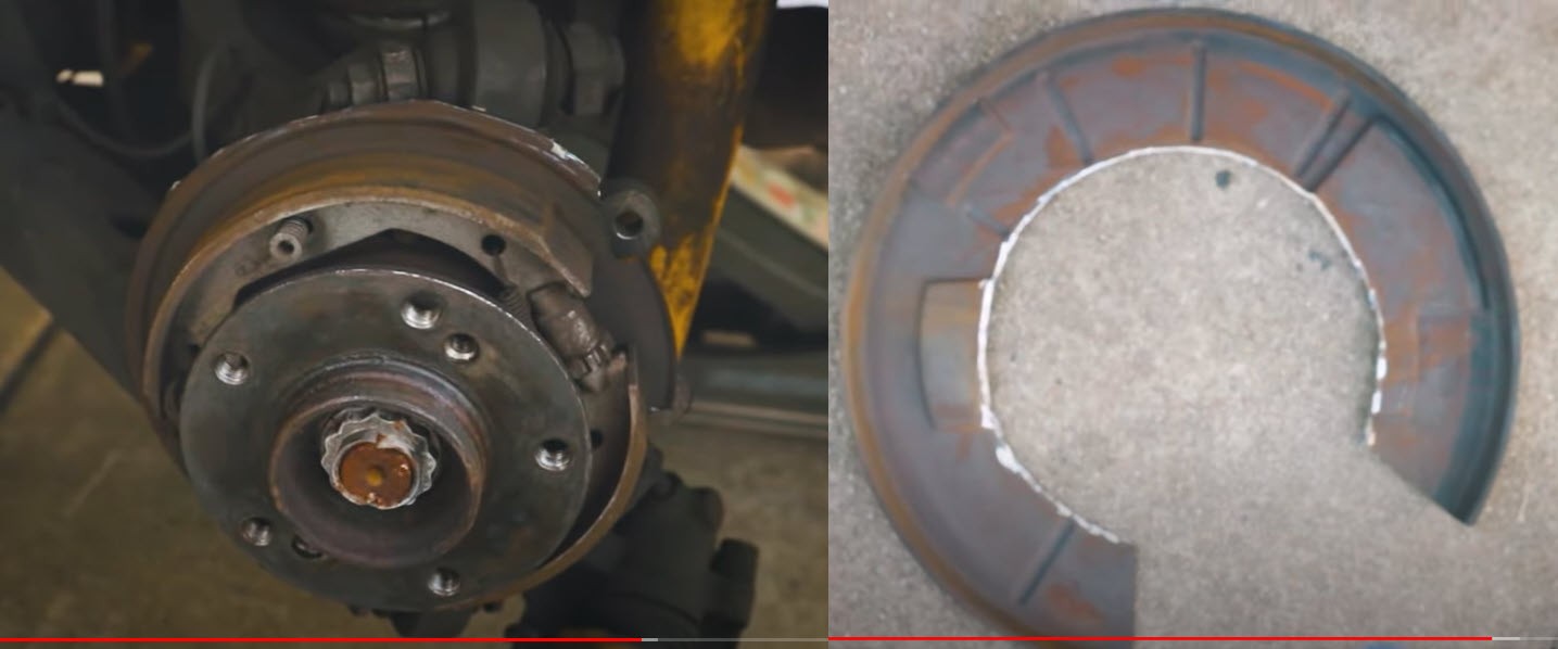

    I was doing some research and noticed a few installers have cut the dust shield off entirely. Munich Venom cut his dust shield off to accommodate his Stoptech kit.
    Click image for larger version  Name:	2022-11-21_16-59-23.jpg Views:	29 Size:	90.3 KB ID:	193257

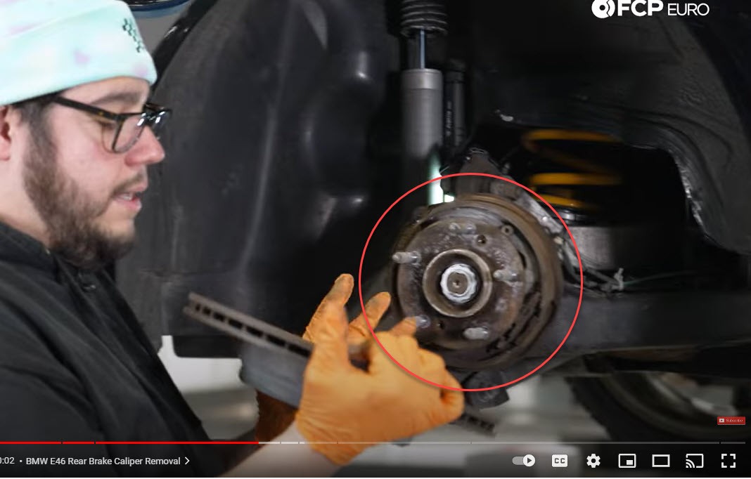

    I noticed FPC Euro also has their rear dust shield cut out for their rear rotor install video:
    Click image for larger version  Name:	2022-11-21_16-59-23.jpg Views:	27 Size:	88.8 KB ID:	193258
    Before commissioning my shop to cut the dust shield off, I wanted to check with the sub and see if anyone had a strong opinion one way or another.

      The way it's cut in the first pic is enough. If it's not perfectly flat, it will rub on inner parking brake surface or parking brake itself won't sit straight. Long story short, it requires some adjustment after partially cutting it off.
      Put some aluminum tape on balljoints to protect from heat.

        I completely cut both my front and rears and got rid of them when I was installing my stoptech kit. cutting them partially didn't get rid of the noise. Get a grinder and get rid of them !
            Aluminum tape on the ball joints - great idea. I recently noticed aluminum tape cover the wheel weights on a GT3 RS that is routinely tracked. Great idea. I'll mention that to my shop.
            In regards to the parking brake adjustment, you're suggesting folding or filing the cut edge away from the e-brake boot, correct?

                The adjustment is not made to the parking brake per se, but to straighten out the remaining shield so 1) the shield doesn't rub on rotor and 2) so the parkikg brake shoes don't drag on the rotor. Especially if the shield is cut with wire snips, it will inevitable be bent and requires some massaging to straighten it out. As Jae mentioned, the parking brake shoes are attached to the back of the remaining heat shield so if it's not "perfectly" straight after cutting, problems 1 and/or 2 can arise.
