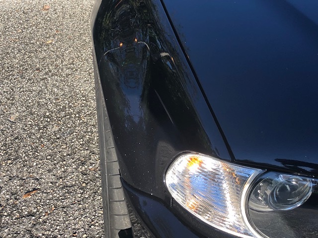

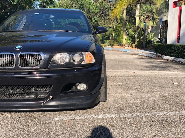

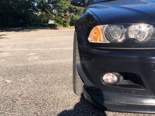

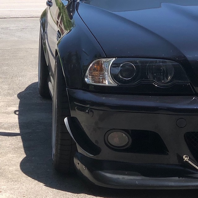

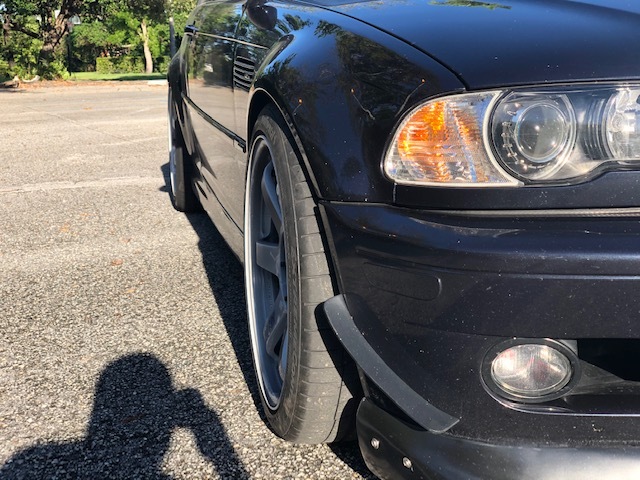

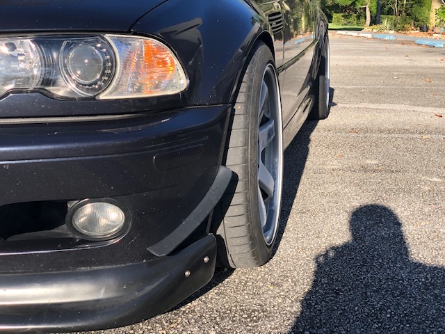

    Pics below, sorry I don't have any better ones off hand, with being on quarantine/lockdown my access to the garage where i keep the car has been very limited. But you can clearly see how much further the drivers side wheel 'pokes'. The passenger wheel is perfectly flush with the fender, while the drivers is poking past it.
    Could it be something caused by the accident? Or maybe how the front subframe was reinstalled after a rod bearing job right after I bought the car? Is it a major issue and is the cars natural alignment affected? Car seems to drive fine and have had multiple alignments with no issues, and car driving perfectly straight.

    When was the last alignment? Wonder how much visual difference there'd be if one side has a little different toe, camber, tire pressure, etc... From the front, toe out might make it look further out, toe in further in.
    Ride height matters too. Macph strut is on a curve, so lower ride height, more camber vice versa. maybe it's just a bunch of little things adding up to a very slightly perceivable difference?
      Fenders ever been touched?
        Non oem fender? DS slmost looks more bulbous. Check the screws holding the fender down in the engine bay to see if they look disturbed by a wrench.
        Almost need a better PS pic since it feels like the shadow doesnt do it justice.
        Agree it is probably alignment.

          I would check the fender. I have seen similar issues on other cars that had aftermarket fenders installed after a repair.
            The pics all have different angles so it's hard to tell for sure. Also you'd have to make sure the steering wheel is straight
              I have this same issue, carefully inspect the struts and make sure they aren't bent, even slightly. Same with control arms

                    I had considered if maybe the fenders were out of wack but the body lines dont have any major gaps so I shrugged it off, but good point. Ill check to see if the fenders have had their mounting nuts/screws messed with. Where else besides engine bay should I look, behind the liners and in the door opening I assume? I never saw the extent or pics of the front end accident, it had happened from a previous owner before the one I bought the car from, so very possible a fender was replaced!

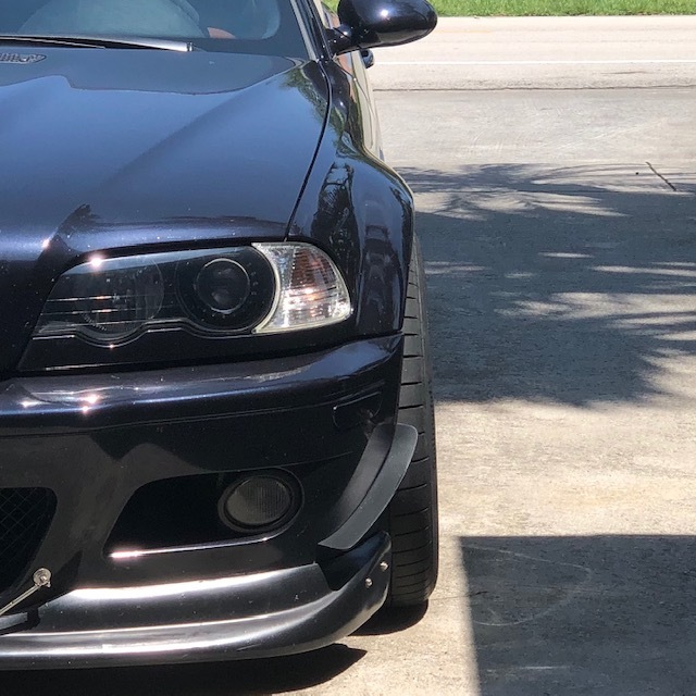

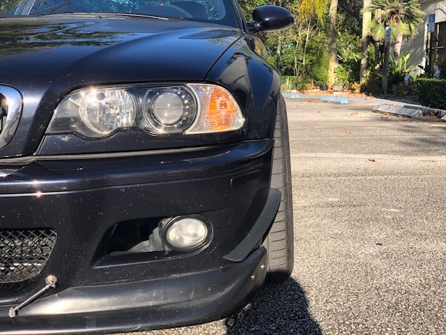

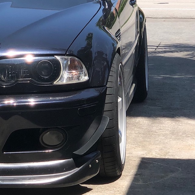

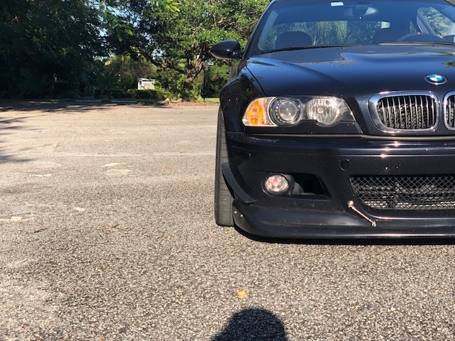

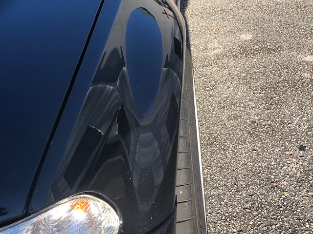

                      Got the car out the garage this weekend, but unfortunately the sun was already setting. But I pointed the car forward into the sun to reduce shadows as much as possible, apologies again if the pics aren't substantial for showing the difference between the two wheels. I know it's alot of pics but hope it showcases what I mean, I know the contrast isn't great on the passenger side pics, but one key take away difference is the drivers tire sidewall is entirely poking from the fender, while passenger sidewall is more within the fender line.
                      I also didn't have time to check the fenders for any screws or bolts being messed with, hopefully next week!

                        I'm actually having this exact same issue. Ever since I installed my ohlins, my driver wheel sticks out further than my pass side wheel. I had an alignment done and I thought the guy just didnt do it correctly, so I bought it to another shop, and I saw it while it was on the machine and camber/toe were perfect and identical on both sides.
                        I know it's not a bent strut because they're brand new. It's odd because the car drives amazing, doesn't pull or anything.

                          And you are 100% positive you didn't have this issue prior to the Ohlins? The Ohlins were the only change made?
                            Ohlins and GC hybrid camber plates were the only changes.. I compared pictures and I definitely didn’t have this before the Ohlins. Very odd

                              My MKIV VW GTI 1.8T also sits higher on the driver side front and I have to keep that coilover set lower to even it out, I have not noticed any more poke tho but I did roll the fenders so it might be harder to tell. Not related to my M3 but I have noticed this on other cars as well so it might be more common then people have noticed.
