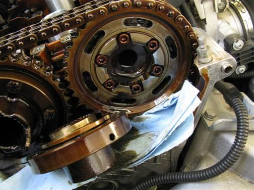

                              Fact: the sprocket has 6 long slots and not just round holes as shown in pic below. So with the hub turned to max CW and the hub bolts are touching the right end of the slots. When inserting the splined shaft, you only need to turn the hub slightly (less than one tooth) CCW to line up the splines with the shaft, and so there is plenty the slot range for the hub to turn CCW further when the final VANOS module is bolted to the head, and then torque down the hub bolts. So don't worry about finding the sweet tooth, as there is still slot left after final torque down the hub bolts which are not touching the left end of the slots.
                              Click image for larger version  Name:	image.png Views:	0 Size:	384.7 KB ID:	196356​
