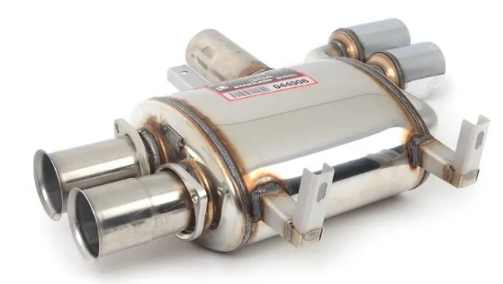

          If I'm not mistaken the supersprint race muffler has 2.5" inlets so that would be my choice since it would be a true 2.5" all the way through
            I've never seen that mentioned before, let alone confirmed with photos of the pipes being mic'd.
            All SS products besides v1s (and dual pipe sect2) are natively 60mm (2.36"). SS will make any sec 3 in 2.5" if you ask for it.
            The intial OD of the pipe that slips over the sect 2 outlet will start out at 63.5mm (to slip over the 60mm sect 2 outlet), then step back down to 60mm after about 4 inches.
            By contrast, a true 2.5" muffler like my scorza (OM) or scza (SGT) starts out at 2.5" and doesn't step down at all.
            See this step down on the SS race from 2.5" to 2.36": (only on the outer pipe that slips over sect 2)
                              Click image for larger version Name:	ssrace.jpg Views:	0 Size:	28.4 KB ID:	194725
                              Ah so it's a step down! This makes more sense. Maybe I can have my fab guy just make it 2.5" if I really wanted that badly lol
