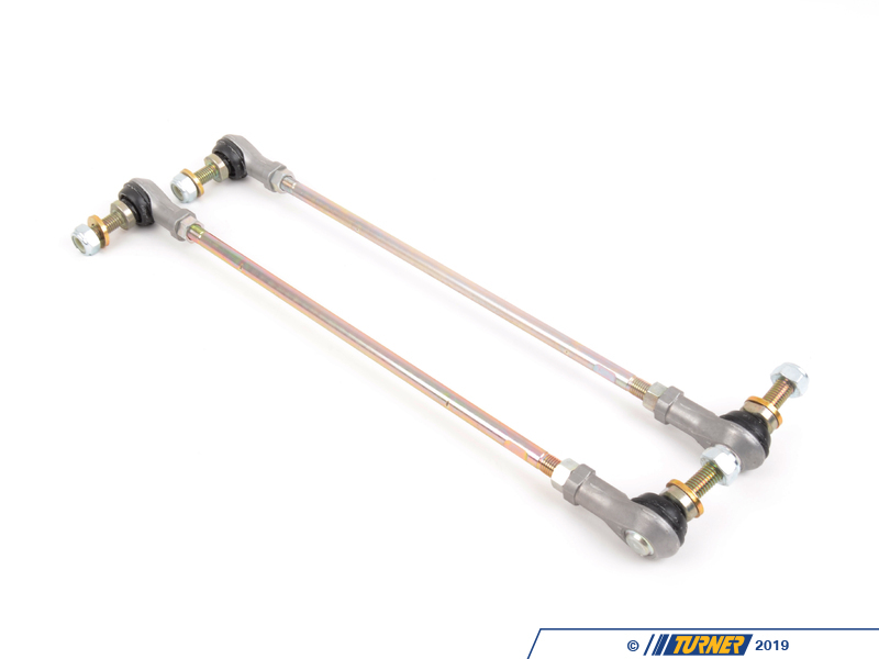

    I have no free trick for preload up front, but turner sells a really nice stock style sealed joint adjustable end link:
    https://www.turnermotorsport.com/p-3...s-pair/?pdk=Ag
    Only one is needed, so save the second for when the first wears out

        What are your thoughts on using washers or spacers on the lower rear sway bar mount that attaches to the wishbone to get it to sit lower?
          They actually sell individual end links, so you can get only what you need:

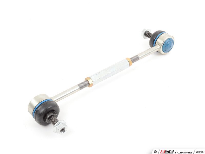

            https://www.ecstuning.com/b-turner-m...nk/tsu4612a46/
            That doesn't look long enough to work on the e46M, though I could be crazy-- just going by what it looks like in the picture.
            e46 m3 specific link:

            the one you can buy individually:
              240 - 282mm range sounds like it should be long enough though
