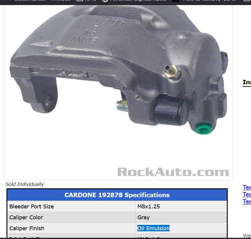

      Word of caution on the reman’d calipers: you’ll want to paint them most likely. Got some Centrics for my X5, and while Rock Auto claims they’re “coated”, the ones I got weren’t.

          I can take a pic when I get home from work, but Centric claimed they were coated in some way for rust prevention. Pretty sure it was bare iron from the way they are rusting. I had not seen enough clean, unpainted iron in my life to notice that they just weren’t finished at all, thought it was some sort of dark grey coating. Really wish I had just painted them black right out of the box.

            Hmm yeah the pic of it looks very similar to the Cardone front caliper I got. Now I'm wondering if this coating I thought was grey paint is just that same rust preventative coating on the bare iron. Here's the Cardone caliper description, but the finish is called 'Oil Emulsion'. I'll also take and post a pic of the caliper later.

              Based on my experience with Centric rebuilt caliper on my 325 wagon, I would not recommended them -- they rusted quickly and the seals IMO are poor quality.
              IMO you are much better off buying Ate seals for the front caliper and rebuilding it yourself.
              You'll have to get Genuine BMW seals for the ZCP rear caliper if you decide to rebuild the ones you buy.
                Yea I've had pretty rough experiences with Cardone/Centric caliper rebuilds on other cars. Centric definitely seemed better than Cardone, but if you have a good set of OE calipers, replacing the seals and even the pistons if needed is a better route IMO.
                Otherwise you can sometimes find Ate rebuilds that are of a high quality in my experience. The fact that they won't even paint the caliper seems indicative of the quality level you're working with.
                  Centric remans after 7 months in the desert. X5 has over 180k miles and the stock calipers were pretty bad. Paint them!
