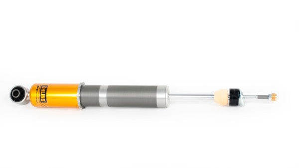

                            The Ohlins' rear shock is adjustable length, so you can set ride height and bump/droop independently. The shock body itself is threaded, it screws into the bottom yellow part, and there's a locking collar:
                            Click image for larger version  Name:	E462-M_03b5210b-dff7-4bfd-b7c8-9972b7905237_2000x.jpg?v=1574098616.jpg Views:	0 Size:	11.2 KB ID:	204312
                            It's pretty great, actually. Lets you dial in front ride height to optimize for bump/droop, and set rear ride height by optimizing for rake, then setting rear bump/droop from there.

                              There is definitely an adjustment to the shocks too. They have a threaded insert and locking ring to set the length. Easy to see in pics: https://www.ohlins.com/product/road-...2001-2005-e46/
