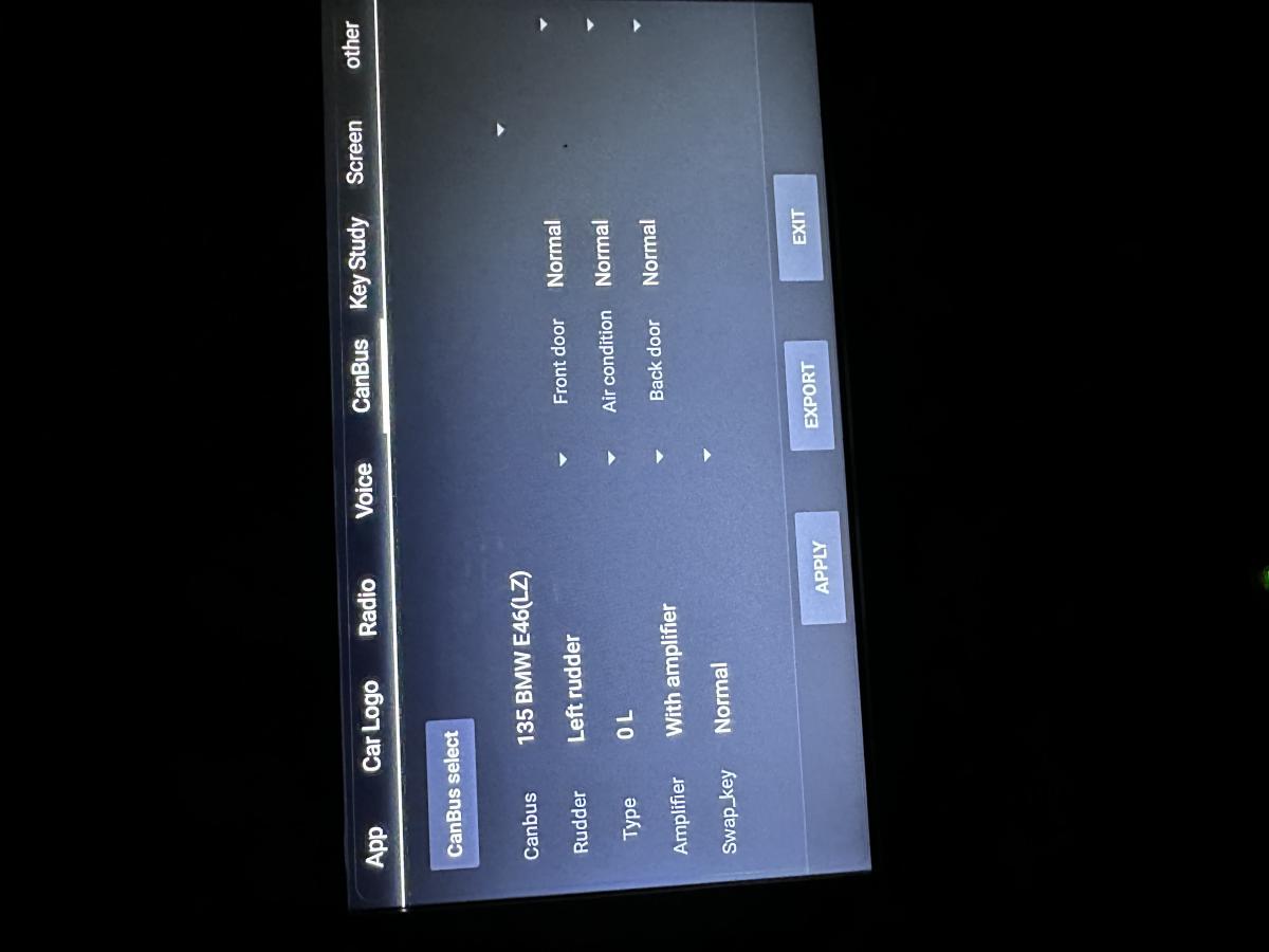

    Canbus settings were verified and the system is reading the module - steering wheel controls are still not working
    If you can have Avin, can you confirm your Canbus settings match mine?
