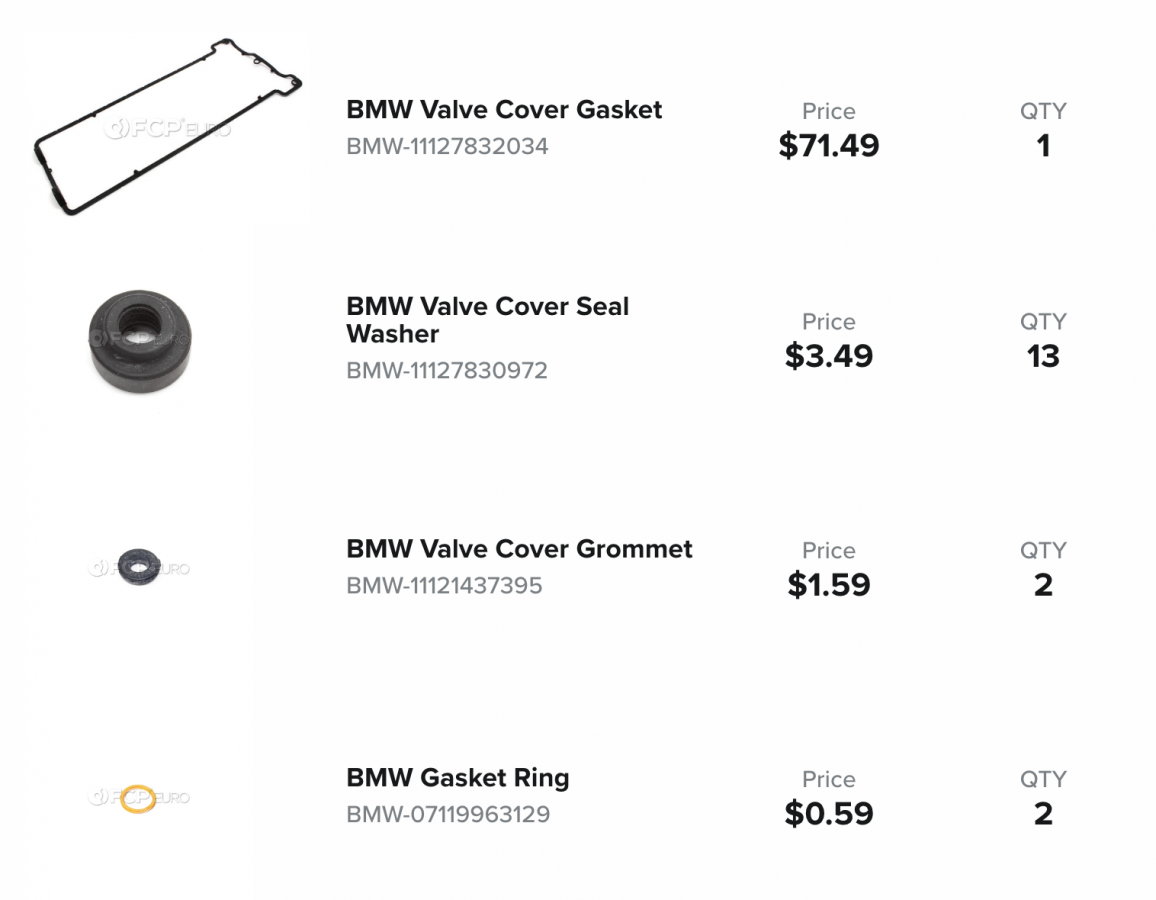

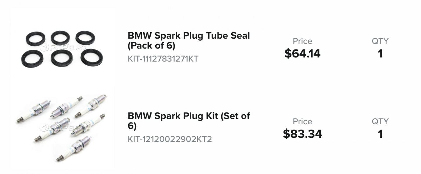

                            ​Just put my order in at FCP - they have everything Genuine BMW, just not in a kit like the Elring kit. Here they all are, with part numbers and quantities if you guys need them! I'm doing my spark plugs at the same time about 6k early but might as well while I have everything open.
                            Also a note to grab the cam sensor o-ring while you're at it - it's the only time you can replace it and it's around $1 so you might as well if you've not done it before. I already bought one previously that's why it's not in my order here but here's the part number if you need it:
                            BMW Position Sensor O-Ring
                            VNE-104482​
