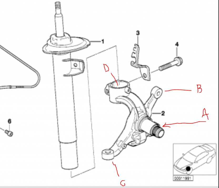

      Its referred to as a kingpin on realoem, so thats what im referring to
      in the picture i added, you can see that the hub is sticking out from what is called the kingpin and it is clearly not parallel to the portion behind it.
      the 90 degrees is an attempt to help reference the picture for anyone looking at it. What i mean is, if you are looking at it on your phone and turn your phone 90 degrees clockwise, that would be the correct orientation of how the piece would sit, were it attached to the vehicle
      i added a screenshot from realoem, hopefully that helps clear up what im referring to

        The proper terminology is swivel bearing... don't ask why because I don't know. The diagram looks like the left side of the vehicle and is oriented as such.

          There is no hub in the pic below; the hub is where the wheel bolted to, and the hub is spinning around the spindle shaft "A" in pic.
          If you are talking the spindle shaft A, then what is not parallel to it? Nothing needs to be parallel to the shaft. It points to the direction depending on the strut and the lower control arm.

            Well, crisis averted. It turns out i was in fact going crazy from being tired. The dust cover for the brake was just bent and so it looked like the hub face was bent. Imagine my surprise when i got back to it today and it was just the thin metal bent out of place, i suppose from me moving the piece around trying to get the bolt out.
            anyway, dum-dum award goes to me. Thanks for the replies, or perhaps thanks for not replying to tell me im an idiot
