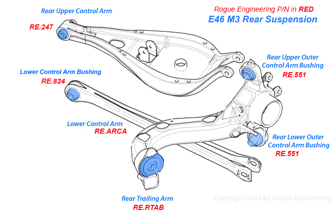

        "while you're in there" led me to also replace the upper and lower outer control arm bushings (attached for reference: 551). I also reused my diff cover, haven't experienced any issues or increase in diff whine.
              Did you use E36 bushings for the diff? I will look into these bushings you referenced too, thank you!
