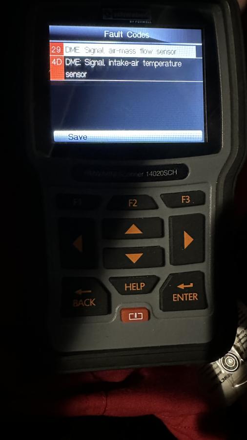

    I’ve tried two MAF sensors so far, and have a third I can throw on. The first is a Bosch MAF sensor that is less than two years old/<5k miles. Because of the issues I’ve been having, last week I swapped in my old MAF that was working fine previously. However, I’m getting the same code with both sensors - “29 DME: Signal, air-mass flow sensor.” The 4D code popped up after I unplugged the MAF. All of the intake parts are installed correctly, so there shouldn’t be any leaks. Am I overlooking something?

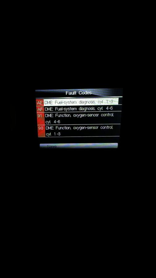

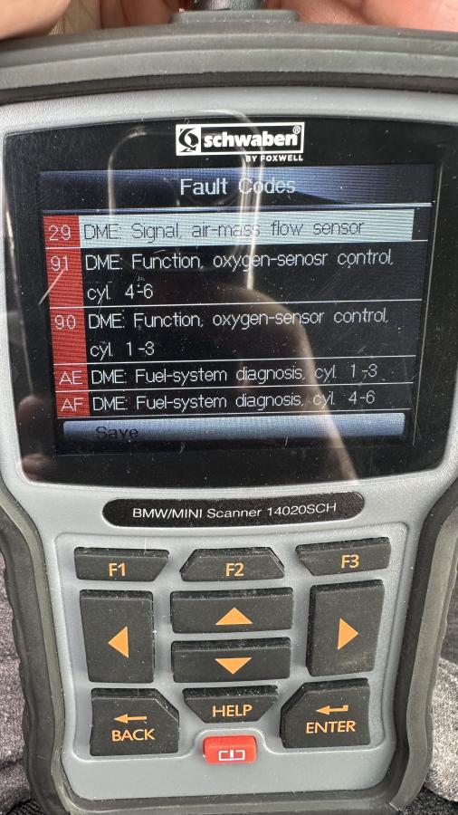

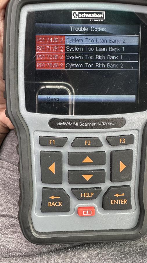

    Update 2 (15MAR23): Drove to a DIY shop to install the O2 sensors, and I pulled a ton of codes on the way there (pictured below). Car was running extremely poorly. Intake elbow and everything in front were removed again for inspection, then reinstalled. Both pre-cat oxygen sensors were replaced with new Bosch sensors from Autozone. Post-cat oxygen sensors and EGT were removed and coded out years ago due to previous catless setup. Cleared adaptations, and the car is running smoothly now. No codes in the 10-15 miles I’ve driven it, but I will check again after a 140 mile drive this weekend. I’m very surprised that both oxygen sensors seem to have failed at around the same time…maybe a bad TPS sensor led to poor AFR, which killed the oxygen sensors.
