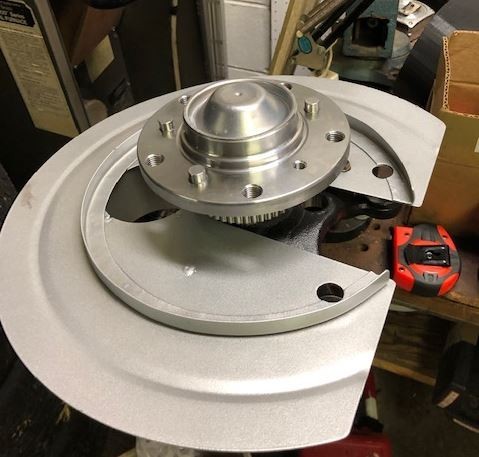

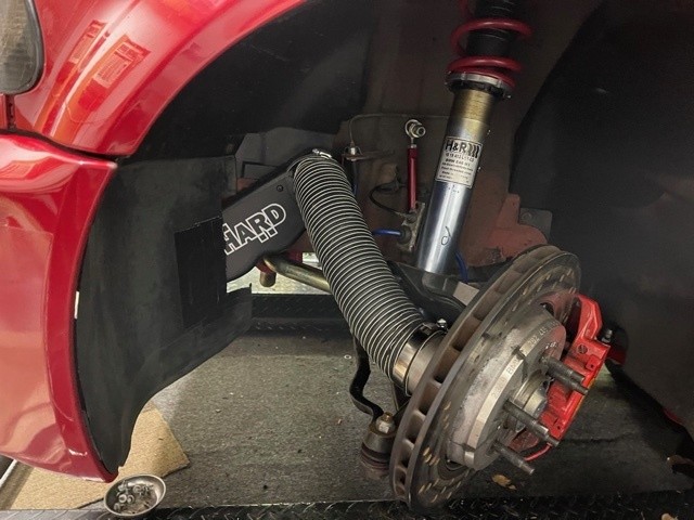

                          I'm running pretty much a full hard motorsports setup.
                          Backing plates:

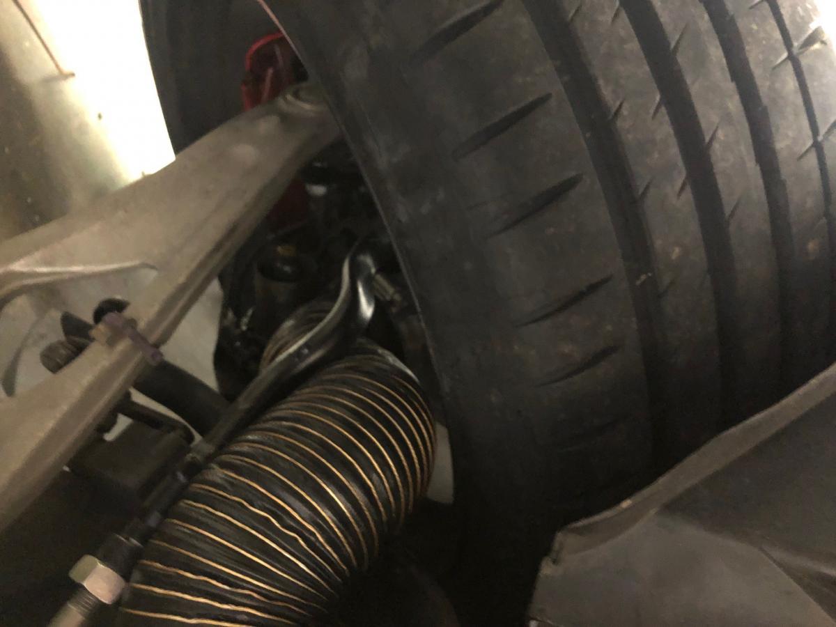

                          Whatever they call their pass through duct:
                          Which I like because it allows me to have steering at full lock without any rubbing:

                          And then their ducts that replace the entire fog light, which still looks stock enough that it doesn't bother me:
