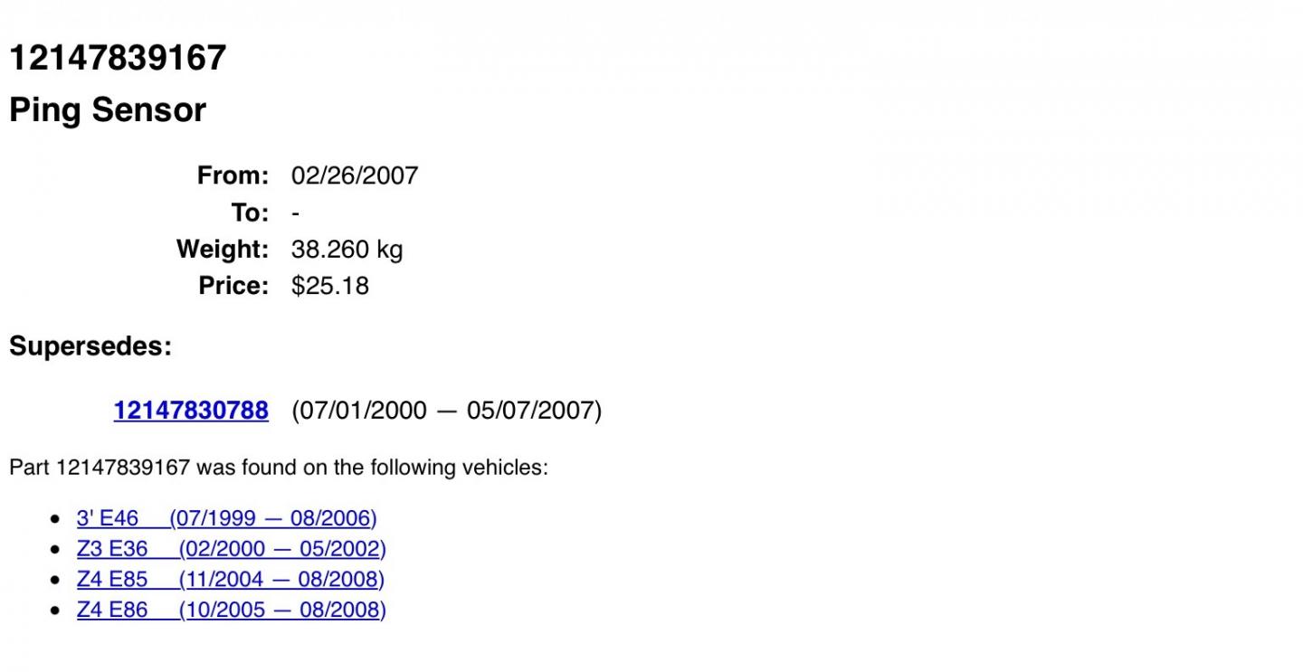

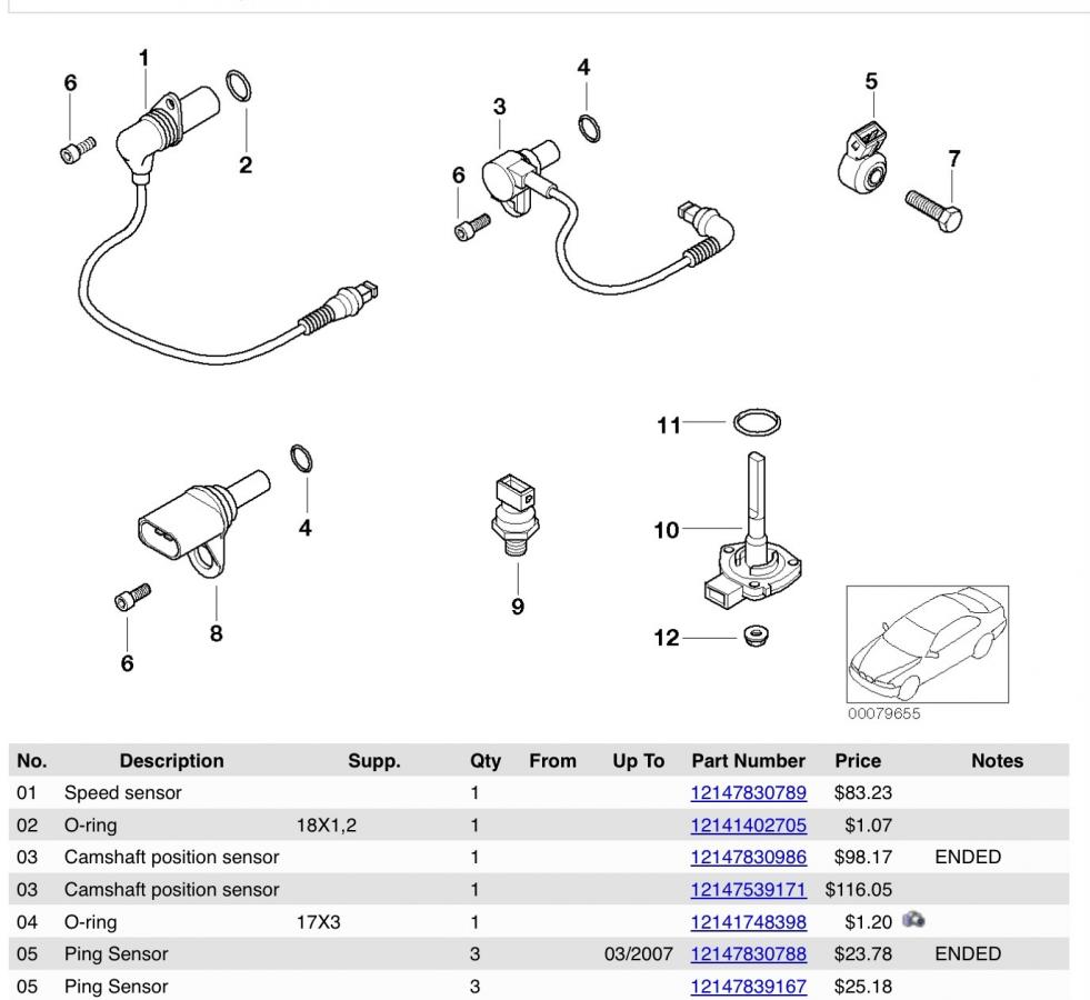

    When it comes to replacing ignition parts, use only what the car came with. With this in mind, the BMW online parts reference site Real OEM provides this info on this knock sensor.
ID:	206236 Part Groups is the knock sensor with the corresponding part number.

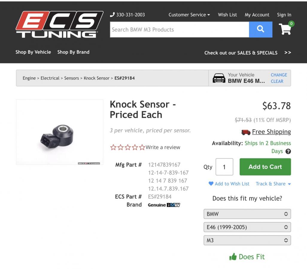

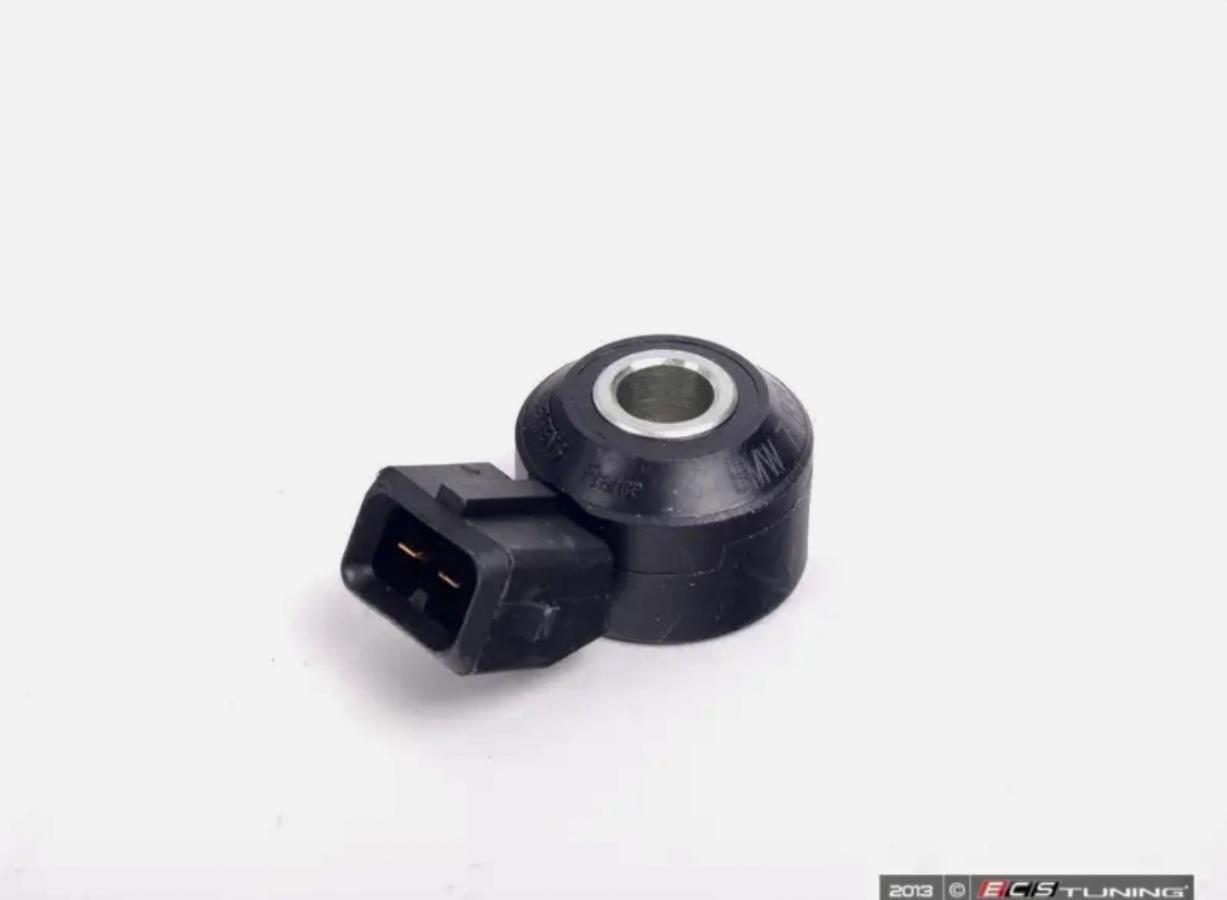

    The parts retailer ECS is a great site that shows discount pricing in U.S. dollars, and pictures of the part.

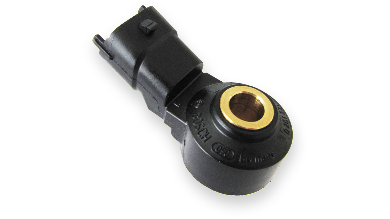

ID:	206239 Do not use any other parts unless they are other OEMs who make the part to BMW’s specifications. Just because a M3 uses Bosch parts and that “Motorsport” sensor is Bosch, this does mean it will work on the M3 simply because it’s a Bosch part - don’t use that “Motorsport” part.
      also, the connector seems different too. as above, just get the original part.
        According to the pictures on ECS, Siemens makes the sensor for BMW.
          Siemens sold the VDO Division a while ago, should be Conti now.
