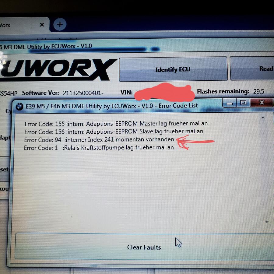

    I have a different DME than came with the car which would explain the first two codes in the list as they are EWS related. The last code is from me removing the fuel pump fuse to expell fuel before pulling the fuel rail.
    The third code down, code (94) I do not understand. I cleared it early today and went on a drive and it came back.
    I very recently installed the new DME to run CSL firmware for a MAP/CSL airbox.
    "momentan vorhanden" = "currently available"

    94 is inlet vanos adaptation.
    1 is fuel pump relay

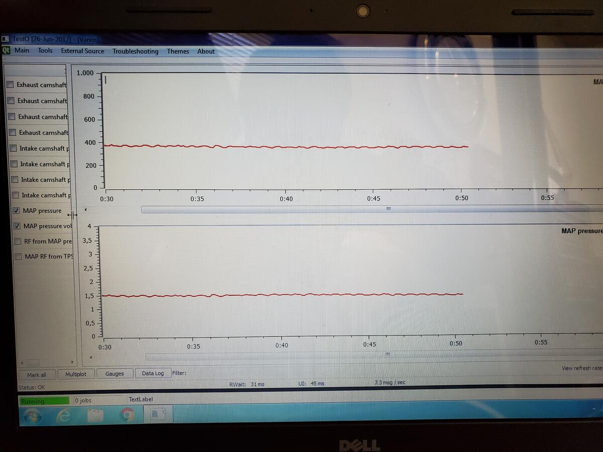

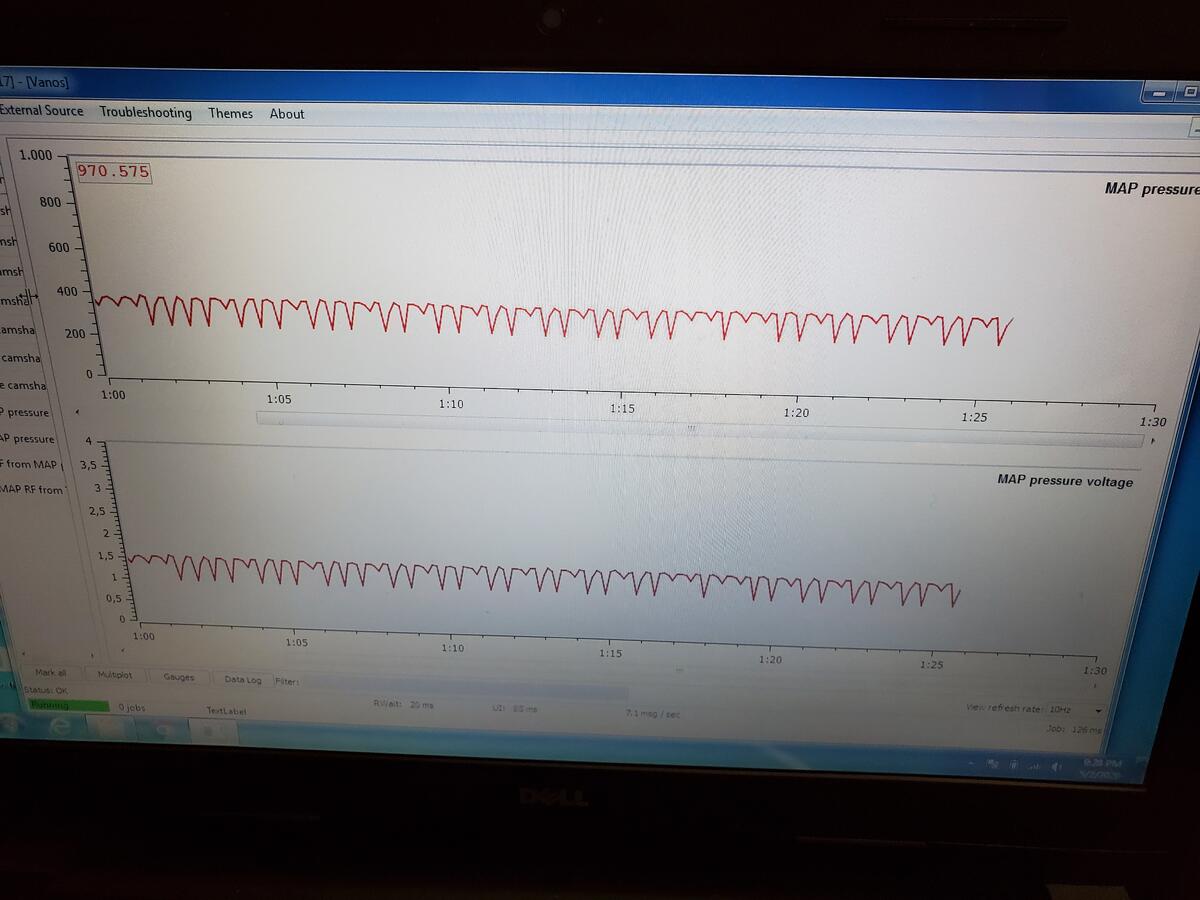

          Here is one more bit of information: I mounted my map sensor between a throttle body and the air rail and the reading were oscillating. Like this:
ID:	20699 Then I put the MAP in a different location and readings did this:

          Could the change in MAP position/readings have anything to do with this code?

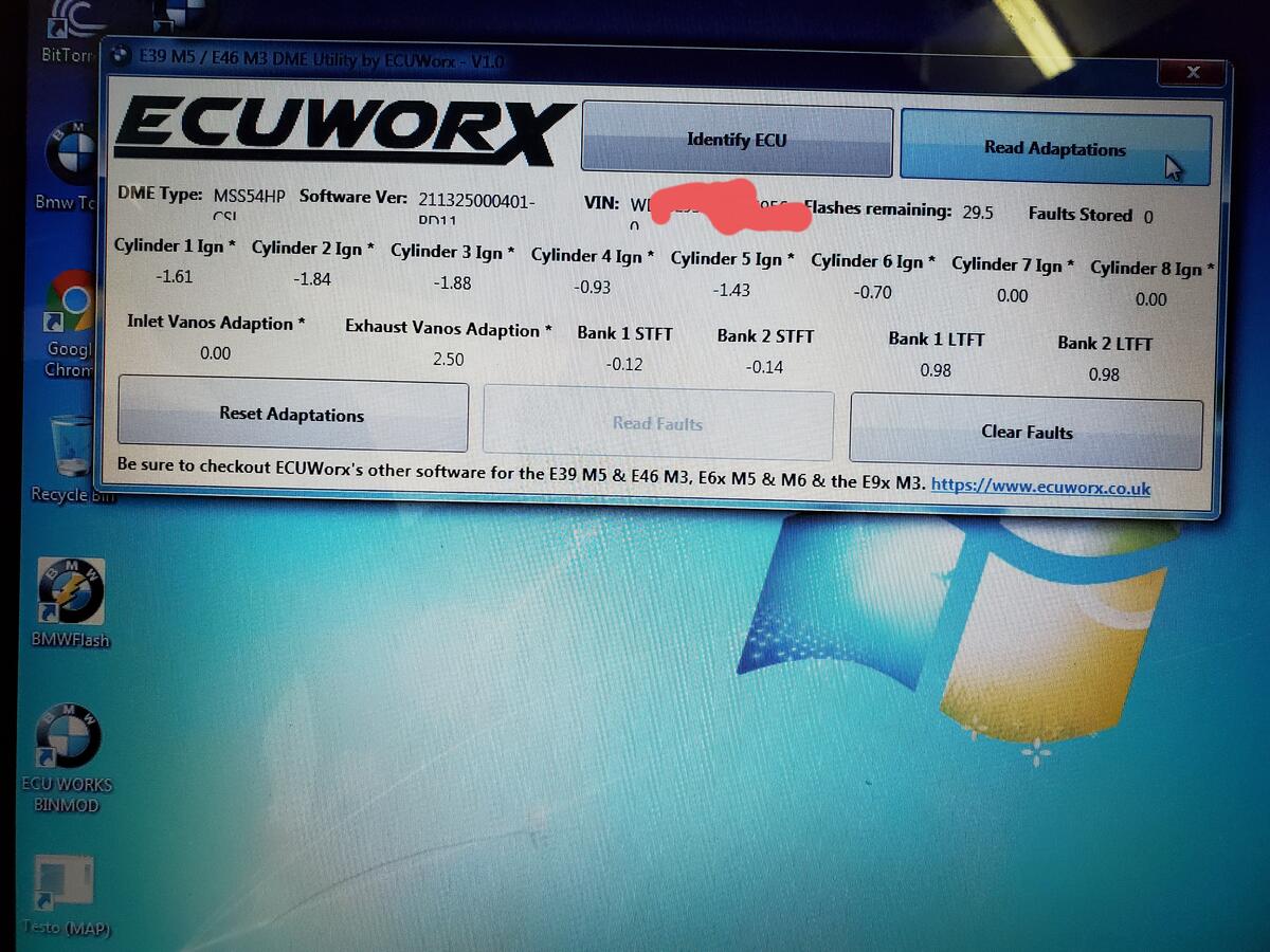

                Read adaptions real quick:

                  I'd probably clear the adaptations, faults and then run a vanos test.

                          Non CSL cams have different offsets to CSL cams so if your current vanos timing is very close to the adaptation limit and the correct vanos offset hasn't been set then it can cause vano related codes and can cause vanos test failure.

                            If timed properly, the difference between the US and CSL cam offsets is close enough that it would not cause adaptions to fail.
