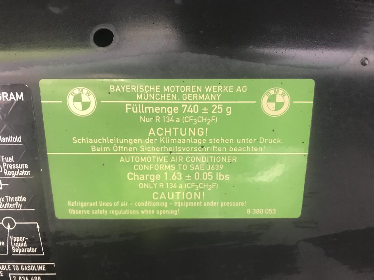

        you guys all have great points ! but the point of this thread was to try and verify if the capacities I posted are correct with the goal of me making a DIY when i do this on my 2005. People in the future can decide for themselves if they want to attempt this on their own or leave it to a professional.
        With that said, can some of you verify the above capacities I posted with the sticker under your hood?

            thank you, what year?
            2007 Imola Red Z4M Coupe
                05. I don’t think there’s a true difference year to year

                        I would like to evacuate and refill my refrigerant. I vaguely remember from M3F that the capacity was different for the E46 M3 throughout the production years. Unfortunately I do not have the luxury of looking under the hood for the sticker as my car came with a vorsteiner hood and the sticker is no longer there. Is there any way to verify the capacity by VIN or other information? Can anyone with a 2005 tell me what their fill capacity is?
                        Every E46 I have seen is 1.63lbs R134a. There may be differences for the Non-US 4cyl and diesel cars but I can't say for sure off the top of my head.
