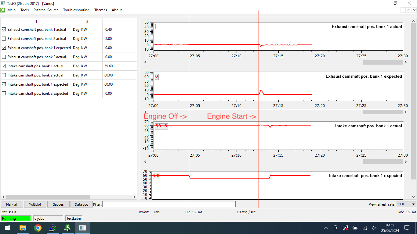

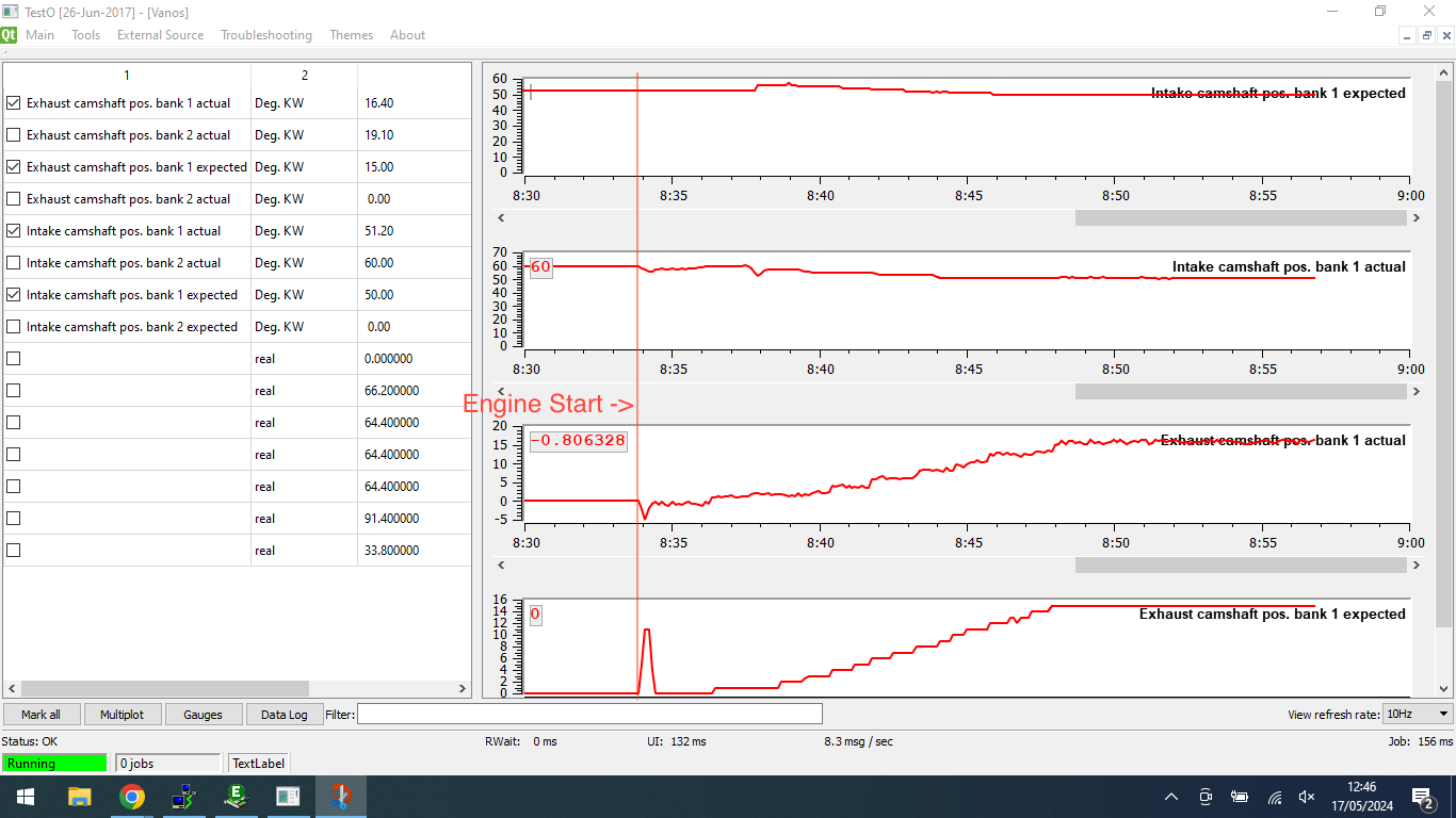

              Got TestO working graphing both bank 1 intake and exhaust camshaft actual positions and DME expected positions.
              I have no idea what the exhaust cam is doing when it fires up, but thats where the hesitation I feel is. This is a smaller hesitation than usual, but logging every engine start with my laptop is a ball ache. Video is of the same start, doesn't really come across well but it can be felt and heard in the car, this one being one of its better starts so hesitation is short.
              Car hasn't been used for around 2 days before this start, so cold engine.
              I'm assuming TestO reporting values for bank 2 is normal? With only 1 intake and 1 exhaust sensor, not sure where the exhaust bank 2 actual value is coming from in that left hand side table.

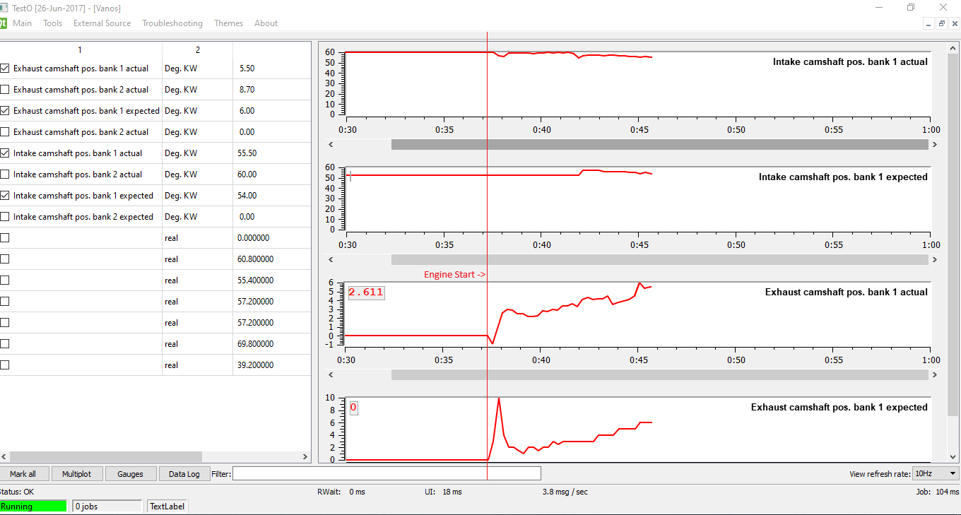

                Here is a good one, roughly 3 hours after the video in my above post. Hesitation at start and ran rough until RPM settled just under 1k:
                  First start after the car sat for a week while I was on holiday, hesitatesas the engine was trying to catch while cranking and then runs fine.
                  Click image for larger version  Name:	Capture Edit.png Views:	0 Size:	63.1 KB ID:	265923

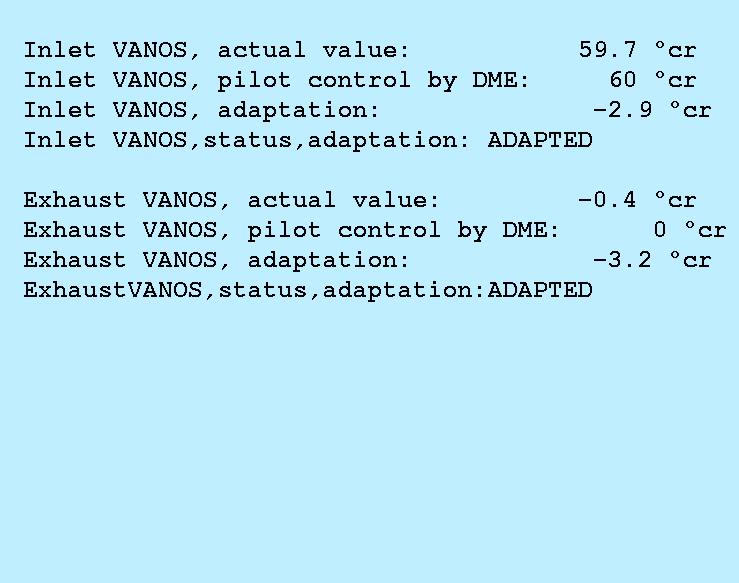

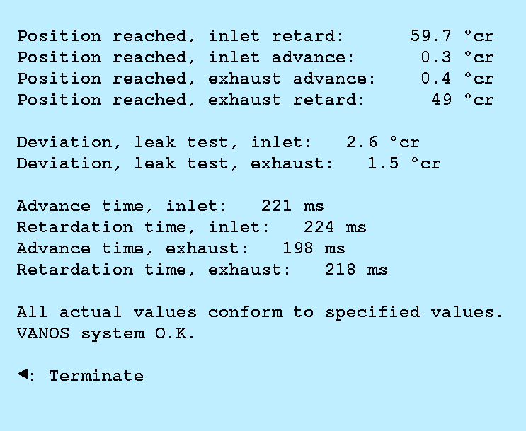

                        Just a small update with some data I have.
                        Results of VANOS test, and adaptations taken with DIS:
                        Click image for larger version  Name:	VANOS Test.png Views:	0 Size:	14.5 KB ID:	269364Click image for larger version  Name:	VANOS Adaptations.png Views:	0 Size:	11.4 KB ID:	269365

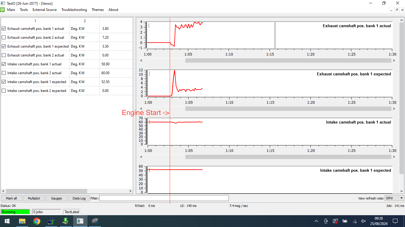

                        Cold start with hesitation, graph of VANOS intake and exhaust actual and DME expected positions:
                        Click image for larger version  Name:	Cold Start.png Views:	0 Size:	90.9 KB ID:	269366
                        Warm car running, key off and then engine start again, car did not hesitate this time but still has weird 10 degree jump on the exhaust positions:
                        Click image for larger version  Name:	Warm Start.png Views:	0 Size:	95.0 KB ID:	269367

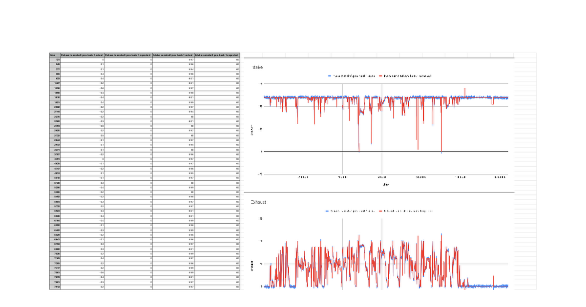

                        I also have a VANOS cam position log which was started just after the cold start graph. It seems that both cams do stick to the DME requested position with a degree or two of difference, so I think its working as expected.
                        There are a couple of rows I've highlighted in orange though where there is a 10 degree difference in the exhaust cam actual and expected, seems to be at engine stop and start.
                        The car did run super rough while it was testing the exhaust side of the VANOS which I'm assuming is expected as its fully advancing and retarding the cam?

                          Cold start ex vanos issue:
                          The ex expected is 3 degrees retard but the actual shows 50 retard. So the ex couldn’t advance from max retarded to 3 degrees retarded.
                            Scales for the graphs are different, exhaust cam actual is -1 degree when expected is 12 degrees for some reason. They then align to 3 degrees, +/- a degree.
                            However the same discrepancy is there when the car starts normally, so I don’t know if it’s actually a problem, or if the car just starts easier when warm even with this cam position difference on the exhaust.
                            VANOS test proves there is nothing wrong with the timing as it reaches the expected positions without an issue.
                            Don’t know if perhaps my exhaust cam position sensor is just doing a shit job at reading the cam on engine start, though if it was the sensor I’d expect drivability issues somewhere.
                            Also don’t know if that’s just how the DME works for the version I have.

                              Vanos test was done with warm engine and so it’s fine.
