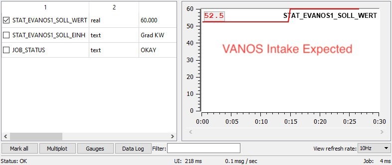

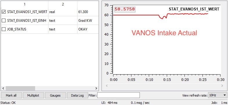

            Still haven't got around to getting the VANOS timing looked at, but pulled these graphs using TestO. Both graphs plotted at the same time and taken during engine start, and the wobble in the "Actual" graph is the engine starting and struggling to idle. As soon as it flattens out past the 15 second mark the car runs fine.
            Not sure why the "Expected" graph starts at 52.5, but this was the DME value in DIS for the inlet cam to get an actual reading of 60 degrees, so I'm assuming when the engine is off 52.5 degrees is the position its being left in and then it does some hunting of the correct timing when it starts next?
            No idea if it actually shows / proves anything, but figured it might be worth just keeping it documented in the thread.

              Originally posted by jamesfoley View Post
              1. Still haven't got around to getting the VANOS timing looked at, but pulled these graphs using TestO. Both graphs plotted at the same time and taken during engine start, and the wobble in the "Actual" graph is the engine starting and struggling to idle. As soon as it flattens out past the 15 second mark the car runs fine.
              2. Not sure why the "Expected" graph starts at 52.5, but this was the DME value in DIS for the inlet cam to get an actual reading of 60 degrees, so I'm assuming when the engine is off 52.5 degrees is the position its being left in and then it does some hunting of the correct timing when it starts next?
              1. The graph shows the cam wobbling during starting; I think this was due to the engine rpm unstable (DME reads the crank angle in order to come up with this cam angle value), and not the vanos itself struggled.
              2. I think you're right about the initila 52.5* at start up. The working spread angle for intake is [70 to 130*] relative to 0* at TDC, where 70 is advanced and 130 is retarded; at start, the intake should be retarded at 130 which is 60* in VANOS speaking (0* is most advanced at real 70* spread angle).

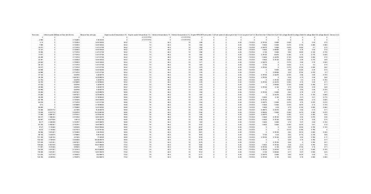

                                sapote Not sure if this is of any use? Pulled this using OBDWiz and my OBDLink SX cable as I figured it might be a little more reliable than bluetooth.
                                That spreadsheet has 3 sheets in it. The first is the car setting off after faffing with the logs and some town driving. The second is just pure warm engine idle. The third is town driving again after leaving the car for 45 minutes.
                                Annoyingly it didn't suffer from any start hesitation, just started as normal. No idea why it goes through bouts of being fine, and then bouts of being upset. Sort of wondering if it's directly related to the weather with it being more temperamental when it's cold outside.
