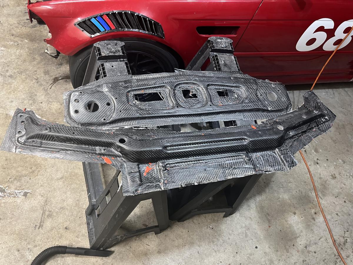

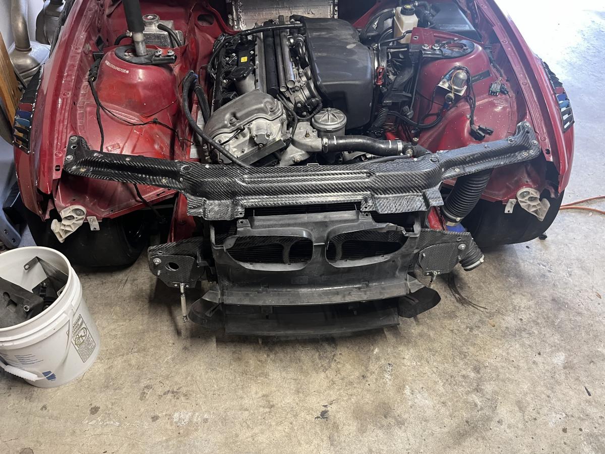

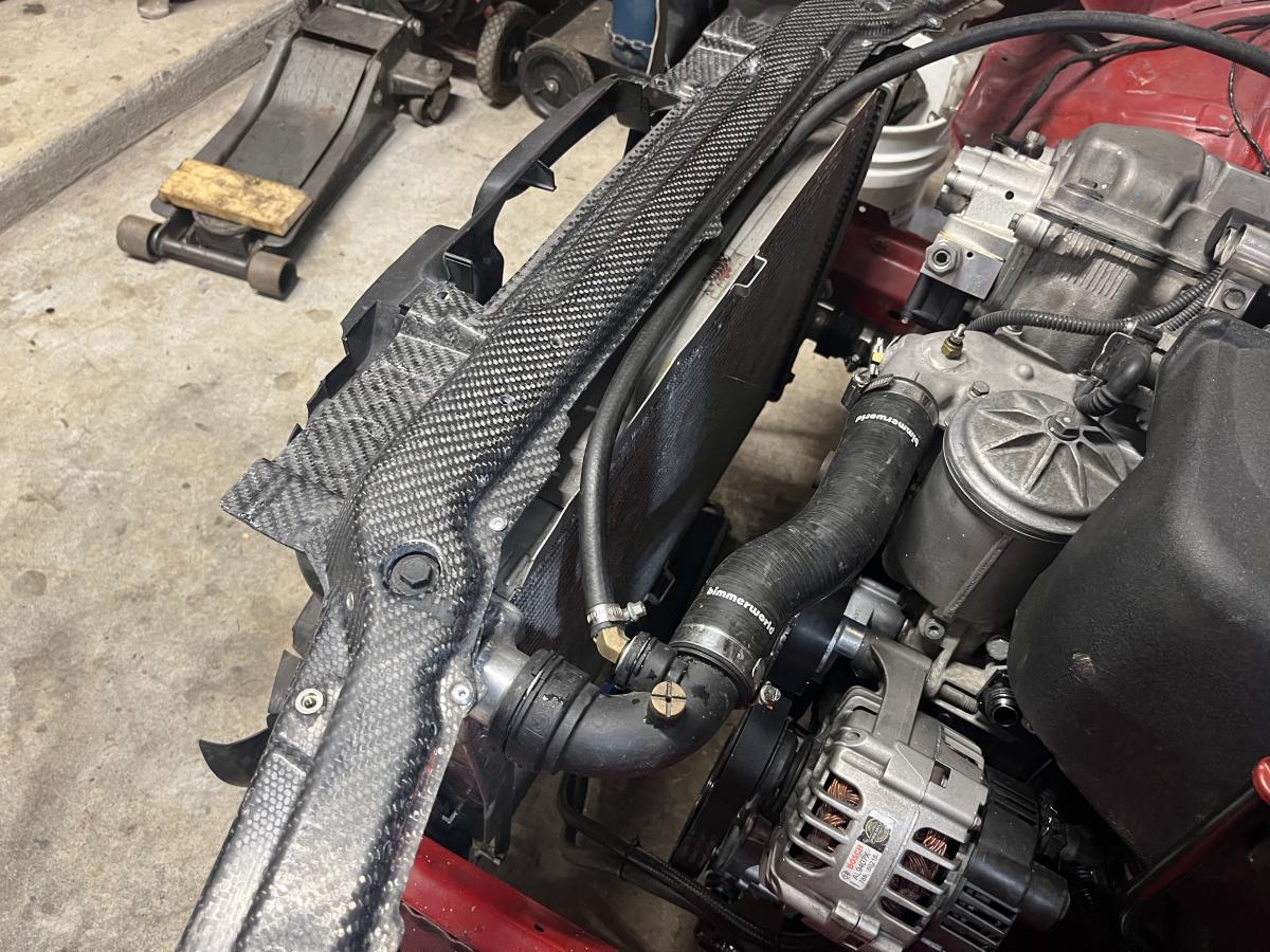

    A carbon fiber radiator support! 2lbs lighter and stiffer. There is a vertical piece that I deleted, not really needed. The carbon pieces could be lighter but I need some strength and stiffness in the bottom piece to support my splitter struts.

    The bad…I can’t screw in the rubber hood bump stops. I made the part too thick. If there is a next time, don’t lay core around that opening. Not a big deal since I use hood pins which have a rubber stop on them. So now I can delete the OE stops and save some more weight! 🤣

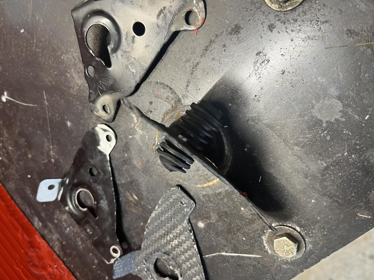

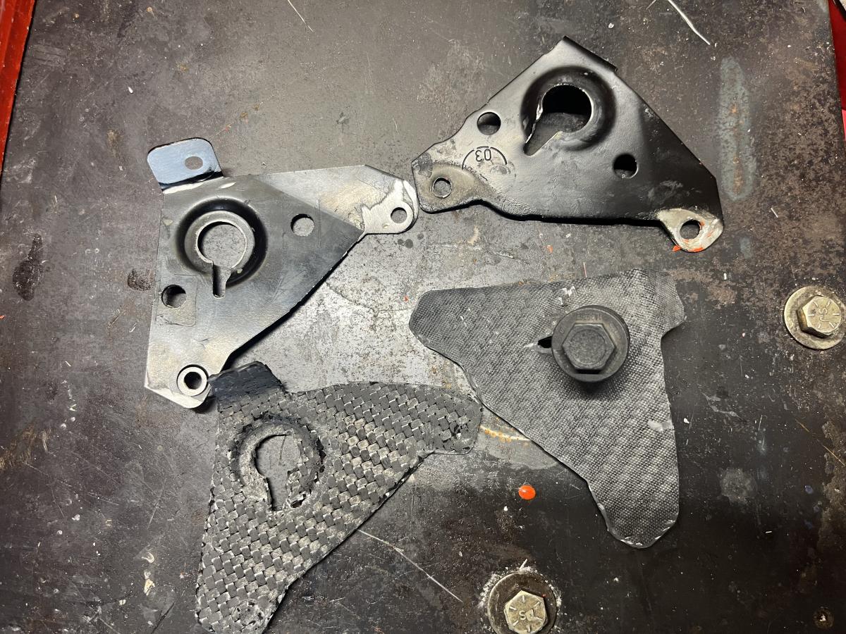

    The good. Stiffer, lighter and stronger. May not be as crash worthy but YOLO. The stock part has a bracket riveted where the radiator support screws go. I was able to replace that part so the radiator mounts like OE. Really happy that worked out.
    Why? Because I can. And I am trying to get down to 2525 lbs (no driver/no fuel) so I can put in a new roll cage with 1.5”x.095 tubing - would put me at 2475 which might make it the lightest E46 M3 in the world. Right now I’m right at 2600 with a weight distribution of 51.58%. I’m 40lbs over on the axle. I really need to find most of the weight loss over the front axle. I can move my seat back another 1”-2” but the cage won’t allow. Something I will need to account for when I build the new cage. Figure I need to lose 50 lbs over the front…I have a plan!

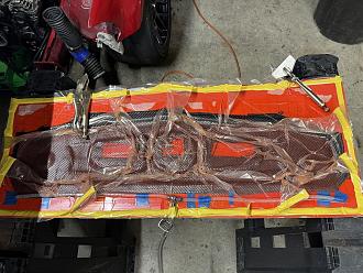

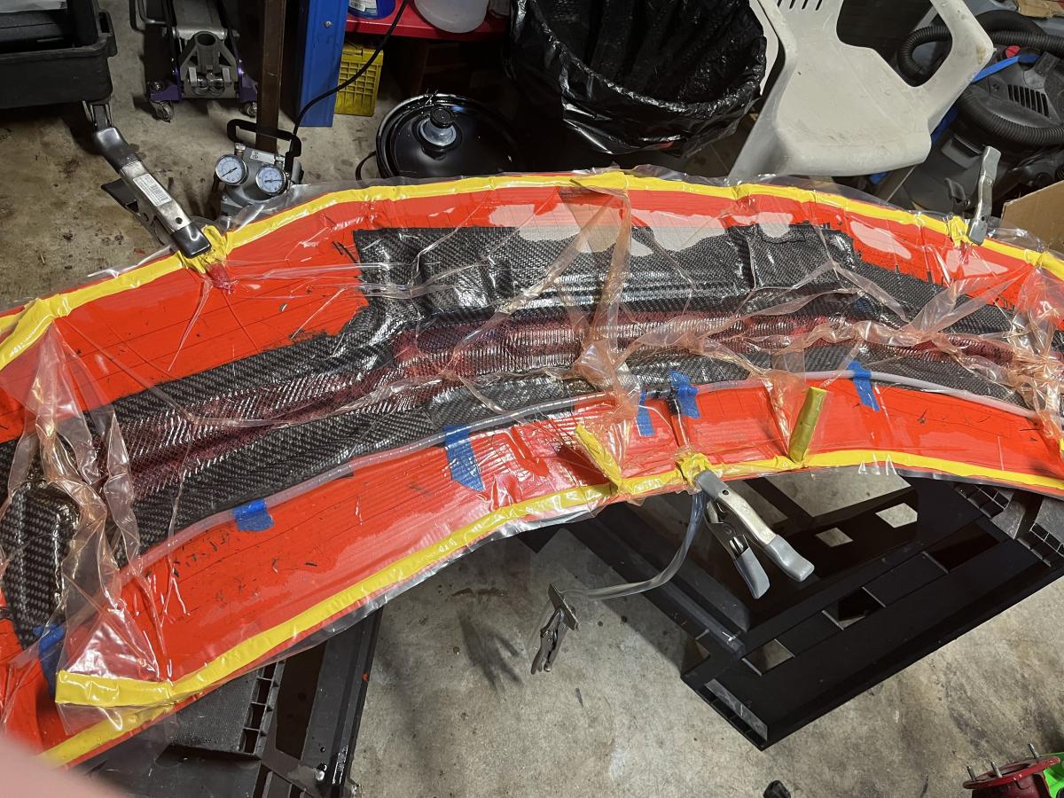

    Infusion completed...

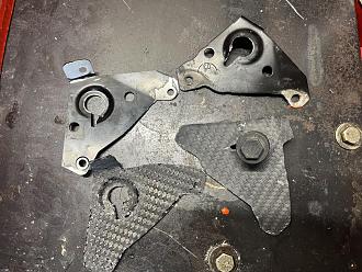

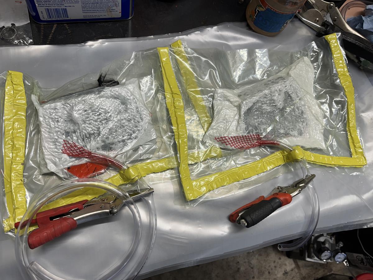

    Hand laminated and then vacuum bagged the small panels for the radiator mounts

    As it came out of the molds.

    Here's the detail on the radiator mount brackets
