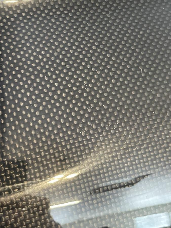

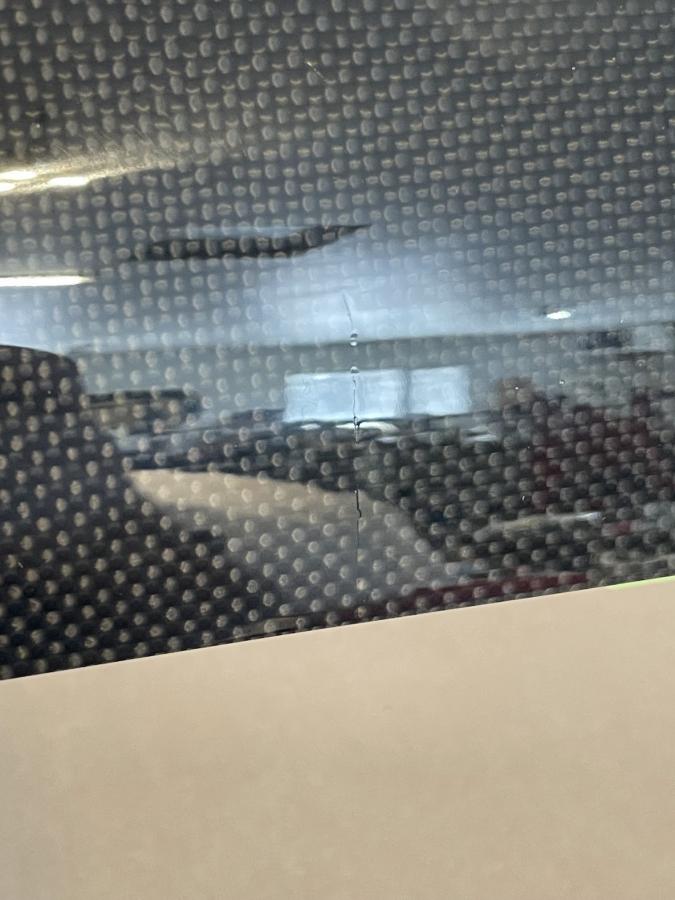

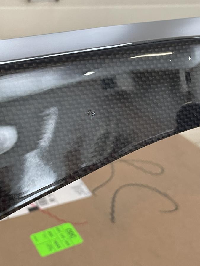

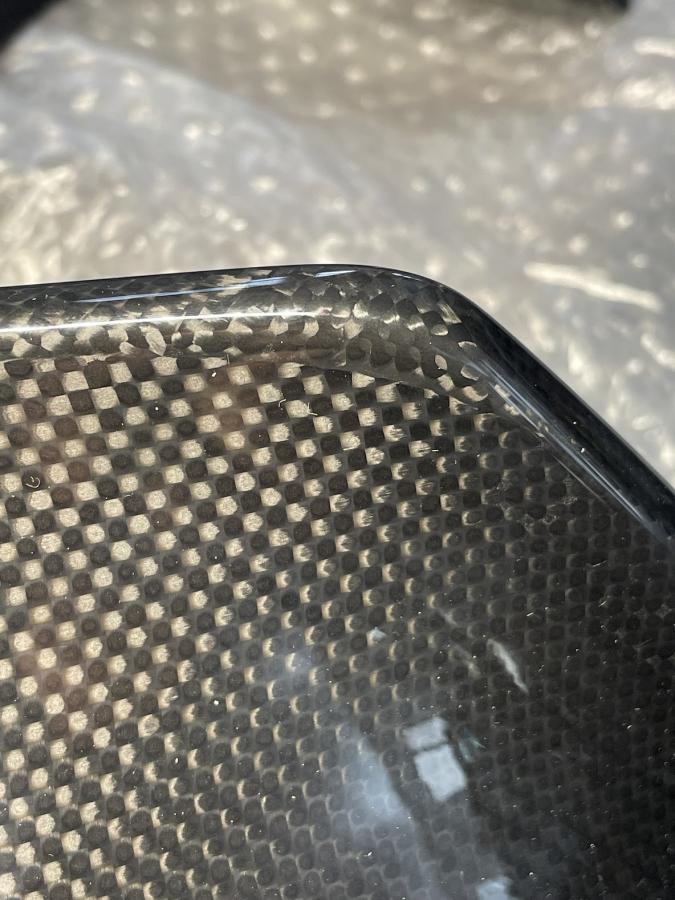

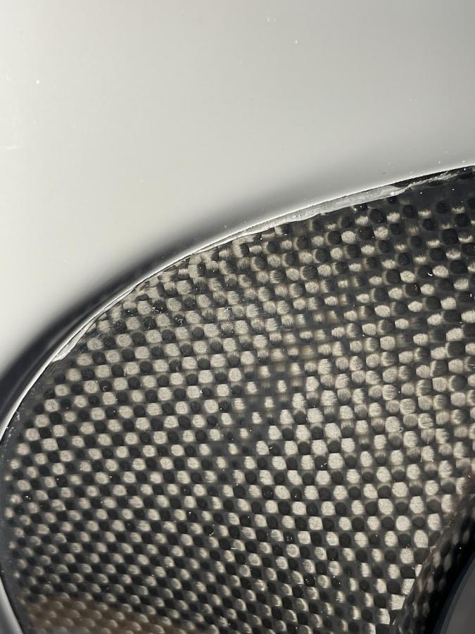

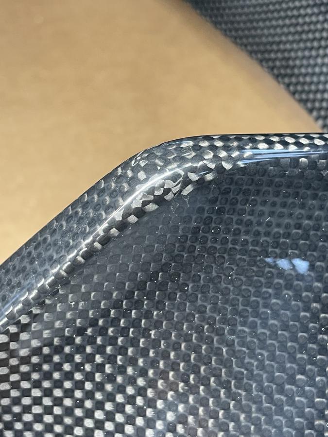

    I purchased an OEM CSL diffuser through ECS back in August and just received it a couple weeks ago. I was quite disappointed in the quality of the carbon fiber, it has quite a few cosmetic defects. While I know 1x1 carbon can be tricky I figured for the price, and it just went up again, and it being OEM it would be close to flawless. There's quite a few air bubbles, distortions in the weave and there's even 3 different layers showing. I attached only a few pictures, but there are more blemishes than just these. I'm currently discussing with ECS what can be done about this but I was wondering if this is the expected quality of the OEM parts nowadays?

      Unfortunately, some of more current batches (after 2017ish) can have defects. It seems that the QC is lacking for these older parts. You should try and get another if you are set on OE. The 90k LSB M3 that sold on BaT had a OE CSL diffuser that was short on the ends leaving a gap where it met the bumper cutout.

            Some minor imperfections here and there; it's like orange peel paint on our cars. You'll survive dude. Get it painted, slap it on your car you can enjoy its looks.
              Funny. When I purchased my car, I was told it has an OE CSL diffuser installed. Looking at the diffuser, I didn’t believe it seeing as the weave wasn’t perfect. Looks like I do have an OE piece after all. Mine looks roughly the same, maybe a bit better. ECS (should) be willing to swap out the piece factoring in the defects. I’ve seen them exchange other parts for much less.

                    I'd suggest bringing this to a body shop - you're going to get it painted and they will reclear the lower section most likely. The weave deformation is to be expected using 1x1 weave on complex curvature. You're probably going to be disappointed in a replacement version, the same will most likely happen.
                      The imperfections on the clear can probably be fixed, but if the weave inconsistencies bother you, you might be better off returning or selling the OE diffuser and buying a CarboProject diffuser at 1/3 of the price tbh.

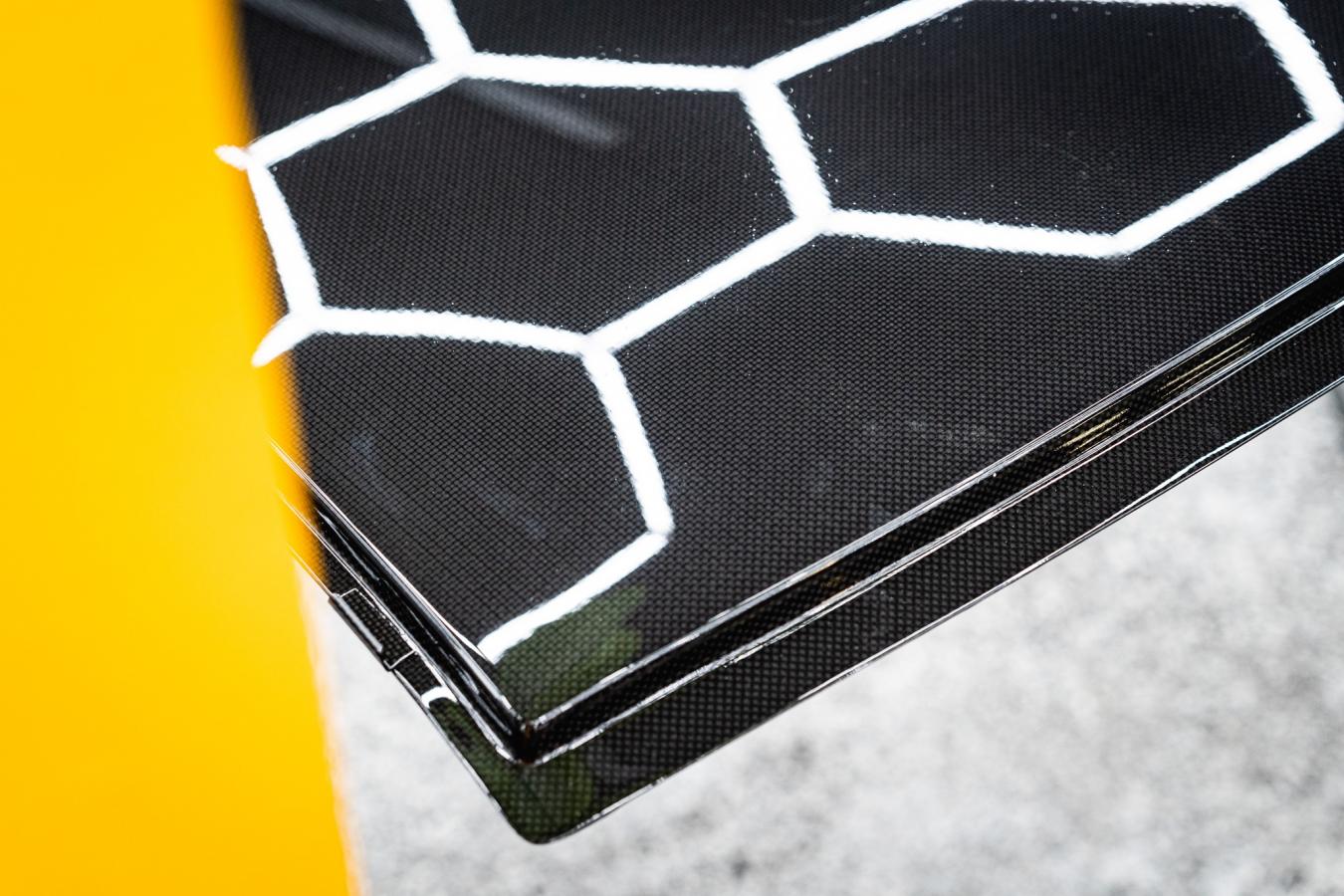

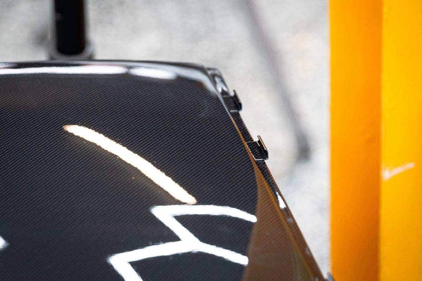

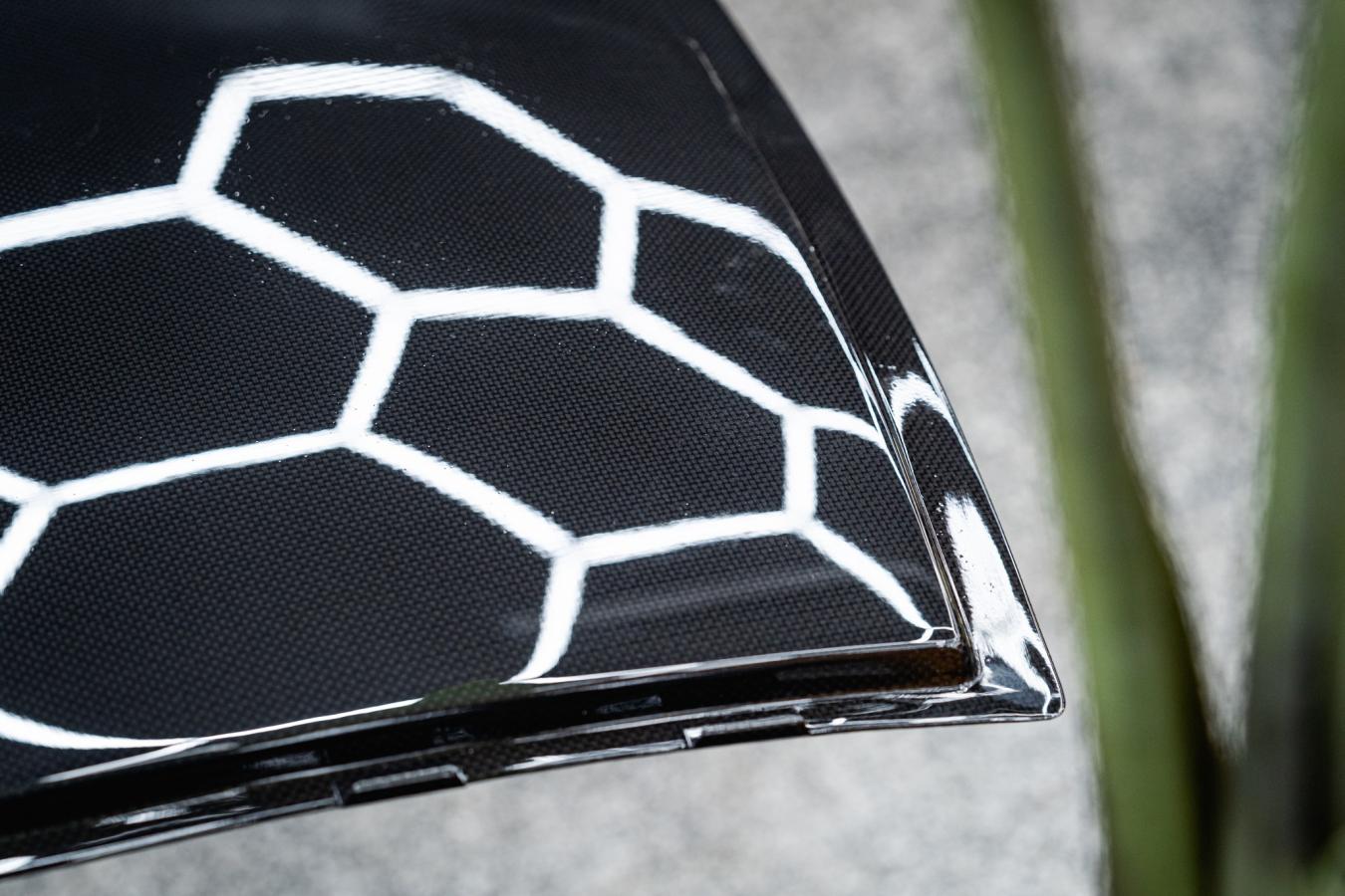

                          Here's my CSL Karbonius roof which we had to entirely reclear.

                              The only one of those pics I consider bad is the crack. I'd return it for that. The others don't look bad and can be addressed.
