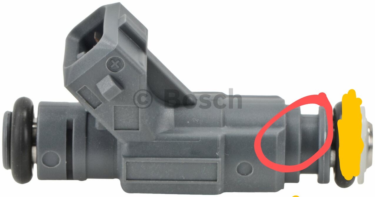

    dl.m3 ZiMMie Just received the 62431 injectors. Did y'all remove the white plastic ring and o-ring, and install an OE o-ring in the OE injector location? That was my plan, but I'm worried I'll damage the injector if I try to remove the plastic ring. It's on there pretty tight.

      Move the O-Ring up top (red)
      remove the white plastic (yellow)
      Done!

        ​How did you remove the white plastic ring without damaging/bending the metal?
        Edit: Figured it out. I was using non-serrated needle nose pliers which kept slipping. Came off easily with serrated pliers.

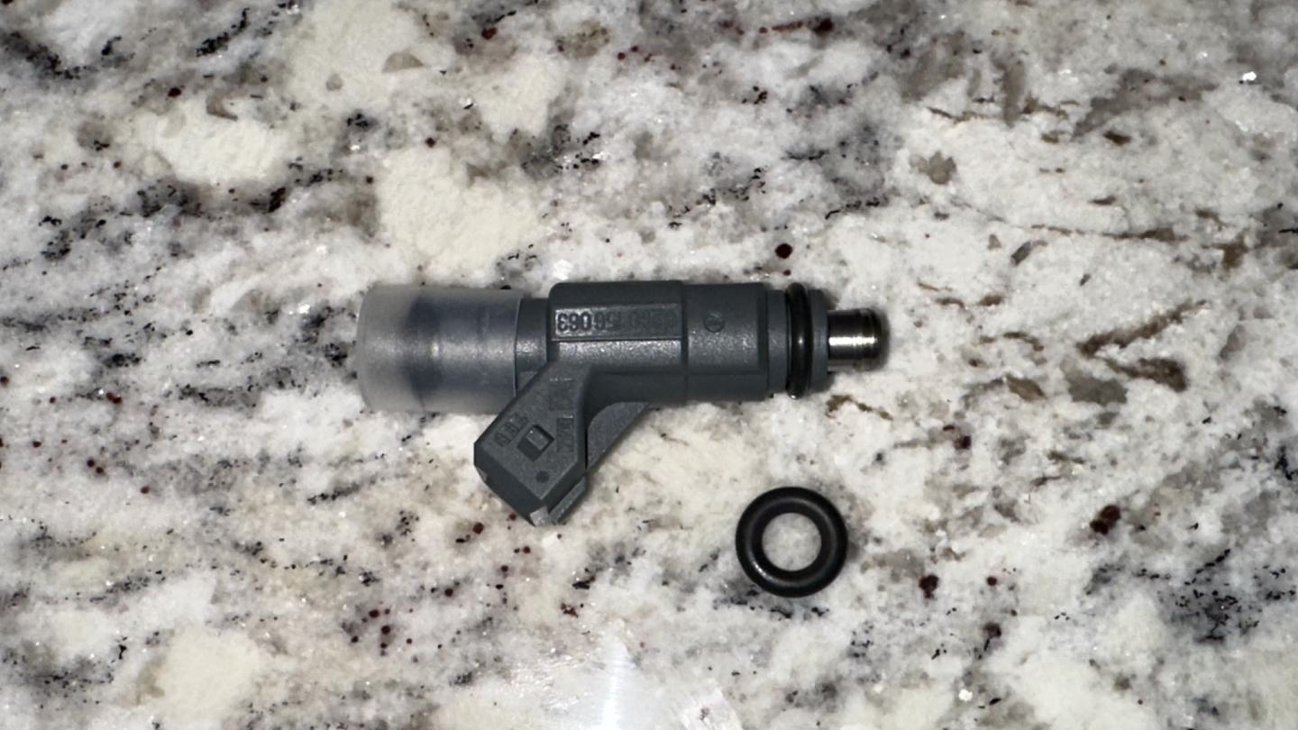

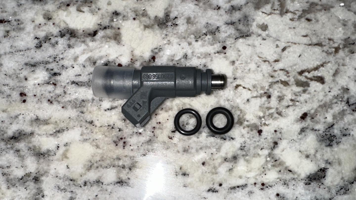

        OE o-ring on the left and o-ring that came with the injector on the right.
