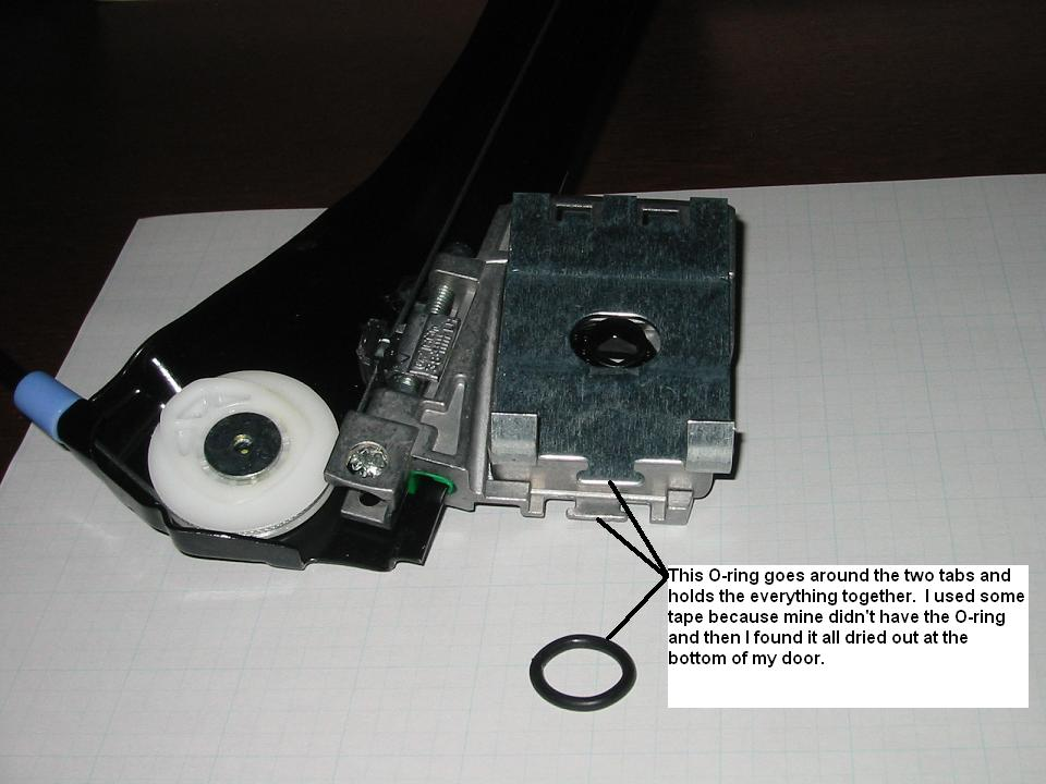

                  Ok, I think I have it figured out. A small rubber o-ring tightens the metal clamp on the rear of the two adjustment mechanisms. Mine is broken.
                  If I hold the metal clamp together with my hand, the wobble stops. Thus, I am fairly confident (hopeful) that the broken o-ring is my problem.

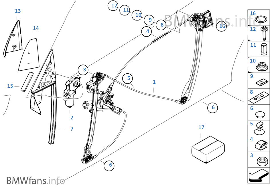

                  O-Ring / Grommet Part No.: 64-50-8-369-241. Exploded diagram attached. O-ring is # 16.
                  I will update when the part arrives. What an ordeal.

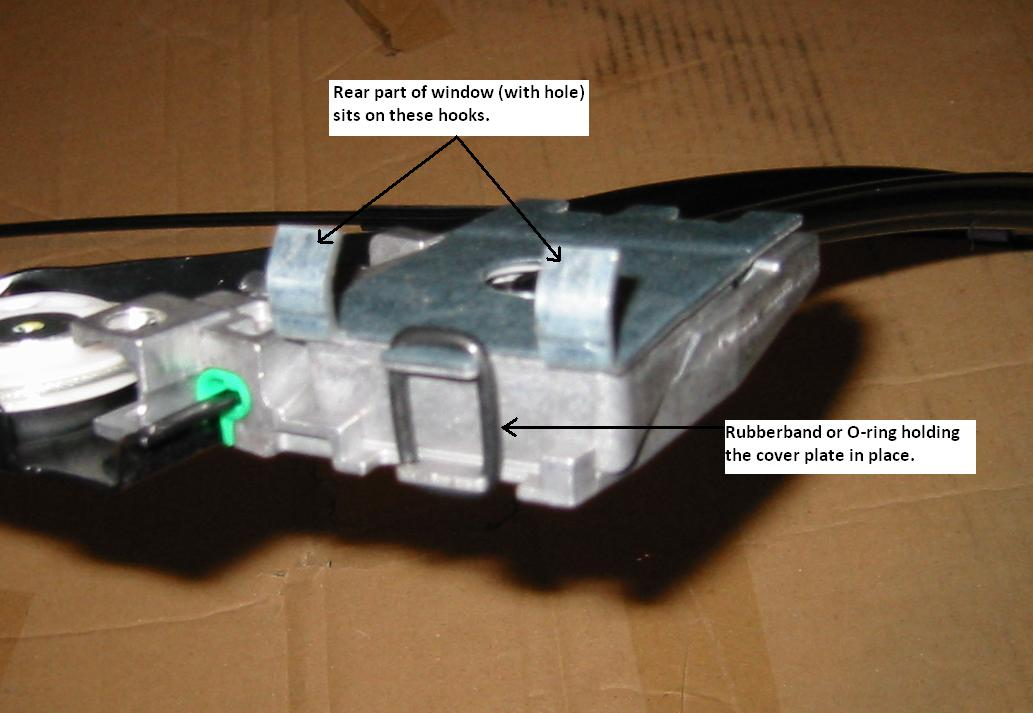

                        FWIW, I have my o-ring on order, but wanted to share a photo that I found (in another thread, on another forum) regarding the placement and importance of said o-ring. See below.
                        It appears as though it holds the entire adjustment/tensioner mechanism together. Assuming there is play in my mechanism, this would explain the play in the window and the free spinning 13mm nut that isn't getting any purchase against the adjustment wedge inside the mechanism.
                        Also of note, the "hooks" shown below are the "channels" I referenced above in Post # 8, Bullet Point # 2.
