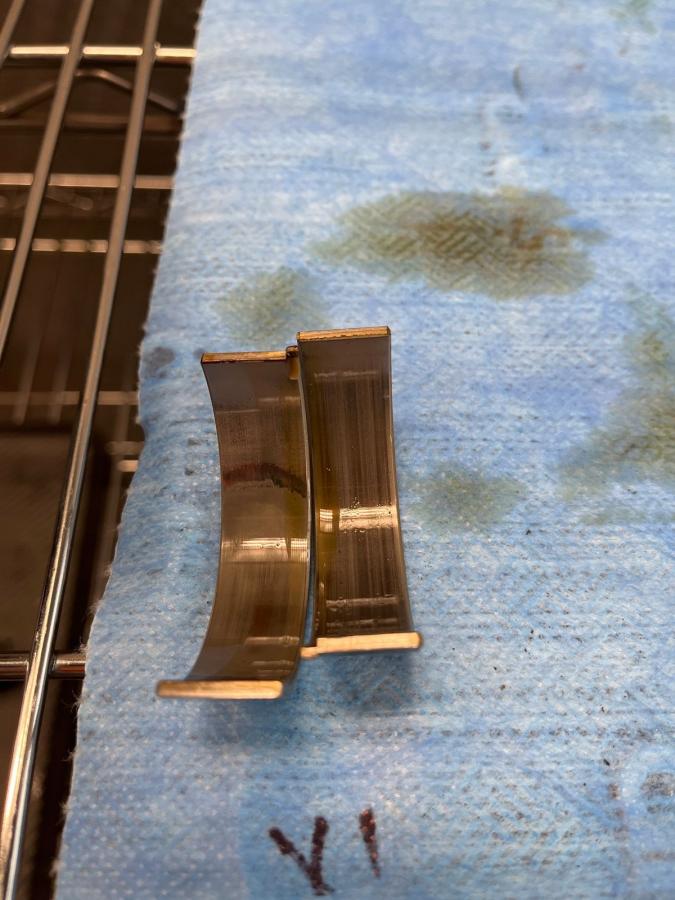

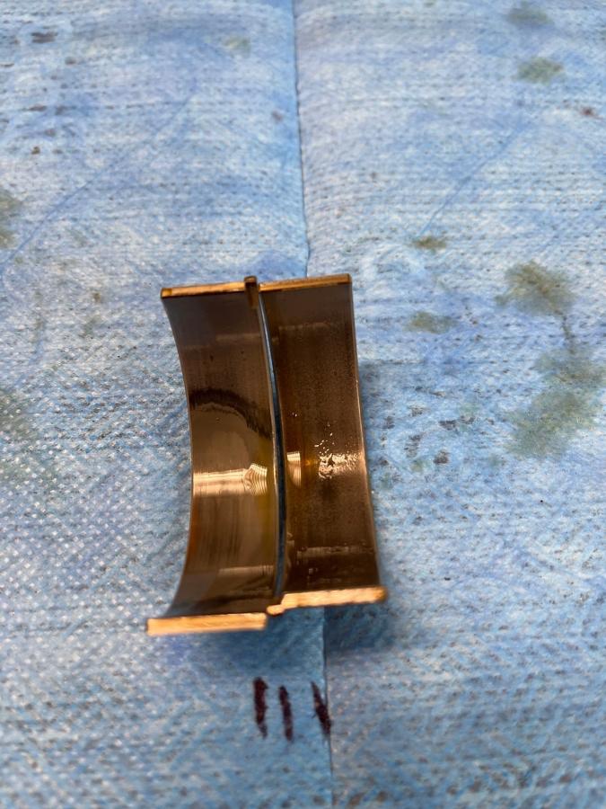

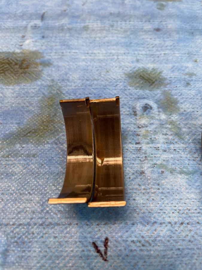

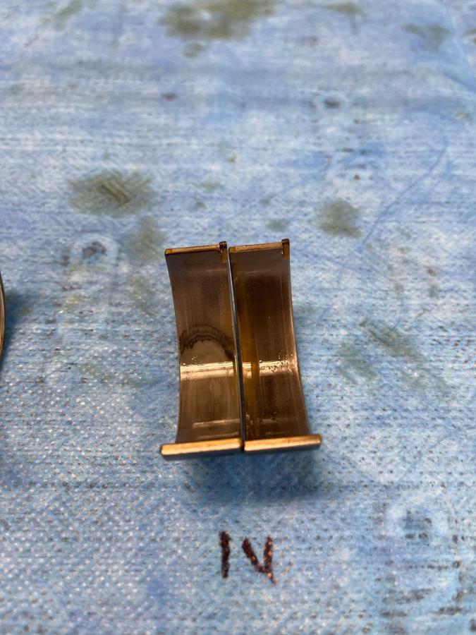

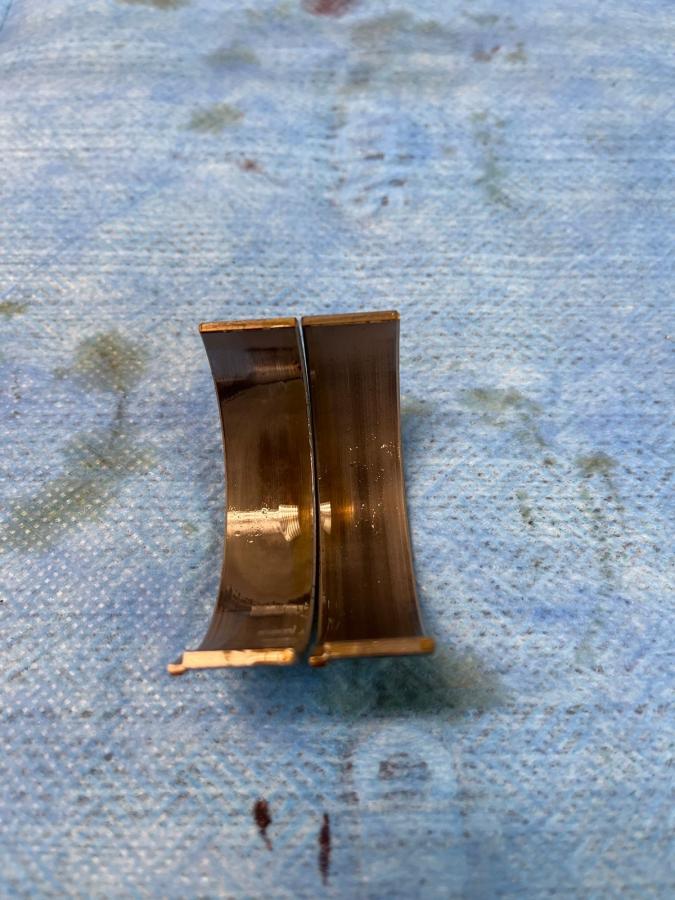

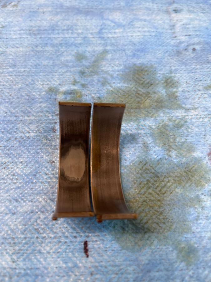

                Here are the pictures of the road bearings they took out, glad I decided to get these done.
                  Ha, that’s crazy. Hard to tell from the pics, but do I see copper?

                      Seems like a waste of parts, time and $. With regular oil changes and warm up procedure, these bearings easily see 80-100k with non-track use. On the post above, that is pretty standard wear and nothing was failing even at ~100k miles, which is double the miles you are suggesting. Almost every bearing replacement done now won't need another replacement until the entire engine needs a full rebuild.

                        Seems like a waste of parts, time and $. With regular oil changes and warm up procedure, these bearings easily see 80-100k with non-track use. On the post above, that is pretty standard wear and nothing was failing even at 150k miles, which is triple the miles you are suggesting. Almost every bearing replacement done now won't need another replacement until the entire engine needs a full rebuild.
                        My 01 with about 50k on the rod bearings and lots of track days. I try to stay under 3k rpm until the temp needle reaches the first dot, then under 4k rpm until fully warmed up (needle at ~11 o’clock). Guess what I’ve been doing is working just fine.

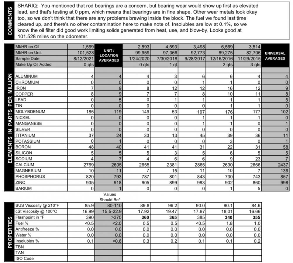

                          Not sure, it is a bit hard to tell. Can definitely see lead wearing. All I know is that both lead and copper have been trending up slowly over the past 5 years, I'll post the analysis in the big rod bearing thread once I get the latest results back.
                            Just to be clear, that was 150k kilometers, not miles. I do agree with you, 100k miles seems like a good interval

                              Ah, didn't see KM. The few that I have seen at that 100k mark look like that with the uppers just getting into the copper. Really depends on how the previous owner(s) used the car, but under current ownership, the bearings might fair better.
