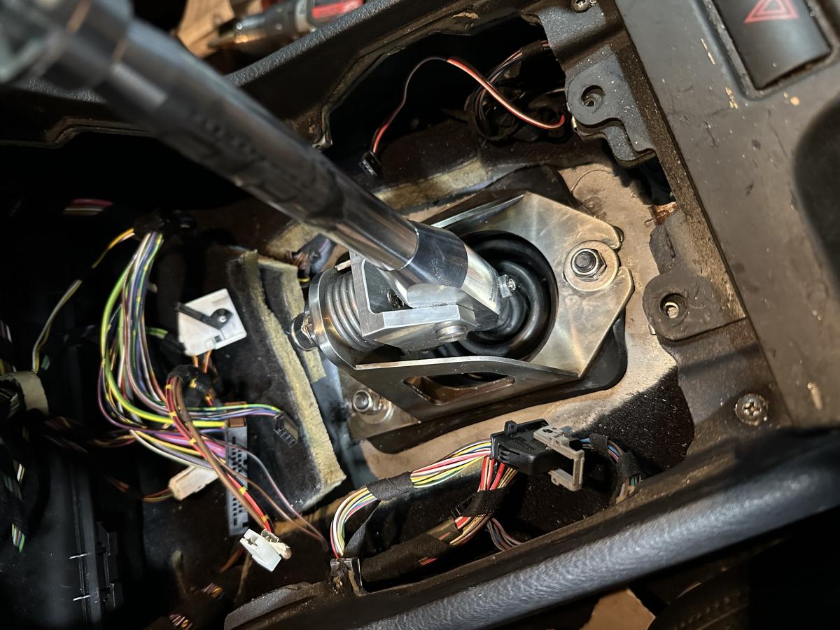

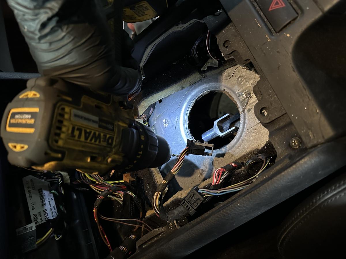

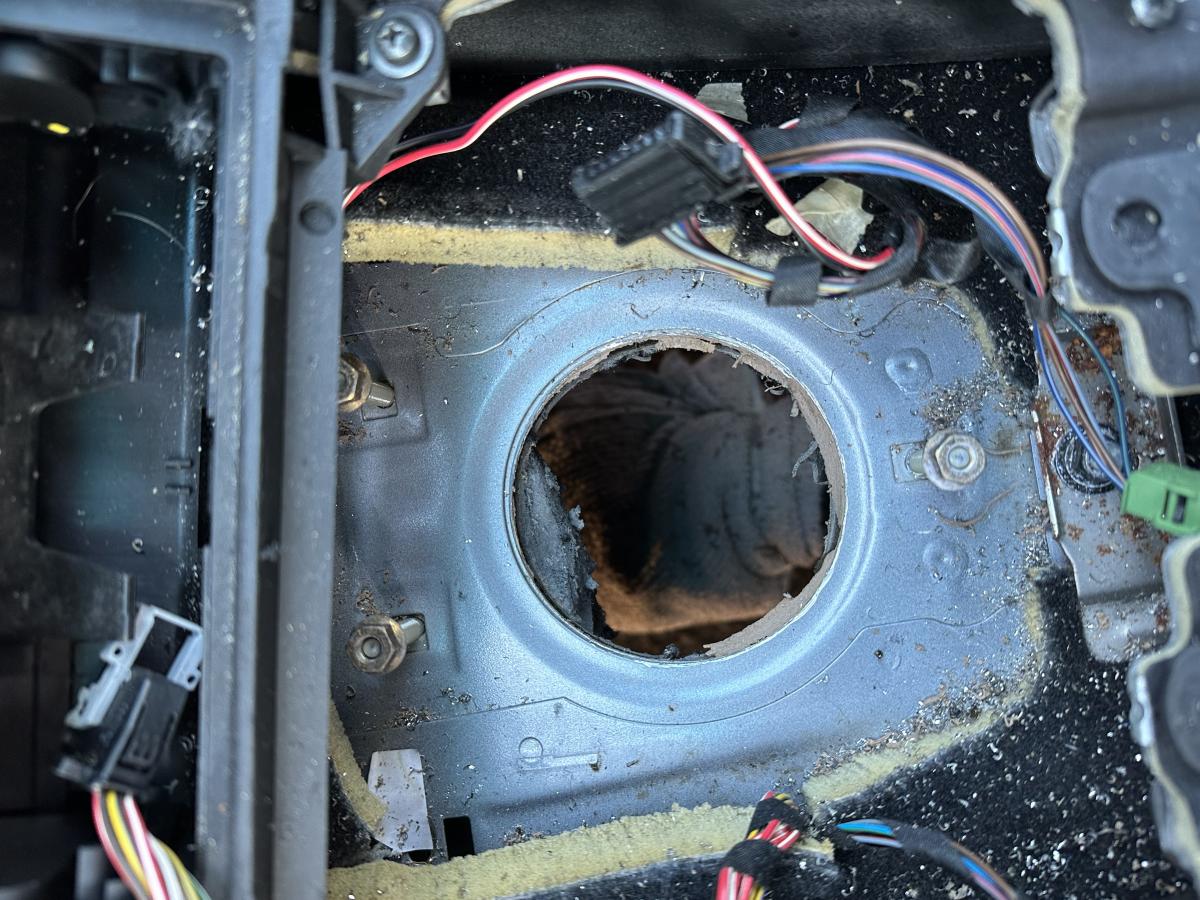

    PSA - if you’re installing rtd shifter on smg, make sure the existing studs are centered or you’ll have to drill out new holes. Mine were too far to the passenger side so reverse kept popping out. Another guy I saw was too far to driver and couldn’t get into 3/4 properly.
    Also the spectre 6285 boot fits perfectly.
