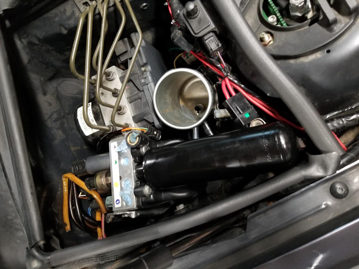

    Does anybody offer a bracket or is it even possible to relocate the SMG pump to drug pin with MK20 ABS? I already have the CSL reservoir, hydraulic lines and harness.
    You may want to check with MLR Engineering (mlreng.com). They once offered a relocation bracket, not sure if they still do. But they do offer a large selection of SMG parts and will gladly offer assistance.

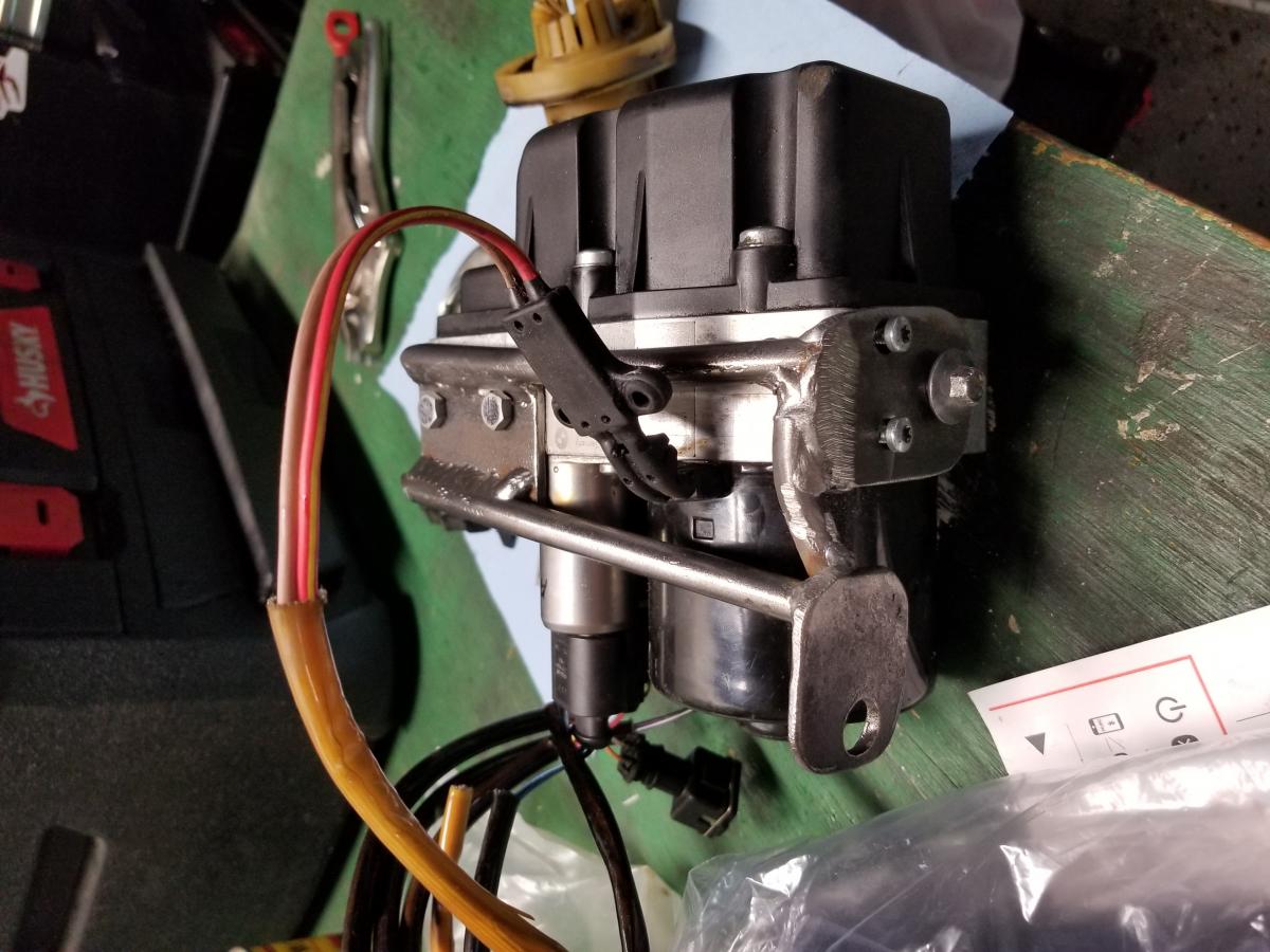

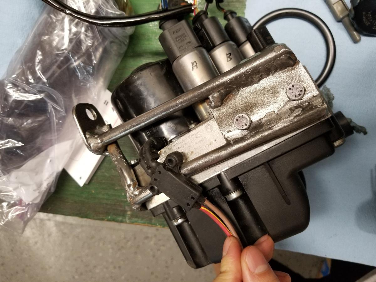

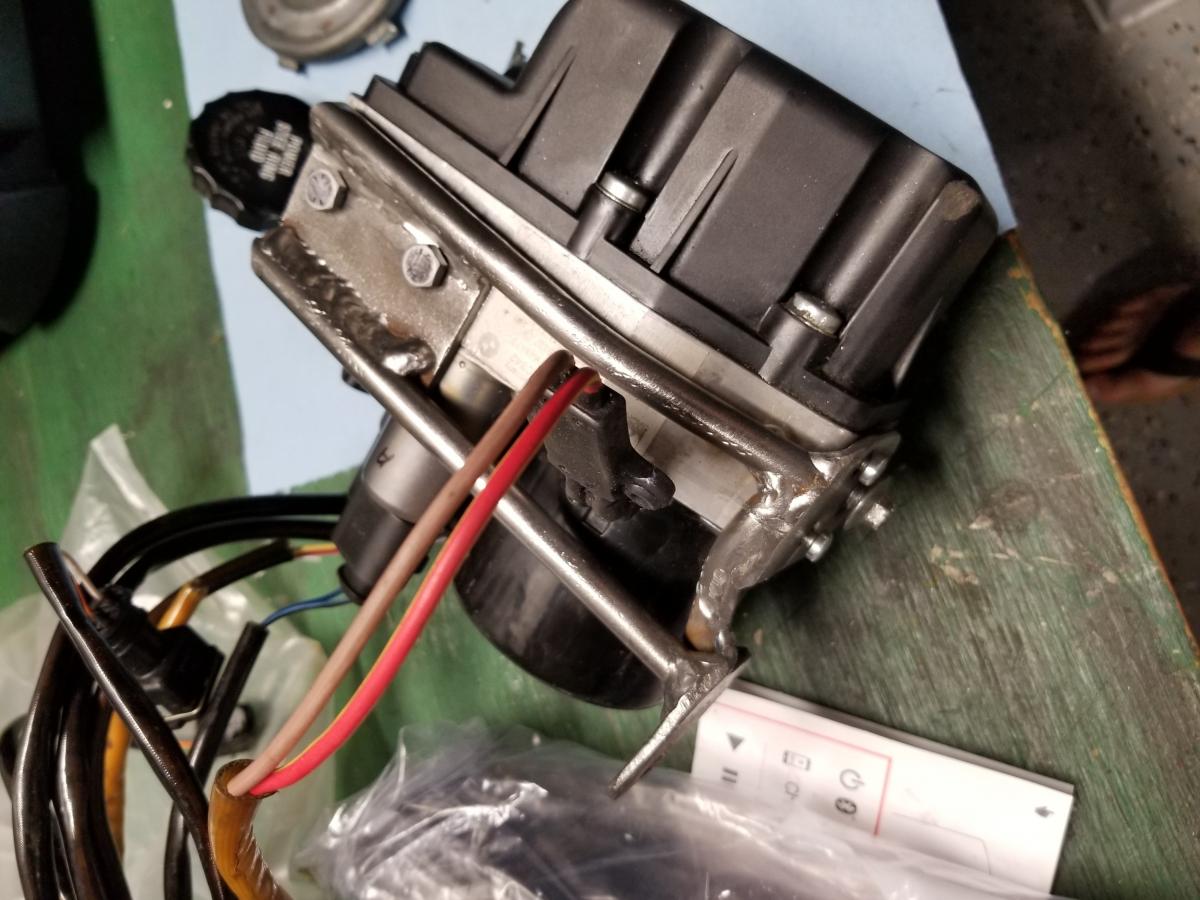

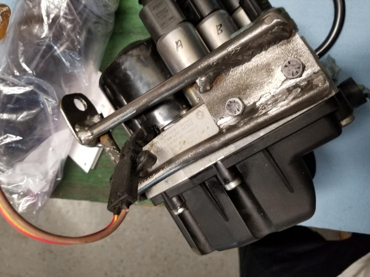

      I had to custom fabricate mine with a friend. He used simple plate steel and a few tack welds to keep the pieces together. It wasn't super difficult but you would need a welder, method to bend the metal, and some bolts. I uploaded the images below: Click image for larger version

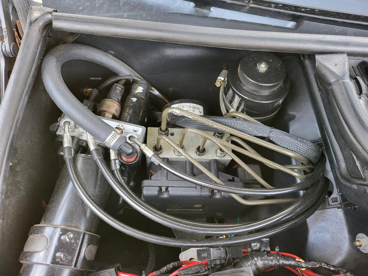

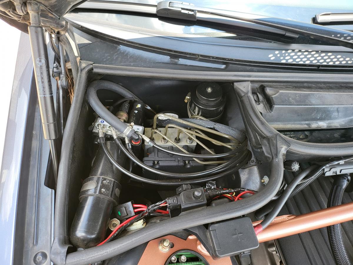

        That’s really going to be a tight fit. Have you decided on how you were going to run the hydraulic lines? That was the problem that I had.

            This is how it has been for the last couple of years. Those earlier ones were during my install process lol.
