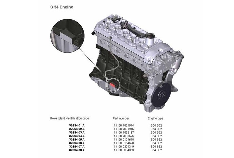

    Hello guys, I am about to do rod bearings on my car and since I will have very limited time on my friends car lift, I need to order all parts prior to the service. My concern is- I know that my car had engine replaced in the past, but I don’t know if there is updated version with better oil pump and M10 connecting rod bolts or pre LCI version with M11.
    Is there any way how can I identify the engine prior to opening it?

    look at my post history, I have a thread on this recently. Engine block has a code, use realoem
      You can check the block tag and run it through RealOEM.

        Earlier pre-facelift (some 2001)S54 have a different valve cover, it’s cast differently and look more flat on top of each valves.
