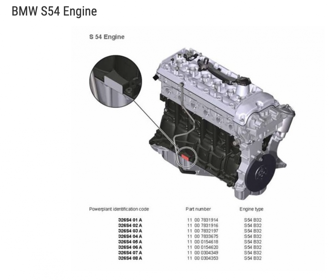

    You'll need to figure out the engine serial number, which is located here.
Name:	Screenshot 2023-04-14 at 2.04.30 PM.png
    After that, run the number in Real OEM and you'll know when the engine was manufactured.

      Remove the underbody panels from the car, and check on the exhaust side of the engine where the block and oil pan meet.
      There should be a little rectangular area where the engine number is lasered into the block, usually starts with a 6 from memory.
      Once you know your current engine number, PM me your VIN, and I can tell you what your original engine number was, if they don't match, your engine was swapped.
      The engine number I am referencing is not simply a generic part number but a unique number to your engine, since the method described by the user above wouldn't work if the donor vehicle had a similar build date.

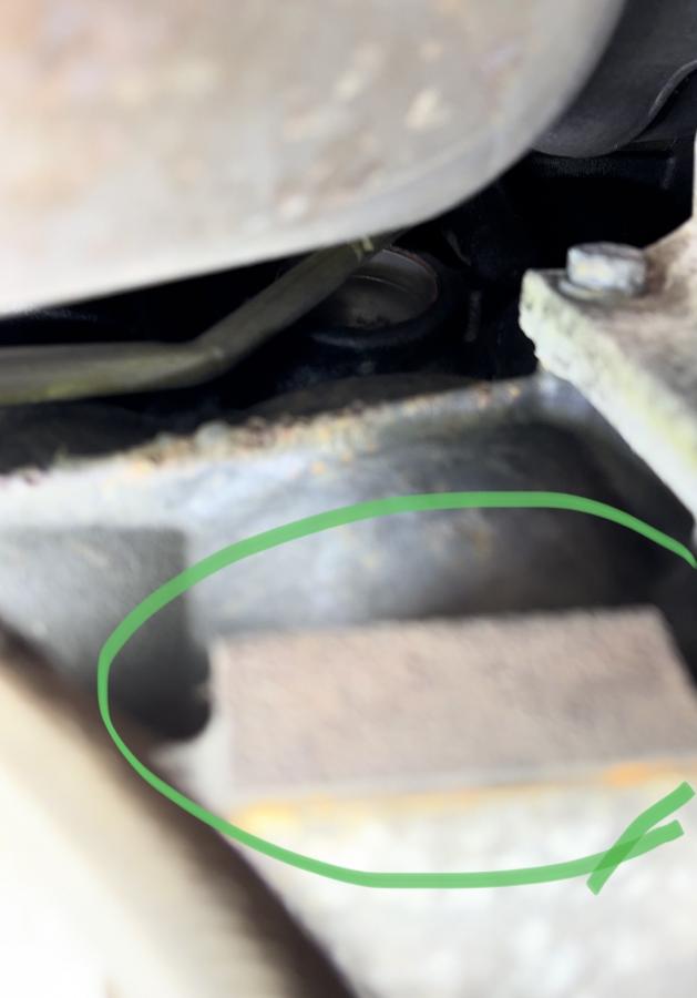

              This is great insight - For the hell of it I just looked through some videos I had when under my car last and it seems that this plate is rusted completely, and looks to be flat. So no numbers on it. It was a new england car for it's entire life so I'm not surprised but this, but the fact that the plate is flat, with no numbers has me a bit suspicious now. Have you ever heard of that happening? Is there another place with this number on it besides this location?
              Perhaps my video is just producing a not so clear image, but from the looks of it, it seems flat. Next time I'm under there I'll inspect it better, but thought to ask out of curiosity
              Pic for reference -

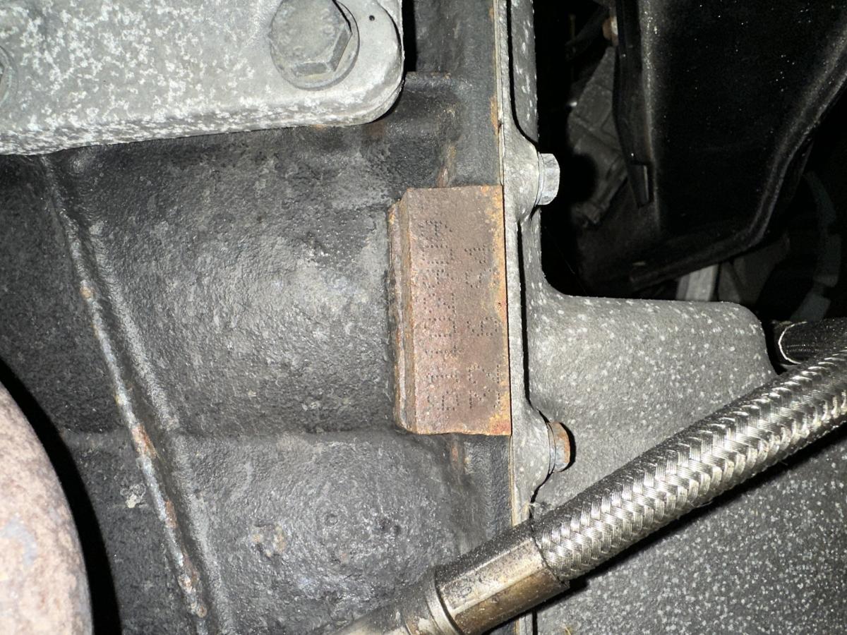

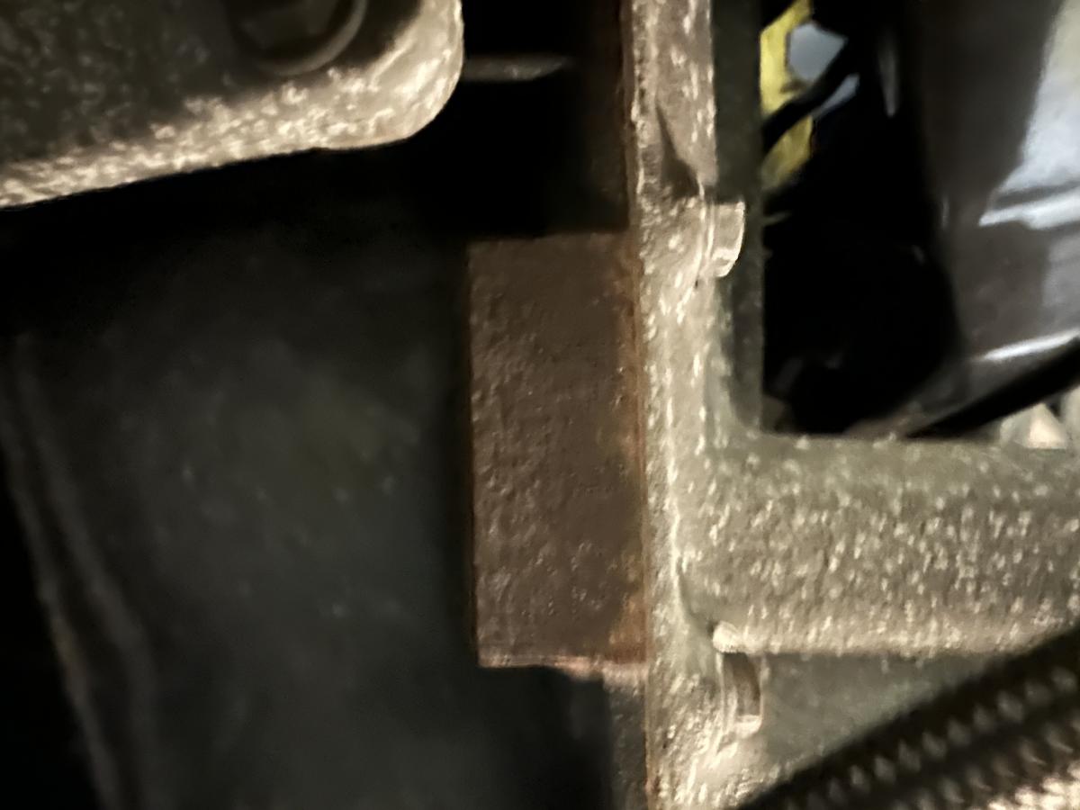

                You need to look straight onto it with a light.
                Mine looked similar and rusted from an angle

                But when properly inspected the numbers are still there

                    Got it! Thank you for those example images, yeah that's exactly what's going on. I'll take a look with a light next time. Thank you!!
