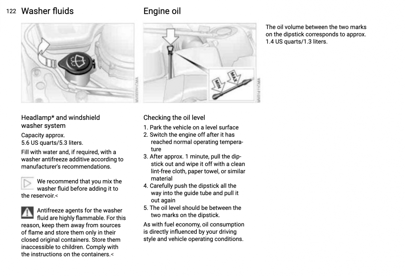

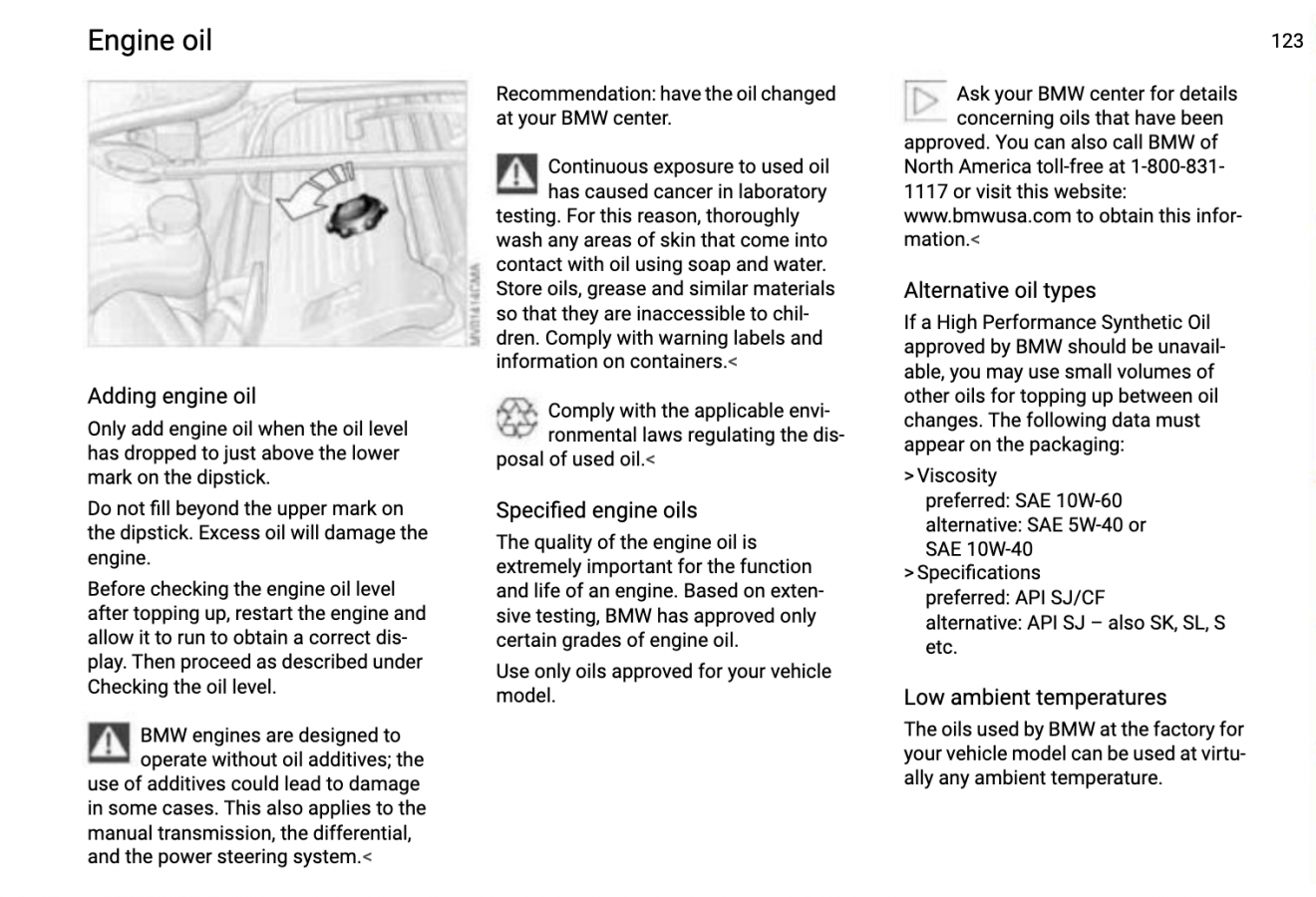

                        but as for the original issue, can anyone confirm that reading the oil level after 1 minute of shut down should actually read within the min and max on dip stick?
                        i’ve always taken my readings on cold motors, and this hasn’t been an issue in the past prior to the rebuild so im concerned that something could’ve gone wrong along the way.
                          It might be worth asking Lang since you bought some parts from them.
                            Yes, from the owner's manual:
                            Click image for larger version  Name:	Screenshot 2023-04-20 at 10.34.56 AM.png Views:	0 Size:	702.3 KB ID:	214613
                            Click image for larger version  Name:	Screenshot 2023-04-20 at 10.36.39 AM.png Views:	0 Size:	715.4 KB ID:	214615
