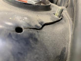

    This is what GC camber plates did to my strut towers after about a year.
    I installed the reinforcement plates and it hasn't gotten worse since then, been over 10 years now.
    I just ordered this to reinforce the strut tower and I'm gonna put a strut brace on top as wwll

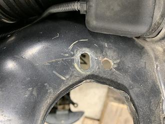

    These are both '00 model tourings, one was on Bilsten PSS with stock Non-M strut mounts (same surface area roughly as the camber plates) and the other was on ASTs with M3 camber plates.
    I think I have a set of stock, non-m, vorshlag, GC and TMS plates here I'll see if I can lay them all out for a pic.
    Click image for larger version Name:	IMG_1522.jpg Views:	0 Size:	133.6 KB ID:	215894
    Click image for larger version Name:	IMG_1373.jpg Views:	0 Size:	77.9 KB ID:	215895
    Yikes, those are scary pics.
    Please take that pic, I am super interested!

    Do your GC plates have the stainless steel reinforcement ring pictured above?
    What suspension and ride height are you running?
    I have the full GC Sport/street kit and it does have those metal rings. I'm lowered by abiut an inch vs stock height.
    The outline on the shock towers was from the outer edges of those metal rings
