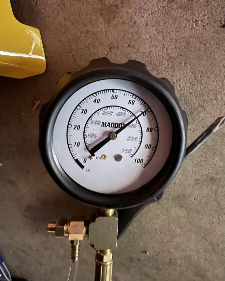

    Following this, I wondered if my Hella pump was a bad unit, but needed to confirm by doing some other things. So I replaced the fuel filter and fuel pressure regulator, and I also cleaned the ITBs, ICV, and MAF sensor. Started the car and the symptoms remained. So, I hooked up a pressure gauge to the FPR housing to get some readings. Pressure with pump primed is about 69 PSI, 4.75 bar (pic attached). Here's a video of a startup: pressure seems to waver between 4.5-5 bar, and strangely (?) eventually settles at 4.5 bar. I did a few different attempts and got mixed results, but this was fairly representative of what I'm seeing.
