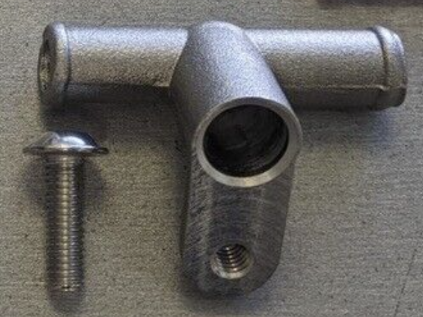

Going stock: how to restore the hose that the CSL MAP sensor T-adapter connects to?
    If going back to to stock, how do you restore the hose?
    Is there a part number to replace the hose or is there a 2-way adapter to reconnect it?
    Click image for larger version  Name:	T-adapter.png Views:	0 Size:	425.7 KB ID:	217004
    You should be able to find a plastic or metal barbed coupler that will replace the T adapter and reconnect the rubber line. Or the original part number is 11617836745​ or pre 09/2002 - 11617831663.

      But dang, the replacement part is almost $300 from ECS. Would have to think hard now about cutting it.

        Why are you going back to stock?
          Actually haven't installed yet, but if I ever want to sell the car, I don't want the car to show signs of irreversible modding.
            Just for research.
            You could probably grab the non-M piece and cut to length / attach that to the venturi doohickeys the M3 piece comes with. https://www.ecstuning.com/b-genuine-...e/34336751108/
