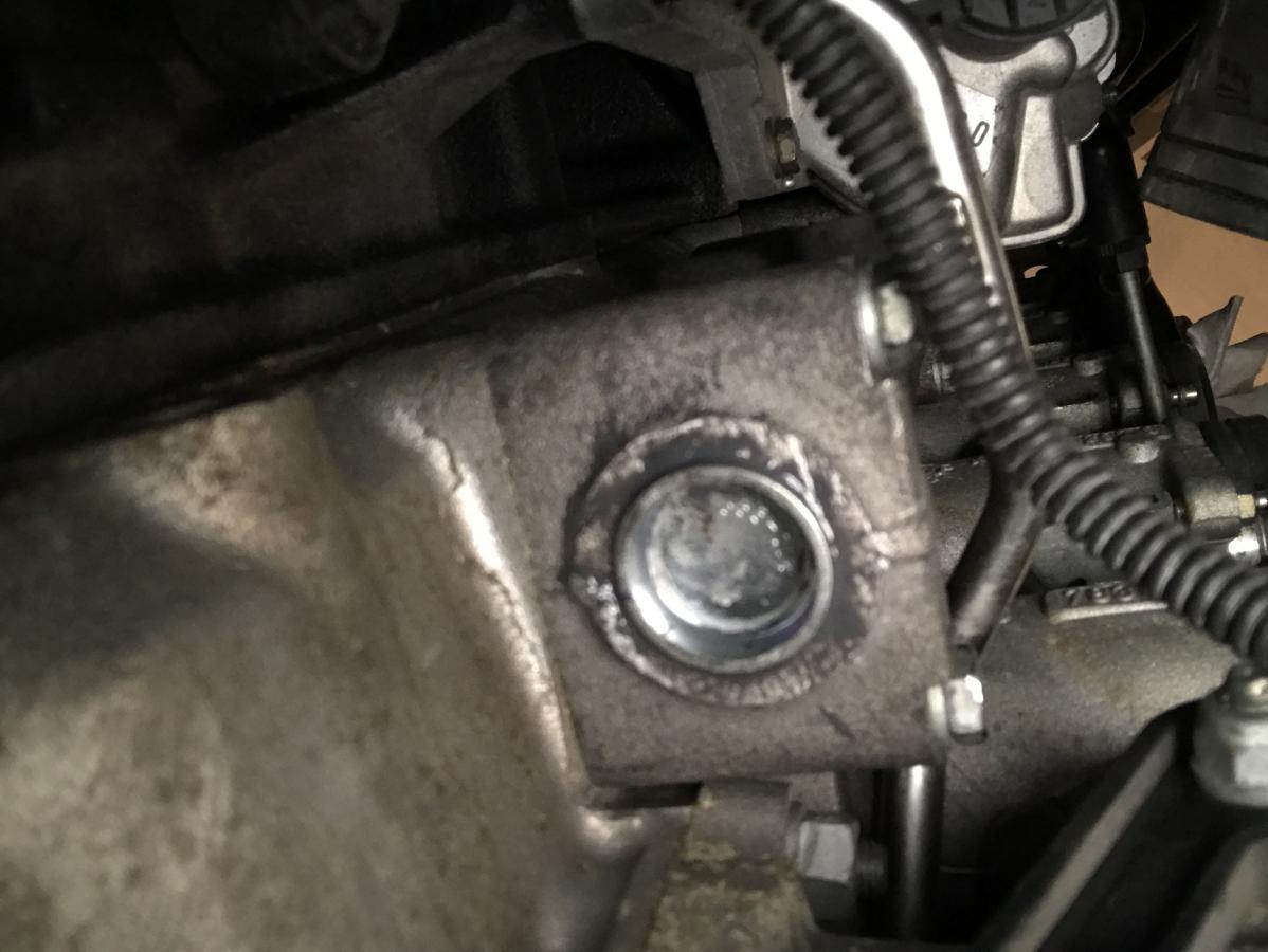

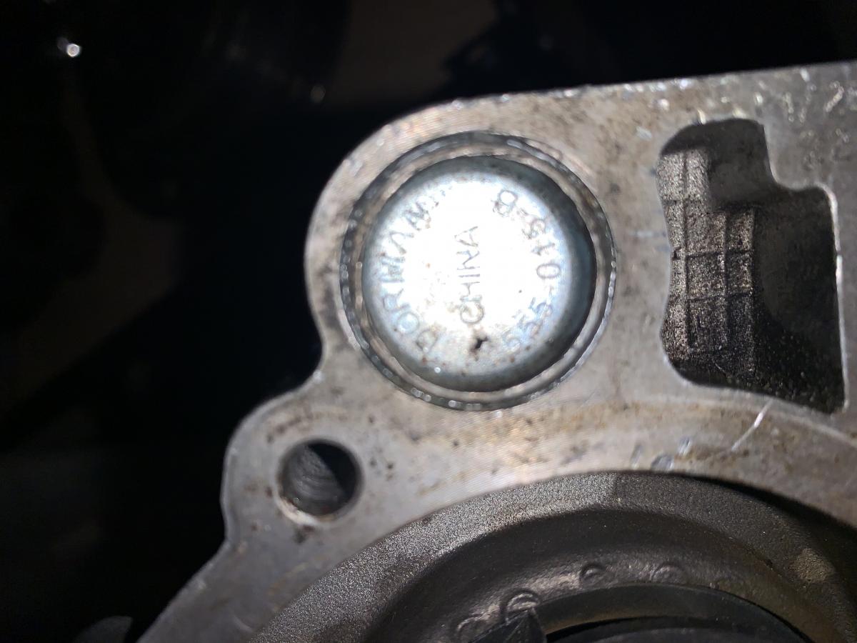

    BimmerWorld heater core delete kit (https://www.bimmerworld.com/BimmerWorld-S54-Heater-Core...) which caps of pipe 7 and includes a block off plate for the rear of the water pump getting rid of the 10 line. Seated the rear water pump freeze plug with RTV using the appropriate sized socket and a hammer.
      I used JB weld on the freeze plug. Also reamed out the end of the pipe and JB welded (high temp stuff) a freeze plug in there.
      $2 from O’Reilly’s.
      I couldn’t find an aluminum plug…would have TIG’d a couple of tacks instead of using JB weld.
        $2 from O'Reilly's.
        I couldn't find an aluminum plug…would have TIG'd a couple of tacks instead of using JB weld.
